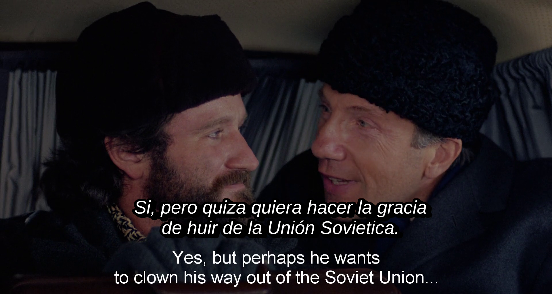

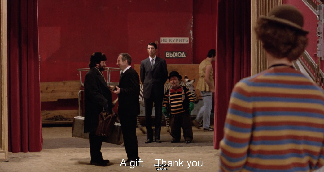

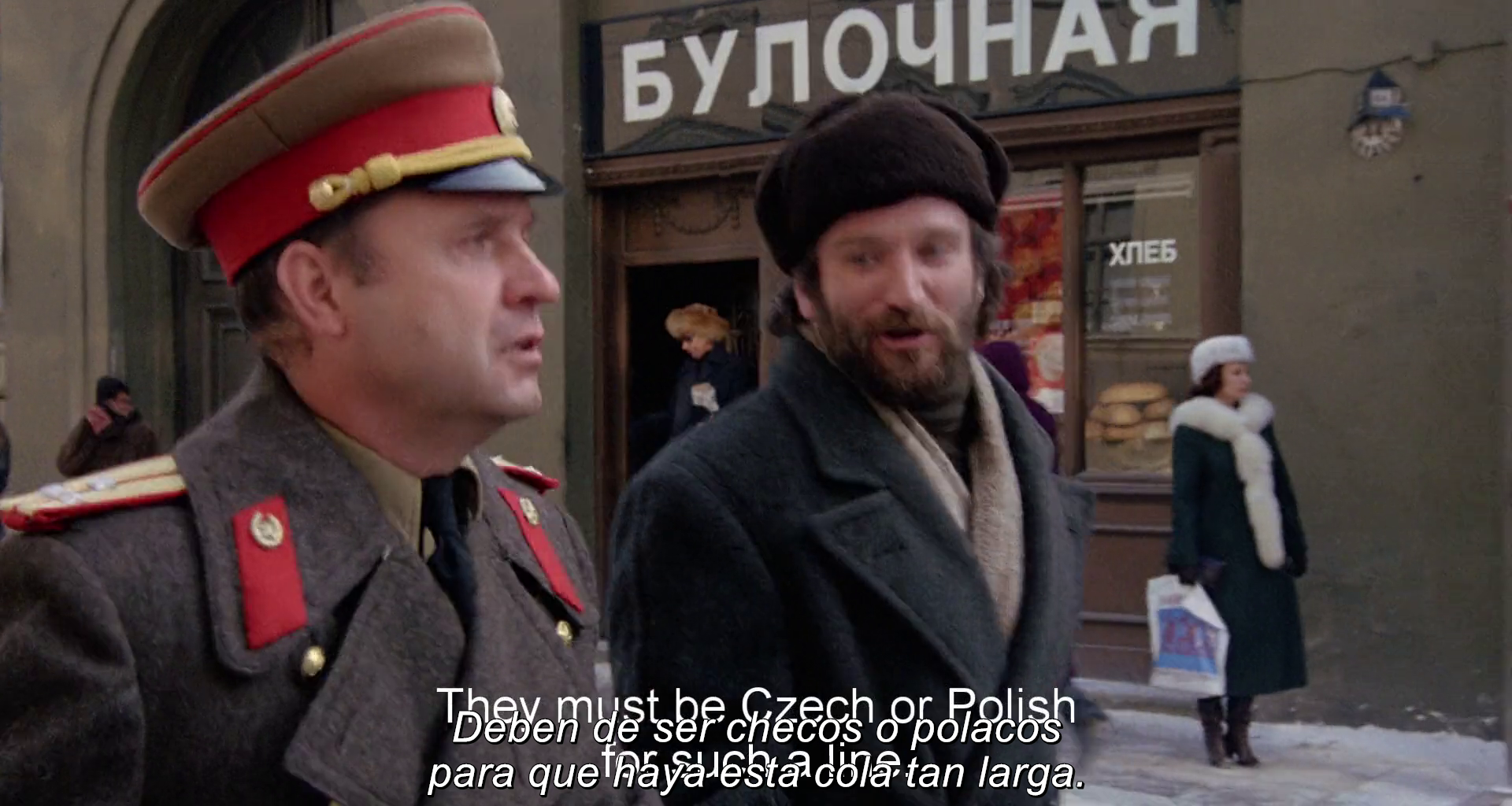

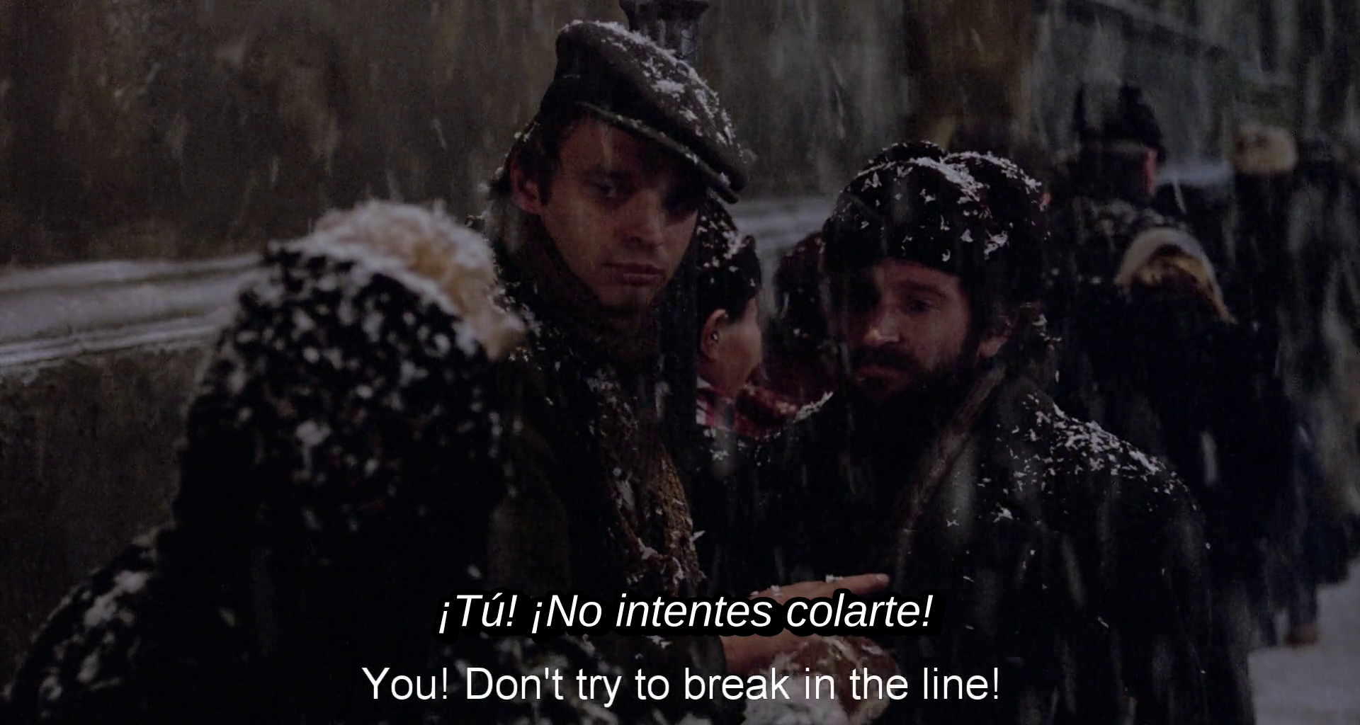

I tried to mux a .sub on an .mkv file (original file was an MP4) but the results are comically small (when compared to the hardcoded ones):
[Attachment 82431 - Click to enlarge]
[Attachment 82432 - Click to enlarge]

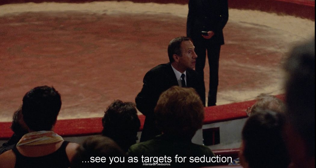

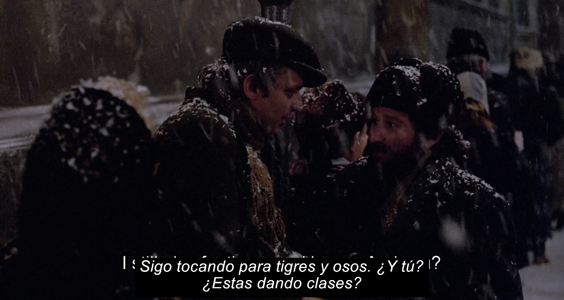

That's how it looks on my Panasonic TV, and on SMPlayer. On VLC, it looks as it is supposed to:
[Attachment 82434 - Click to enlarge]
[Attachment 82435 - Click to enlarge]

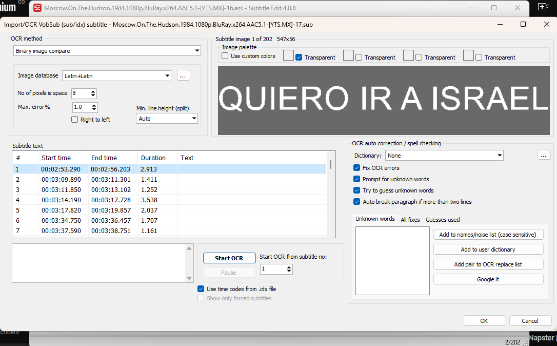

I converted and edited the original .srt file with Aegis into an .ssa file, which I converted later (using Subtitle Edit) to the .sup file I used on the muxing process with Mkvmerge.

Your resulting SUP-file indeed seems rather small, in relation to its runtime. Have you tried setting a larger font size in the export window?
In mkvtoolnix turn off zlib let Compression = No extra compression, increase the font size

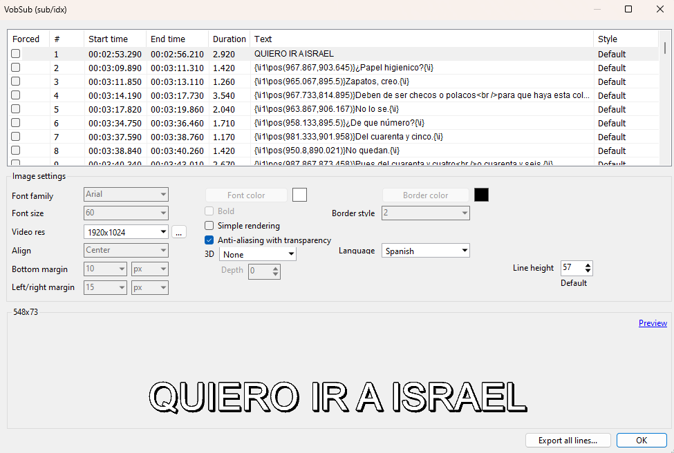

I've already adjusted it using Subtitle Edit:
[Attachment 82537 - Click to enlarge]
The issue is not so much the resolution, but the position of the subtitle on the screen. Subtitle Edit can export and edit .sub files to some degree, but seems unable to edit the position of the subtitle.

That is not what your export screenshot would suggest, which is set to VobSub export?
Anyways, maybe the uncommon resolution of 1920x1024 causes an issue. Try setting videoresolution to 1920x1080 and increase the ASS style's bottom offset (now 10). -

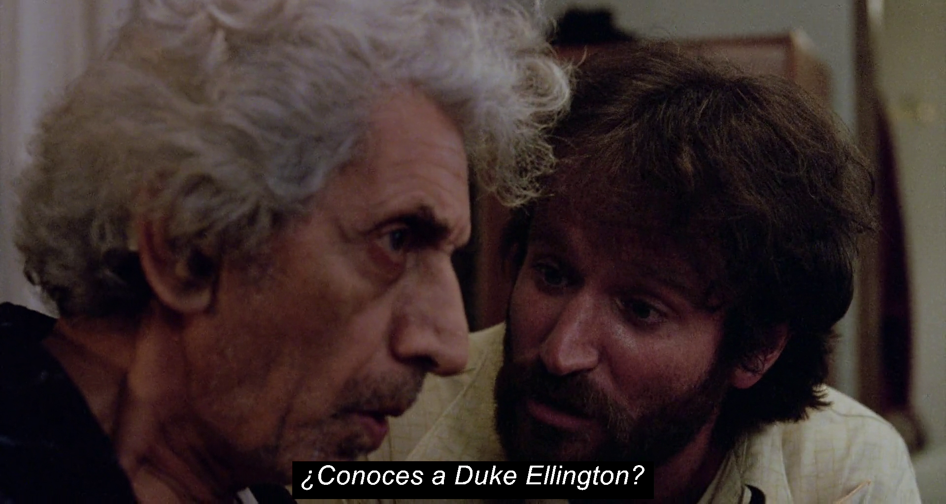

That was indeed a sub. transfer, but the .sup transfer in Subtitle Edit produces the same result. The 1920x1024 resolution is the resolution of the video to be subtitled (the one shown in the screenshots).
In any case, the solution I've found was to use a black boxed background, in the manner of closed captions. It was not the most elegant solution, but it turned out to be the most effective.
