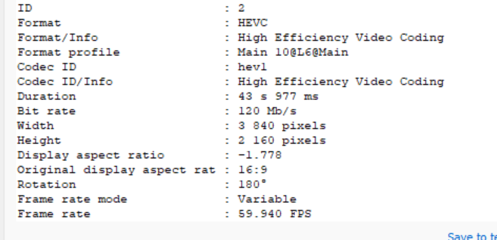

  1. So,long story short - trimmed my go pro video with VLC and when played on PC video is good.
    When uploading to YT it ends up flipped.
    I can only assume it has something to do with the camera being flipped when original was recorded, at the same time go pro has auto-rotate and
    this does not affect video at all in the end.
    Tried converting into different formats again, with VLC - to no avail.
    I am not that deep into editing software but it would seem there is no way to edit meta data, I was able to identify the probable cause with this app MediaInfo, where I found the ROTATE line with 180 next to it as seen in my attachment.
    edit: adding yt link for more clarity
    Any help would be greatly appreciated
    Cheers

  11. Originally Posted by twinax View Post
    I was able to find a way via VLC's convert feature to enable a vert flip filter and transform the files into a result which was flipped when played on PC, but on YT it would upload great.
    Note that a vertical flip is not the same as a 180 degree rotation -- you'll be left with a mirror image. A vertical flip plus a horizontal flip is the same as a 180 degree rotation.
    It looks to me like your video's metadata is already flagged for a 180 degree rotation. The problem is that Youtube is ignoring the flag. If that's the case you need to rotate the video 180 degrees and re-encode. You can use a program like AviDemux to do that (the program does a lot more than the name implies).

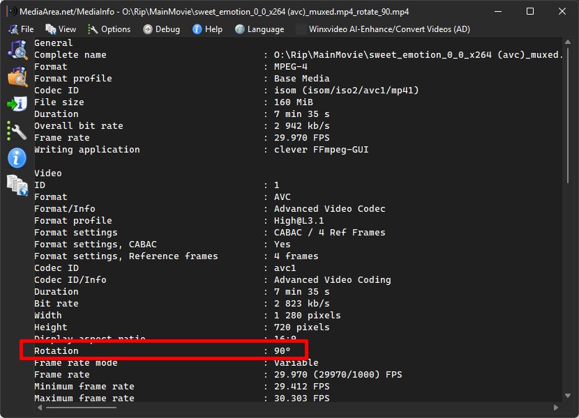

  13. @cholla
    have taken the file sweet_emotion_0_0_x264 (avc)_muxed.mp4.
    Main, various, rotate, rotate 90°.
    Result as aspected.
    [Attachment 82398 - Click to enlarge]
    [Attachment 82399 - Click to enlarge]
    played with VLC, info from mediainfo.

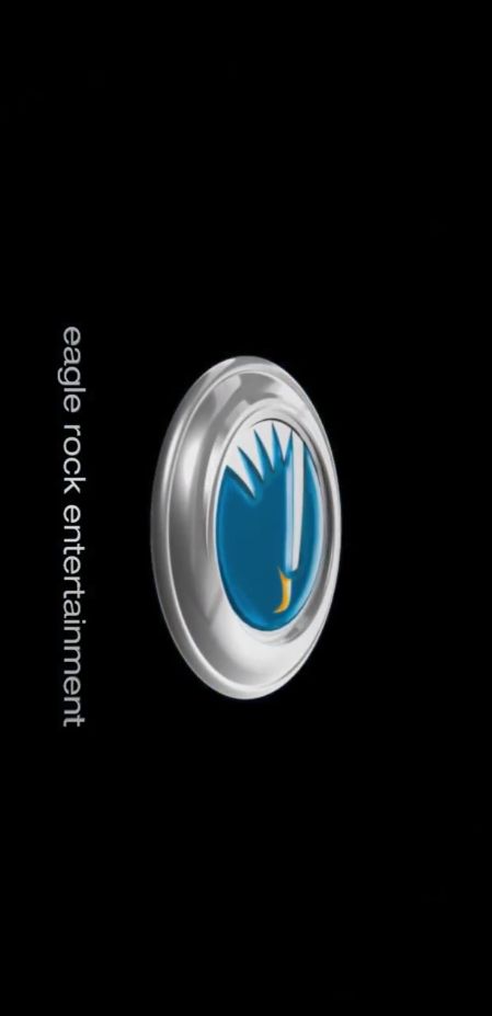

  14. @ProWo,
    I figured out what I was doing incorrectly.
    I was clearing out the 90 with backspace & putting in the 180 by typing it.
    I did not test the up/down arrows & thought they would be one number at a time.

    All right, attaching one small file to play with.

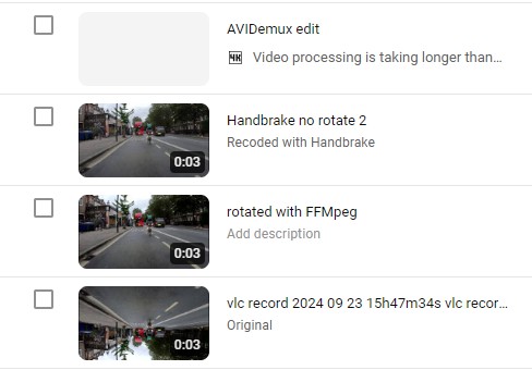

  24. Member
    May 2005
    Australia-PAL Land
    Did some uploads to YT:
    [Attachment 82436 - Click to enlarge]
    FFMPEG (no recoding) OK
    Handbrake (recoding) OK
    AVIDemux (no recoding) produced a possibly corrupted file that is still being processed by YT.
