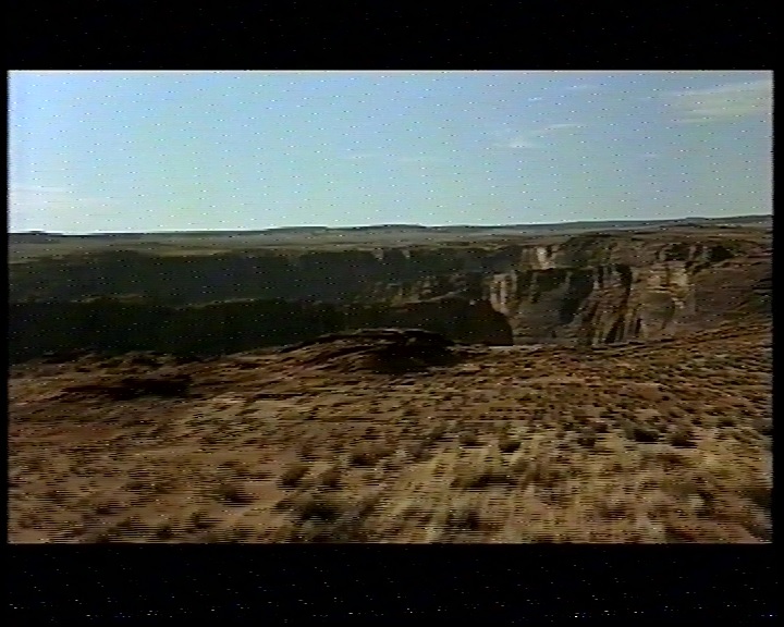

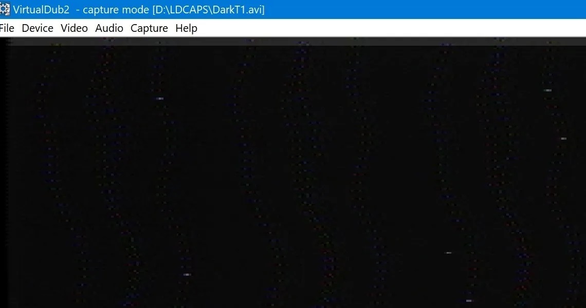

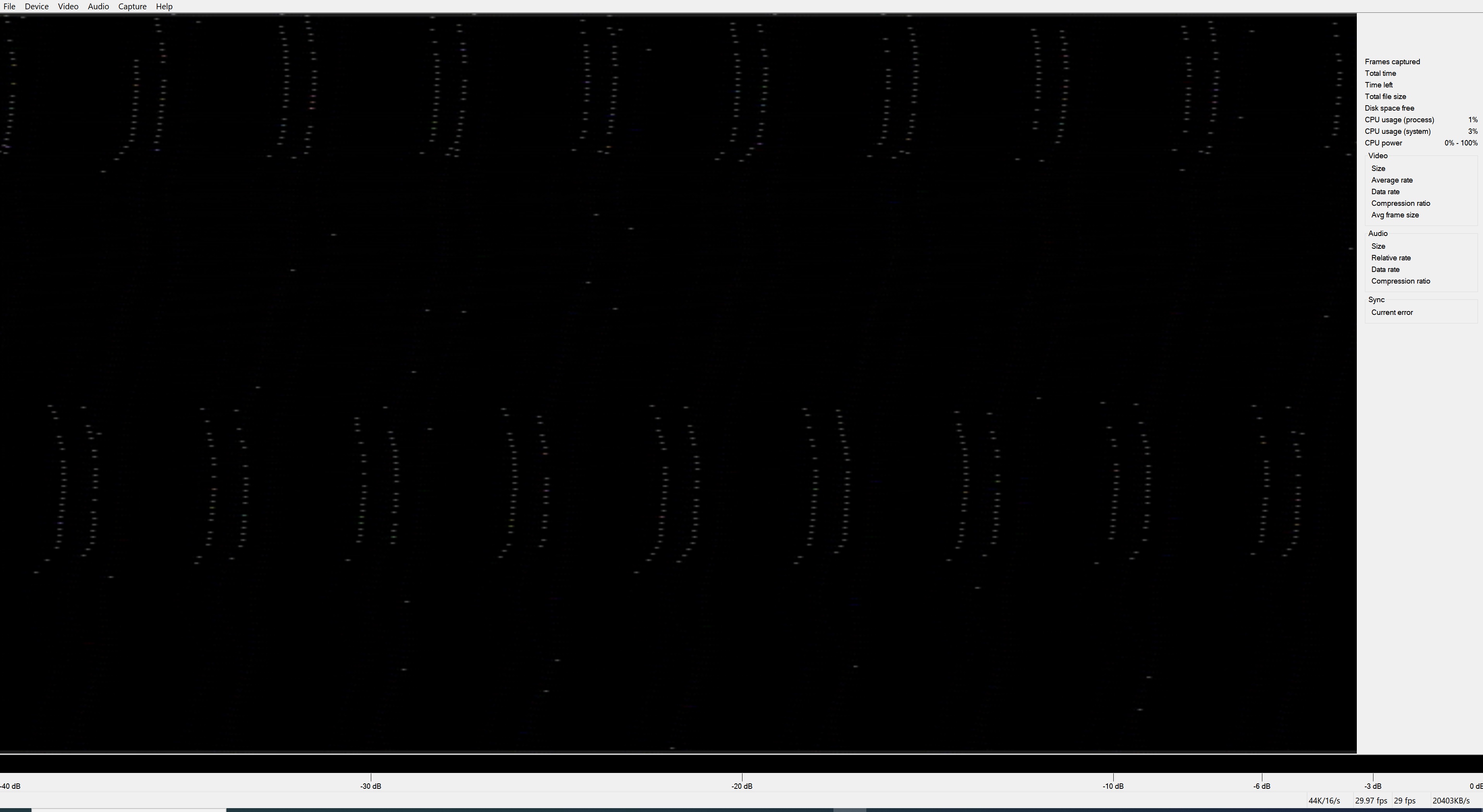

    Attached pics and vid are ANY connection, either VHS or LD input!.
    You can still see the interference w/ the TBC, its not pure black. there's movement.
    I changed cap cards, and from desktop to laptop, and changed outlets to a different room.
    Its still the same.
    If its BOTH the VHS player and the Laserdisc player, and ANY cap card.. its not those devices, its the house, imo?
    I just need to know WHAT in the house is causing it.
    I relocated to a different room, everything off (lights, utils, etc.), using a different laptop, and cap card.
    Same interference.
    I'm concerned its a whole-house ground loop or bad wiring or something.
    Any ideas? Anyone recognize this pattern?

    Vid is w/ TBC on. You can still see movement, interference.

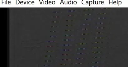

    Any OG Cap artists know wtf this noise interference is? I've got everything through AVR Sinewave UPS (for dirty power).. LD or VHS, changed rooms, cap cards, between laptop/desktop, turned all powered devices off.. its all the same. What the hell is doing this?

  3. I have a similar problem with a vcr, i couldn't track down the root cause yet (could be the head drum but i doubt) maybe a filter for high frequencies in the power supply i'm thinking
    Edit:
    Actually the pattern on yours i believe i've seen before. You may want to check all the ribbon cables ( check if all contacts are in good shape not sideways and of course well inside their slots). Good luck
