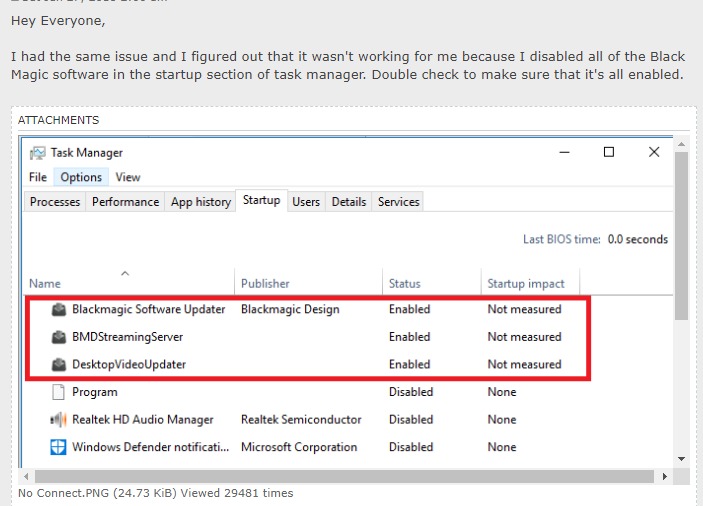

I have the startup services enabled in task manager as indicated in the photo attached below, although the "Blackmagic Software Updater" option never appears, whether it recognizes the board or not.

[Attachment 82283 - Click to enlarge]
[Attachment 82284 - Click to enlarge]
