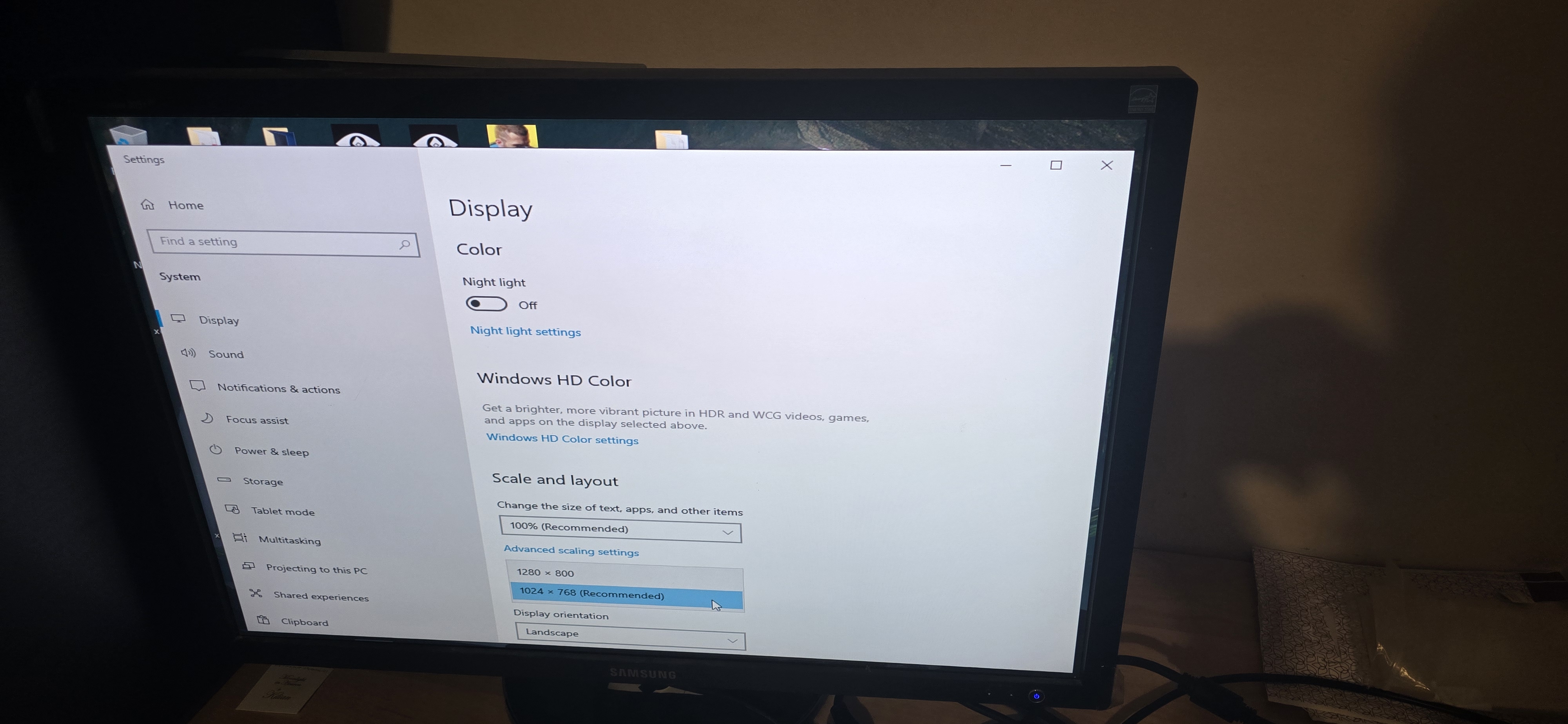

  1. I have this old Samsung Monitor that supports up to 2K resolutions (2560x1600) but signal input is only from DVI-D.
    [Attachment 82240 - Click to enlarge]
    [Attachment 82241 - Click to enlarge]

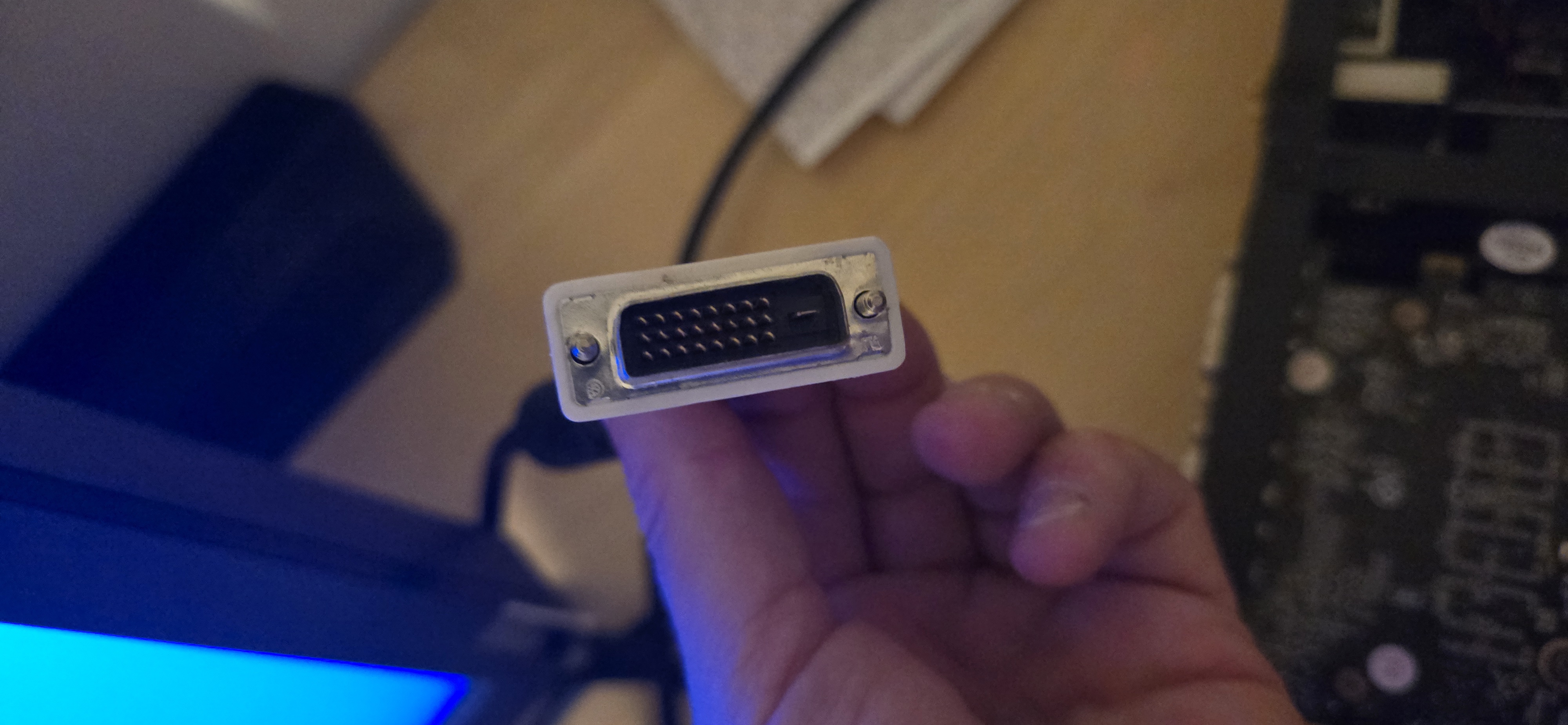

    I used to have it connected on a computer I Build more than 10 years ago. Now I tried connecting it to a newer computer with GTX480 ON Windows 10 and it only displays up to 1280x800. Of course I'm using a Dvi Dual Link cable the same I was using on my old PC and was getting the full 2560x1600 resolution with gtx480. The only difference I understand must be Windows. Back then I Was on Win7 now I'm on Win10. I don't see any drivers on Samsung site or anywhere else for that matter. Any ideas on what to do? It's a shame to let this monitor go to waste...

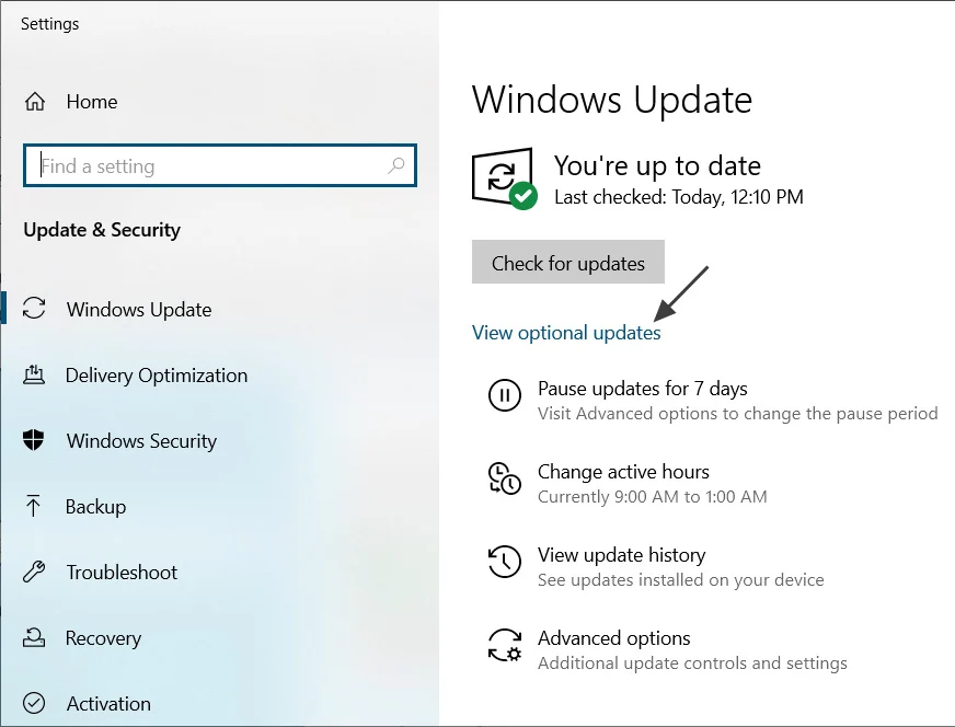

    Then check for additional driver updates here:
    [Attachment 82247 - Click to enlarge]
