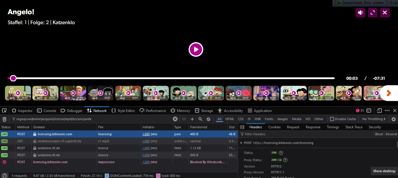

    i can now get the keys with the extension you provided early and it is working fine, but i still do not understand how to get the ( cURL of license server request) "Copy as cURL (Posix)" in the video i mentioned ealry (Katzenklo), i know this has no relation with the extension , and i read how to get license and i do every step right but still i get erros , i know how to copy it from site , but when i copy it, for example with the video i mentioned early,
    i get this
    curl 'https://widevine.rtl.de/license/license' --compressed -X POST -H 'User-Agent: Mozilla/5.0 (Windows NT 10.0; Win64; x64; rv:133.0) Gecko/20100101 Firefox/133.0' -H 'Accept: */*' -H 'Accept-Language: en-US,en;q=0.5' -H 'Accept-Encoding: gzip, deflate, br, zstd' -H 'Origin: https://www.toggo.de' -H 'Connection: keep-alive' -H 'Referer: https://www.toggo.de/' -H 'Sec-Fetch-Dest: empty' -H 'Sec-Fetch-Mode: cors' -H 'Sec-Fetch-Site: cross-site' -H 'DNT: 1' -H 'Sec-GPC: 1' --data-raw $'\x08\x04'
    and when i press on response on dev tools i get this
     4 }L* ? S}L* ? S (8@HV+Io>Np(@JzY¾B̽K3_X/d])}}aN|B^$1L<G<O/Wk Z 4C0 Yzl3Q#qRvw ;$m@?ˮ6O (2* B kc16Gv bSD 8P ;a[[pֶҤ0gv2)"uلi-~\YMR O7xtOlT.*&UGeyd5YL}YMA$Nou/8%^wB5KoPF~s{B 1:3 119.0.8 Built on Oct 10 2024 10:56:16 (1728582976)@JGvvh>P@wUfw$/VA=_ddLӲX
    and the same for the other license in the same video , there are 3 , i cannot tell the difference between the 3 licenses, but i tried all of them and they didnot work.
    My question is : how to get the correct cURL of license server request , why when i copy paste it , it doesn't work , when i post it on cdrm site or AllHellGui they keep giving me errors ? what i am doing wrong ?
    sorry for being annoying, My lack of knowledge on this matter, and my poor English, i do appreciate your help and your time , iam serarching the forum for more knowledge about this topic but still didnot figure it out so far

  7. Of the license requests the one that matters is usually the last one, but which one you take doesn't really matter. (Except: the very first one on toggo.de - "licensing" - does something different; don't know what exactly). Of the two requests to widevine.rtl.de/license/license the first one requests a certificate which the browser then uses to encrypt the data for the second request (if I understood correctly). The first request is not really necessary and not enforced. The second request asks for the decryption keys.
    AllHellGui doesn't use the first request either, and inn fact can work with both requests, because the payload (the browser's license request data encrypted with the CDM certificate) is exchanged by AllHellGui anyway by data generated with the CDM you told AllHellGui to use.
    I hope that is comprehensible?
