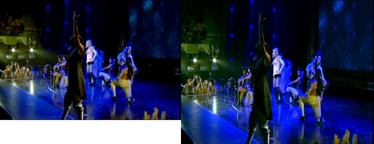

    I know I've sent this file before, and it makes me embarrassed. But now the problem with the file is different. Can anyone help me if there's any way to convert the video colors to this result? I tried for a long time using several filters in Vegas, mainly the ''Channel Blend'', but I didn't get the same result (I'll attach a video comparing the two, mine on the right has blown out the blues and you can notice a greenish shading on the colors, while the one on the left has more vibrant light tones, and more regulated colors.) I would like to know what software they used to get this color result, maybe some script with Avisynth?
    Thanks to anyone who can help with this mission.
    - Attached is the original video without color changes, and the video with the final color change in which I aim to achieve the goal.
  2. Here is a picture of the frame and video comparing my bad result (frame on the right)

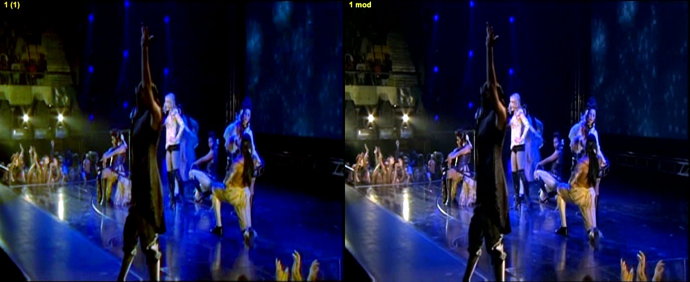

  5. Here's a quick attempt with AviSynth.
    ColorYUV(gamma_y=60, off_y=-18)
    ConvertToRGB(matrix="PC.601").RGBAdjust(r=190.0/167.0, g=163.0/126.0, b=140.0/87.0).ConvertToYV12(matrix="PC.601")
    Tweak(sat=1.4)
    [Attachment 82239 - Click to enlarge]
    That's th he target video on left, the NTSC video modified on right (crudely resized for StackHorizontal).
