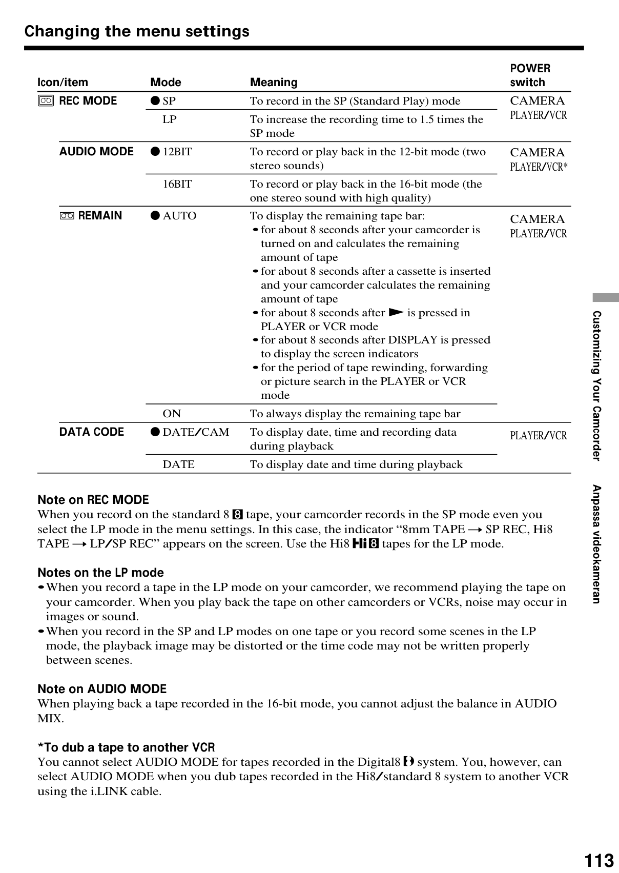

  23. Member The_Doman's Avatar
    Feb 2004
    Netherlands
    Originally Posted by timtape View Post
    I know the OP has problems with a menu select switch but it would still make sense to check the manual of the OP's camcorder to see if there are user options for different internal audio sample and bit conversion rates. The link below worked for me. I only saw options for selecting say stereo, left or right tracks. Didn't see anything about selecting sample or bit AD conversion rates.
    https://www.sony-asia.com/electronics/support/product/dcr-trv230e/manuals
    It is mentioned a few pages further in the manual.
    Works the same as my DCR-TRV120E.
    Annoyingly at the default/factory settings it is set to 32 kHz.
    So when your settings/cmos battery is empty, it will always fall back to that settings again.
    [Attachment 82266 - Click to enlarge]

  25. Member The_Doman's Avatar
    Feb 2004
    Netherlands
    Originally Posted by Bermuda1 View Post
    So do I understand correctly, that without getting the confirmation button fixed, no chance to get my camcorder to play back the tapes in 48khz mode?
    Well yes, if the confirmation/selection wheel-button is really doing nothing anymore?
    Then the analog tape playback/pass-through is set on 12bit/32kHz audio.
    Digital8 tapes of course will be played at original recorded audio mode.
