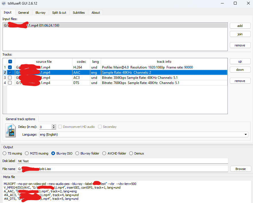

So I have the 1080p video as an MP4 with just the stereo file.
Seperately I have (from the DVD) a DTS file and a Dolby Digital file (or files - i.e. I have both the whole show and then individual tracks).
So as a simple test I pulled in one track from the MP4 and I had successfully added the DTS and DD audio using MP4Box and tried that.
I removed / unchecked the DD and DTS options and it spit out a file but it plays at around 10x speed with no sound.... as you can hopefully see from the screenshot... -

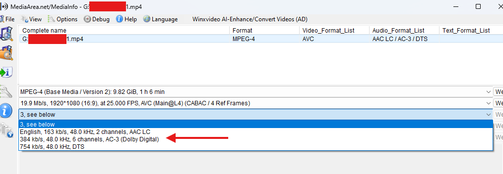

[Attachment 82210 - Click to enlarge]
So you see here what Media Info reports.... -

I noticed you selected AAC audio, but AAC is not a supported format for Blu-ray. You should convert AAC to AC3 instead.

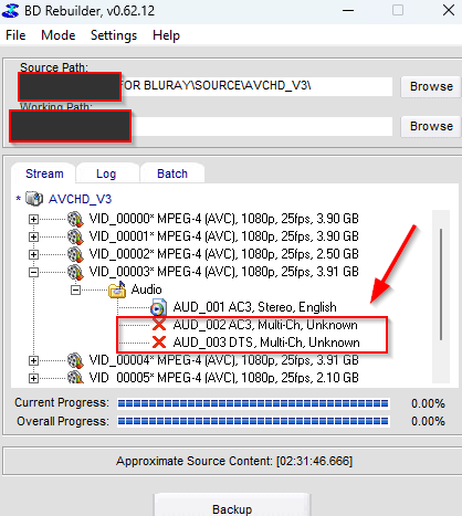

Ok - so I've had a lot of success on this - thanks for the pointers.
I did extract the Dolby Digital 5.1 and DTS tracks as ac3 and dts respectively and added those - they work really well on a completed blu-ray that plays fine on my PS5, PS4 and Sony 4k player.
Not a definitive test, but happy enough.
One strange thing - and I'm not sure this is an issue - but bdrb shows an x on the (from DVD) audio files, but again, the disk plays fine and my surround sound Yamaha amp shows Dolby Stereo, Dolby Digital 5.1 or Dolby DTS depending on what's selected (and plays them obviously)
[Attachment 82712 - Click to enlarge]
