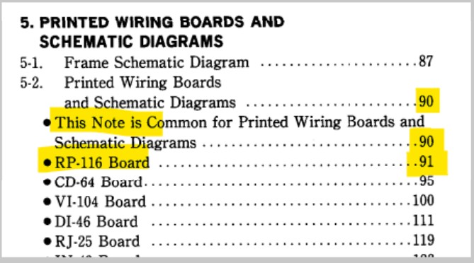

    Do someone has a service manual for Sony EV-S3000 which also contains schematics for the RP-116 head amp board?
    None of the manuals that I found online hasn't have that board. The pages are missing.
    I have a Sony EV-BS3000. According to the service manual for Sony EV-S3000, both machines are quite similar.
    The manual for Sony EV-BS3000 seems impossible to find.
    The machine that I have, has the following problems:
    - the electrolytic caps on power supply were leaking. The traces were heavily corroded. That problem I solved;
    - the SMD caps on RP-116 head amp board and on TBC board were leaking. Some of them were already detached from the board. Some traces were corroded. I replaced all with electrolytic and I checked for short circuits.
    If at the beginning, the machine had no image and sound at all, after replacing the capacitors, there is an image but totally unintelligible and the sound is intermittent (mostly without sound).
    Thank you!

    Thanks, but unfortunately, no. This manual is incomplete also.
    The pages from 90 to 94 are missing containing what I'm looking for, RP-116 head amp board.

    Thanks dellsam34, but this manual is not complete either.
    I found 3 scans of the manual on the internet, all being roughly similar. All of them has the same pages missing.
    Pages from 91 to 94, RP-116 head amp board and pages from 81 to 86, pin description of tuner/timer control.
    I will try what johnmeyer has said, maibe I can find a similar board between all the Sony models from that period.
