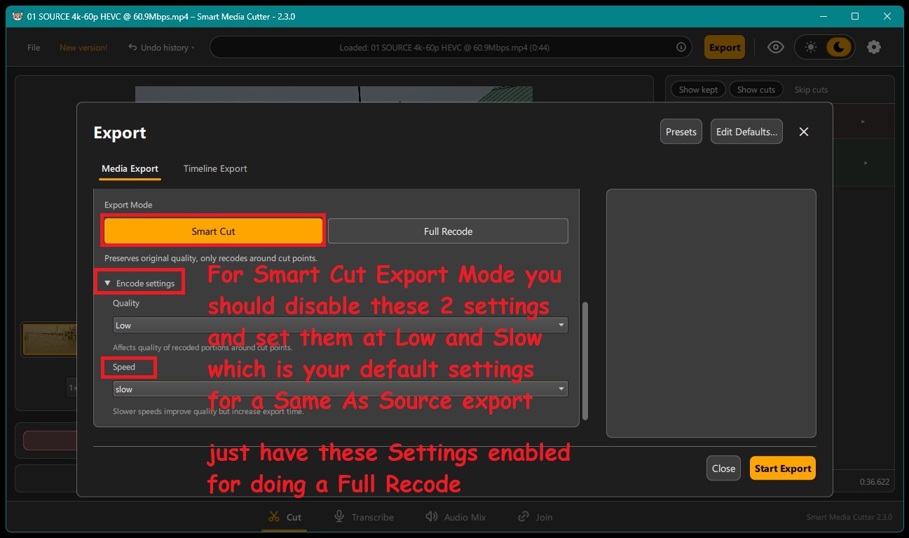

    Back again, will post this up in here and see if i can find out what might be going on with the Smart Cut Export Settings.
    I have been using SMC to do my Cuts in many files over the weekend, and used the Smart Cut export mode.
    Given that the Smart Cut mode exports your files to "Same As Source" without recoding, there is no need to have the Encode Quality and Speed Settings enabled in the Export box (see screenshot) as i noted in my exports that if i set the Encode settings to Default, the Smart Cut Quality is set to Low and Speed is set to Slow to get my files the same Bitrate as the Source file.
    I was testing the Full Recode feature for a while to try and export my 4k/60p HEVC files to AVC, i tried various export settings to but it would not work, so i went back to doing cute and exporting with the Smart Cut option, but i realized that the Encode Quality and Speed settings were still set to the AVC export settings, so my Smart Cut export file ended up having a higher bitrate than the Source file.
    This is when i realized that i need to reset the encoder settings to Default so the Smart Cut mode was reset to Low and Slow.
    I know this might not seem like a big deal, but the Smart Cut mode needs to be separated from the Full Recode section so there is no confusion about the settings.
    Anyway, no big deal, i just don't like having to reset the encoder settings to Default, or have to change the Quality and Speed back to Slow and Low manually if they have been changed.
    BTW, does the Full Recode Mode actually work yet, i have tried several recodes of my 4k HEVC files to AVC but they are not working.
    I did send you a screenshot of the Error, and you may aalready be looking into this.
    Cheers
    [Attachment 91948 - Click to enlarge]

    Hi Bridgy
    1. I think I found the issue that was blocking recoding to AVC. This will be fixed in v2.3.3, which should be out later today.
    2. Smartcut uses the encoder settings, but they only apply around the cut points (the small bridge segments between keyframes). The rest of
    the file is copied bit-for-bit from the source.
    A note on bitrate: SMC doesn't try to match the source bitrate. Re-encoding at the source's bitrate actually loses quality, since the encoder is working from already-compressed pixels, so it needs a higher bitrate than the original to preserve the same visual quality (this is called generation loss). With Default settings the bridge segments may end up at a higher bitrate than the surrounding copied stream, but that's there to keep the cut points looking as close to the original as possible. If you'd rather minimize file size at those points, lowering Quality and slowing the encoder both decrease the final file size.
    That said, I will probably eventually add an option to smartcut to preserve the source bitrate.
    v2.3.3 mostly just a bunch bugfixes. I'm hopeful that this version is going to be stable enough that I can take about 2 week break from new SMC releases.
    In early May I want to redesign the export UI. Then I can do things like separating the smartcut and fullrecode settings and add cleaner UI for choosing output codec and container, etc.

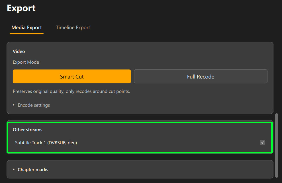

  17. Hi Santtu !!!!
    Take all the time you need. For the moment i only have two more feature suggestions in my mind: one as simple as smart it can be, and one.... very ambitious... (eheh)
    Sorry but i can't contain myself... i'll reveal the simple and smart: simply to add to the cutting final report/statistics, where the cutpoints (the conjunctions) between segments are located (using the output file timing) so in in playback mode i can quickly look at those points.
    For the ambitious one i'll wait......

    Originally Posted by skeskinen View Post
    2. Smartcut uses the encoder settings, but they only apply around the cut points (the small bridge segments between keyframes). The rest of the file is copied bit-for-bit from the source.
    Yes i understand that the file is recoded only at the cut points, but why are we left to decide which export quality and encoder speed to set if these settings only apply to the small recode at each cut point, isn't there a way of doing this automatically within the encoder itself, just like the way it is done in VRD, we don't need to set anything for the Intelligent Recode at each cut point, Dan created this to happen automatically based on reading the frames around the cut point.
    Apologies for the comparisons to VRD but i am merely using VRD as a reference.
    Well if that was possible for you to do then this would be great, because in VRD when you cut and join multiple parts together and use the Smart Render option (also known as "Same As Source") the exported file has the same video Bitrate as the Source file, which confirms that Dan Rosen was using his Intelligent Recode function to recode those frames the same as the Source file bitrate.
    In SMC i joined multiple segments cut from one of my 4k HEVC files and i tested 5 different settings to encode those frames around the joins and the overall Bitrate for each exported file was quite different to each.
    Keep up the great work, so far everything looks on track, unfortunately i can't test any TV broadcast files so others will need to offer you feedback for those.

    Have been interested in following Bridgy's "conversion" over to using SMC.
    As a long time user of VRD, I have always been saddened by the fact that it doesn't support subtitles (.srt), so editing / cutting video's that have sub's, you only get the video & audio.
    So my question is, does SMC "cut" any subtitles that are part of the source, so you get matching "cut's" of everything ?

  22. Originally Posted by burt123 View Post
    Why don't you test it yourself? Yes, SMC supports correctly both types of subtitles: text, and DVB. They are not displayed in the application, and may only be excluded from export like shown below.

  24. Originally Posted by burt123 View Post
    Cheers.
    Hi
    Yes, SMC cuts subtitles. SRT, SSA/ASS, mov_text, teletext, etc.
    Like noemi7 said, at this time there's no subtitle display in the preview video player, but that's probably coming at some time later.
    Another limitation is that the subs have to embedded in the video container. There's currently no way to load external .srt file and cut that together with the video. I need to add that feature to the near term TODO list.
  25. HI all, i can confirm SMC can properly cut DVB subtitles format embedded in a .TS container (for example a TV recording)
