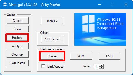

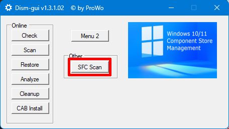

  11. I think your operating system is faulty.
    Run a system scan.
    Use my Dism GUI.
    https://files.videohelp.com/u/292773/Dism-gui.zip
    1) SFC scan
    If errors are found and corrected, then reboot and repeat the scan.
    [Attachment 82224 - Click to enlarge]
    2) If no more errors are found, click on Restore and then Online.
    [Attachment 82225 - Click to enlarge]
  12. Originally Posted by ProWo View Post

    Thanks for that. I ran that scan and it did detect errors which it managed to fix, so hopefully all is OK now.
