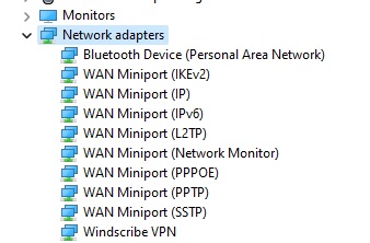

    Couldn't find the wifi adaptor in the list under Network adaptor:
    [Attachment 82116 - Click to enlarge]
    It could be hidden I suppose, but why?.
    If there is no WiFi device listed in the device manager, airplane buttons then won't work too of course.

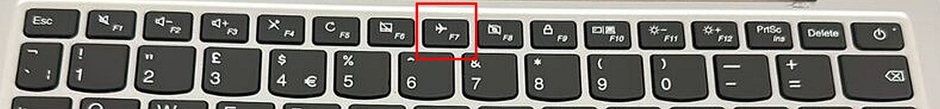

  3. This is the key to activate your Wifi.
    [Attachment 82148 - Click to enlarge]
  4. Originally Posted by ProWo View Post
    Tried that but doesn't work, it just turned off airplane or turns it on.

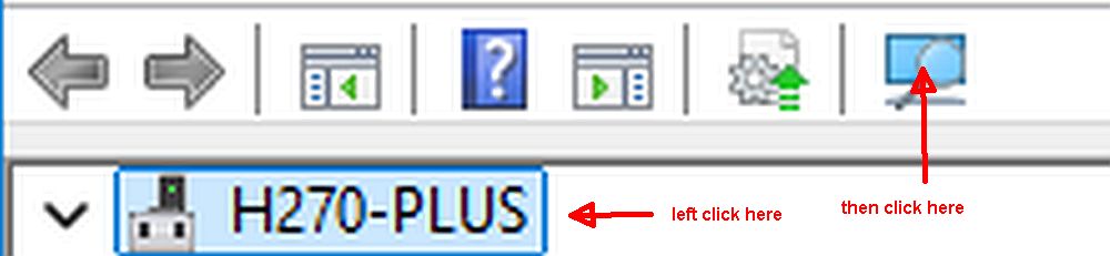

    Open device manager, left click on the top entry in the device list (should be your laptops name).
    Above appears a monitor icon (like a tv, on the right).
    Left click this icon.
    [Attachment 82164 - Click to enlarge]

    I clicked on the monitor icon at the top right in device manager but all it does is a very quicky scan, that's it. I must be doing something. I do wonder whether a VPN I have installed (Windscribe VPN) may be causing the problem.

    Yes on my machine there is an airplane symbol, but it doesn't turn on the wifi just turns on or turns off airplane mode.
  29. Originally Posted by techmot View Post
    According to the model specs, pressing F2 after powering ON after shutting down should get into the BIOS, but for some reason it's not doing this on my Lenovo, it just goes into the startup and log-in screen
    Press Fn+F2 together after powering on.
