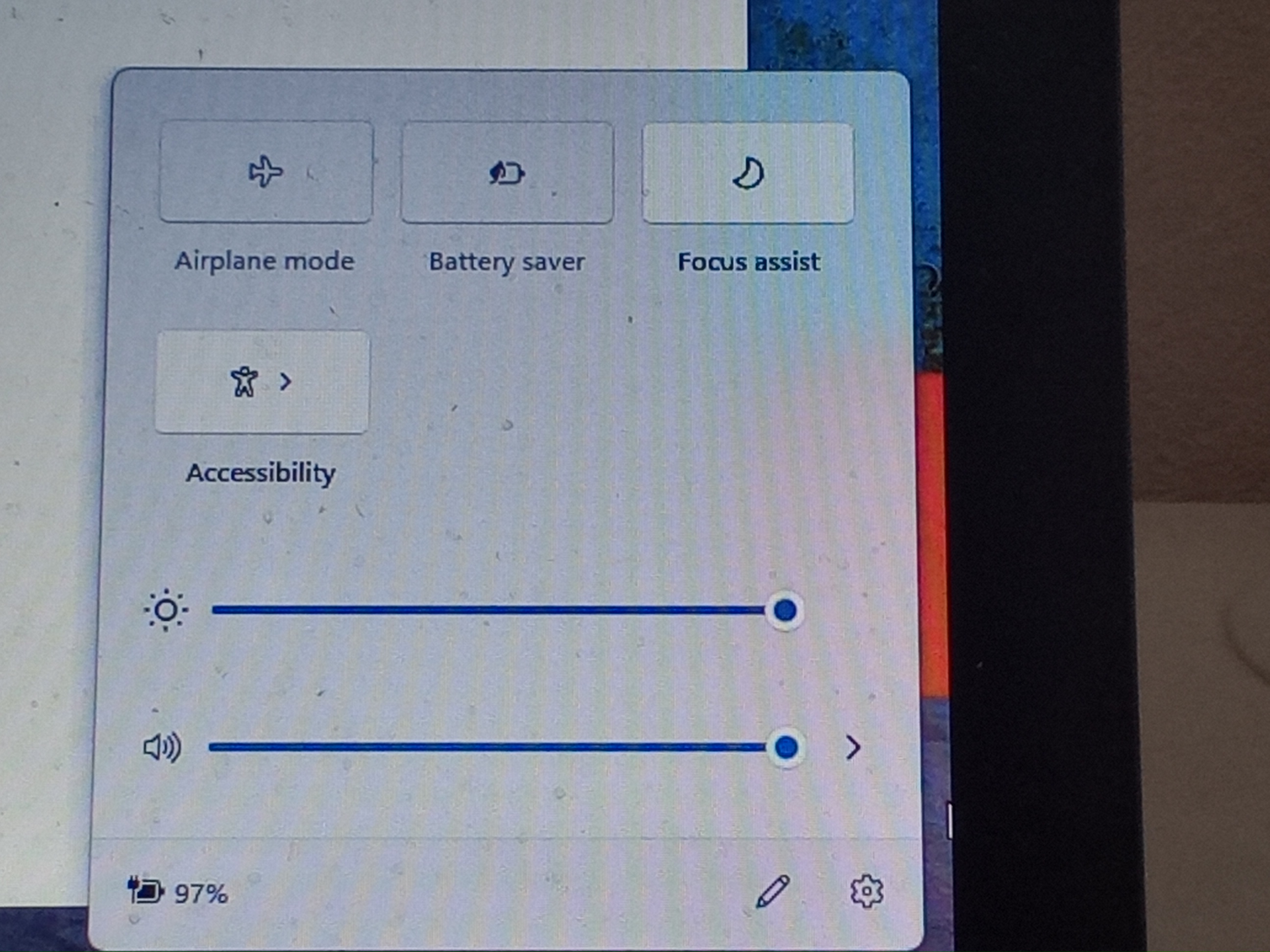

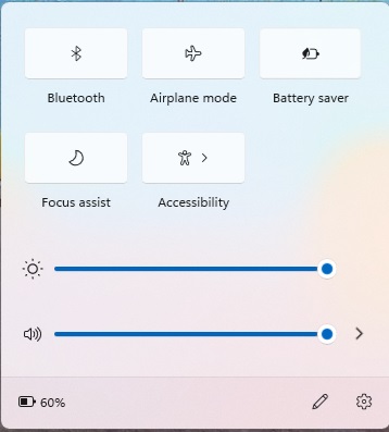

  1. Hi, can anyone help with a problem I'm having with the Internet on my Lenovo laptop running Windows 11. On the taskbar no WiFi is showing only plane mode which is greyed out. I've tried a few options but nothing I've tried will fix the problem. It was working two days ago after I shut down for the evening but the next morning I couldn't connect to WiFi. I've had the problem before but I was able to turn it back on again, however this time I can't.

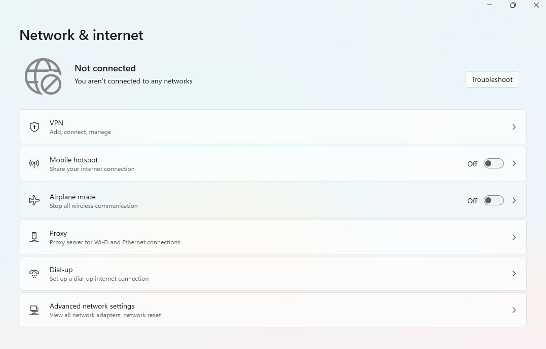

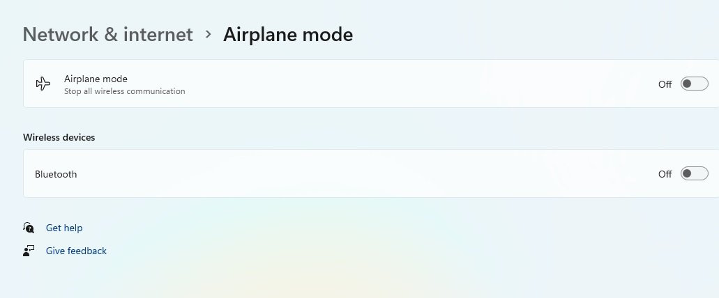

  11. Originally Posted by ProWo View Post
    I've tried those but still nothing:
    [Attachment 82119 - Click to enlarge]
  12. Click on Advanced Network Settings, Network Reset.
  13. Originally Posted by ProWo View Post
    Tried that but still nothing. Clicked on reset and rebooted but still nothing. It now shows bluetooth in the taskbar setting but no wifi.
    It says in the Network settings that my PC doesn't have a Ethernet, Wifi or cellular data connection.

  15. Originally Posted by ProWo View Post
    Could you post a picture from your laptop keyboard?
    I used the laptop to grap the screenhots then copied them over to my sons identical laptop where the wifi is working to upload them.

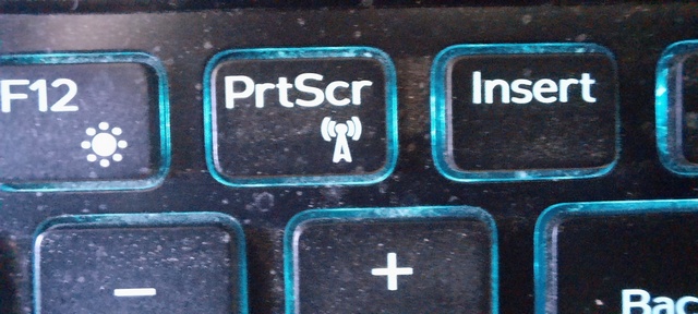

  24. Here's what the WiFi symbol looks like on my Dell laptop. Every laptop that I have ever owned had this symbol on some key somewhere on the keyboard.
    [Attachment 82141 - Click to enlarge]
    Extraordinary claims require extraordinary evidence -Carl Sagan
  25. Originally Posted by TreeTops View Post
    No that symbol is not on any key on my laptop.

  27. Here's a WiFi note referring to your model on Lenovo website:
    https://pcsupport.lenovo.com/us/en/products/laptops-and-netbooks/1-series/1-11igl05/81...reless-network
    Also on some Lenovo's the WiFi symbol on the keyboard is an airplane symbol.
