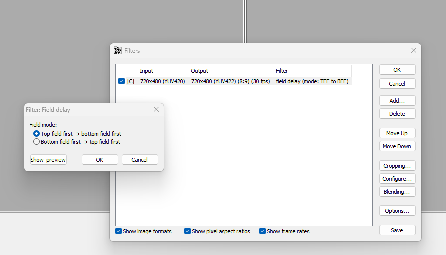

    Don't know. Didn't try long. Maybe several steps are needed, something like
    - separating the fields
    - deleting the first field
    - re-weaving
    There should be a better solution though......
    Edit:
    Based on above thoughts, here we go:
    [Attachment 82100 - Click to enlarge]
    Edit:
    or use ffmpeg:
    ffmpeg  -i "%~1" -vf fieldmatch=order=tff:mode=pc -c:a copy -c:v libx264 -preset medium -crf 20 "%~1_matched.mp4"
  9. @Alwyn: I edited post#8 for the Vdub solution. The filter is field delay.
