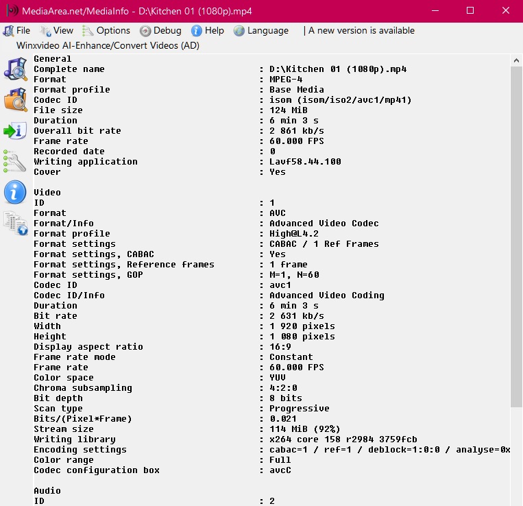

  2. Post a mediainfo report (text mode) from this video here.

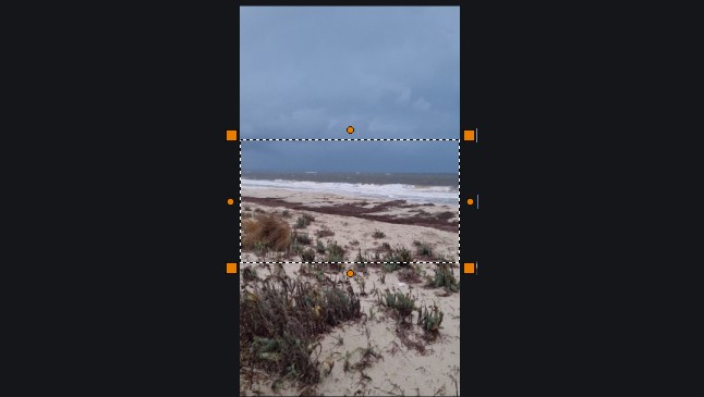

    AviDemux latest Nightly builds
    Is has a crop/mask filter you can easily adjust manually.
    Avidemux Crop filter:
    [Attachment 80851 - Click to enlarge]

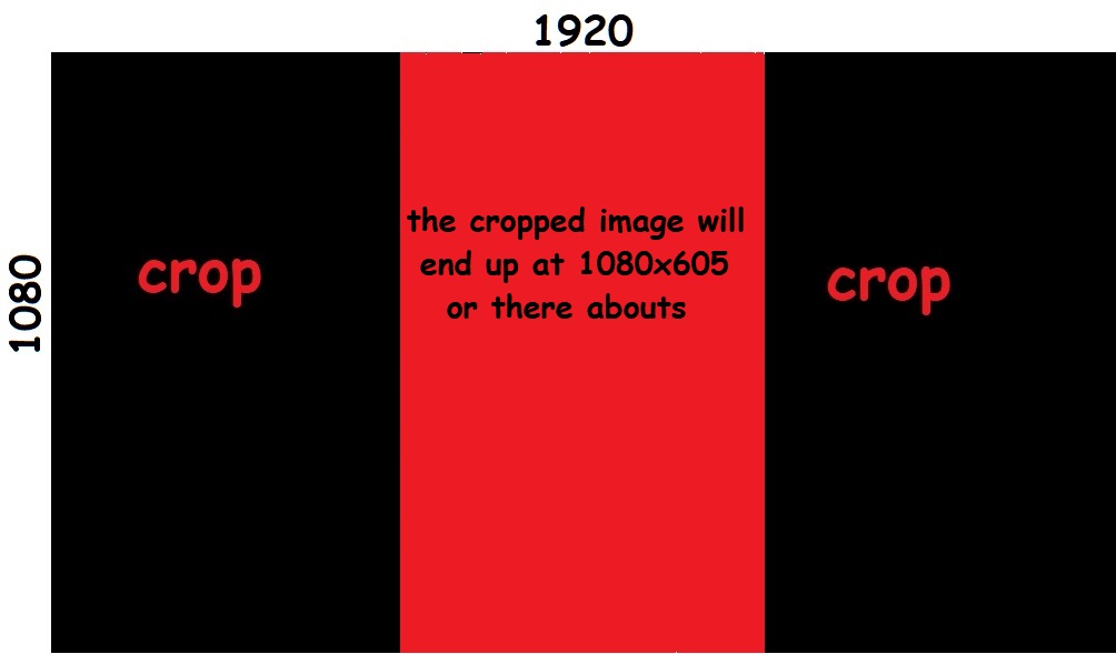

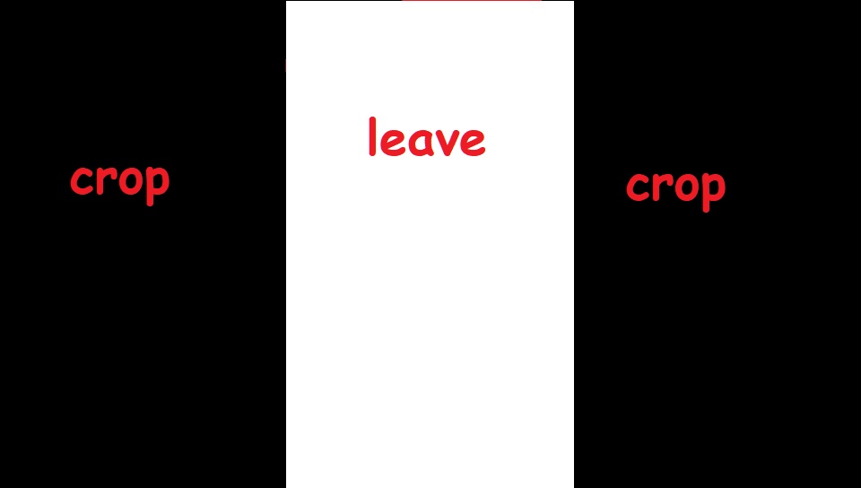

    If you want your final frame to be 16:9 with no sidebars, you'll have a massacre on your hands!

    No, not cropping to 16x9 ratio in landscape as you show the crop frame in your image, i said the following in my opening post.
    Obviously if i crop just the sides off, my file will be 1080 in height x whatever it will be in width, and that is fine, whatever it will be.
    Obviously the videos were recorded in 1920x1080 so the original height would have been 1920 pixels x 1080 pixels wide, but when someone butchered these and converted them to 1920x1080 in landscape mode, the actual image ended up at 1080 in height, and around 605 in width within the 1920x1080 frame.
    I am happy to keep them at the 1080 height x 605 or whatever it will be when cropped because they will only be watched on mobile phones in portrait mode, the quality will be fine regardless of the bitrate that i re-encode them at.
    [Attachment 82094 - Click to enlarge]

  7. Maybe you do not need any crop. Post the mediainfo report.

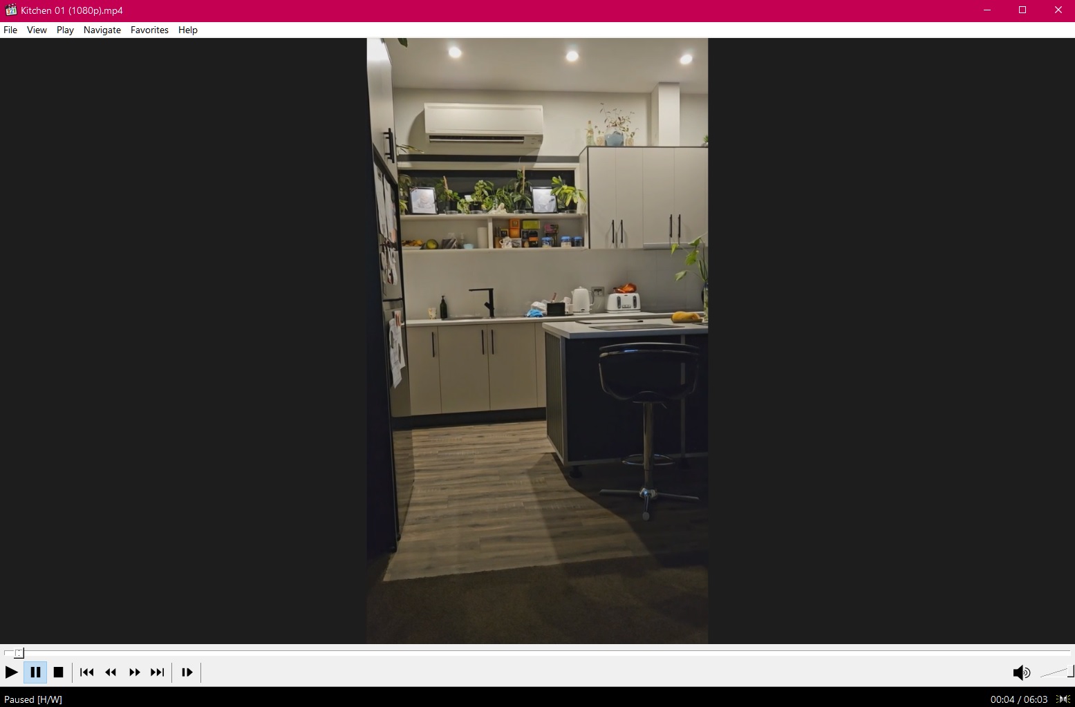

    this is a frame from one video
    [Attachment 82099 - Click to enlarge]
    This is the MediaInfo Tree
    [Attachment 82098 - Click to enlarge]
    I know that the videos were recorded at 1080p, but why would somewone convert them like this to 1080p in landscape mode which had to add the black bars to the sides, this just means that the image portion is a lot harder to see when watching on a phone.
    I might be able to find out what software was used.

  9. OK, you need crop.
    Use clever FFmpeg-GUI.
    Load your file, click main, click encode videostream, click crop detect, click preview.
    If the preview is ok then click OK,done, else click next crop and preview again.
    In the next screen make your encoding settings and encode your video.
