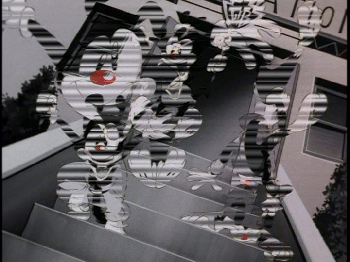

The artifacts I'm referring to appear to be frames with interlaced images overlaid onto a progressive frame.
[Attachment 82060 - Click to enlarge]
The predominant pattern seems to be 4 progressive frames followed by 1 interlaced frame (PPPPI) most of the time, but not always. From what I've read, I'm guessing the footage has been telecined to convert from 24 fps (typical animation frame rate) to 29.97 (NTSC broadcast frame rate).
What confuses me is that these fifth frames appear to be progressive when I view it in mpv, with the interlaced image seemingly baked in? I thought an interlaced frame would only display half of the image but maybe mpv is overlaying it onto the previous frame and merging the two? Or did the manufacturer render a shoddy encode that is fully progressive but with interlaced artifacts on every fifth frame?

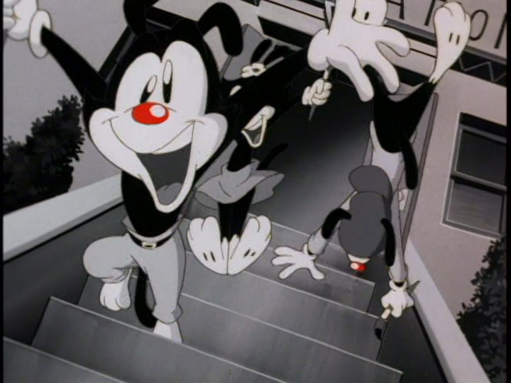

With Detelecine only, the interlaced images are gone but there's residual ghosts of the interlacing:
[Attachment 82061 - Click to enlarge]

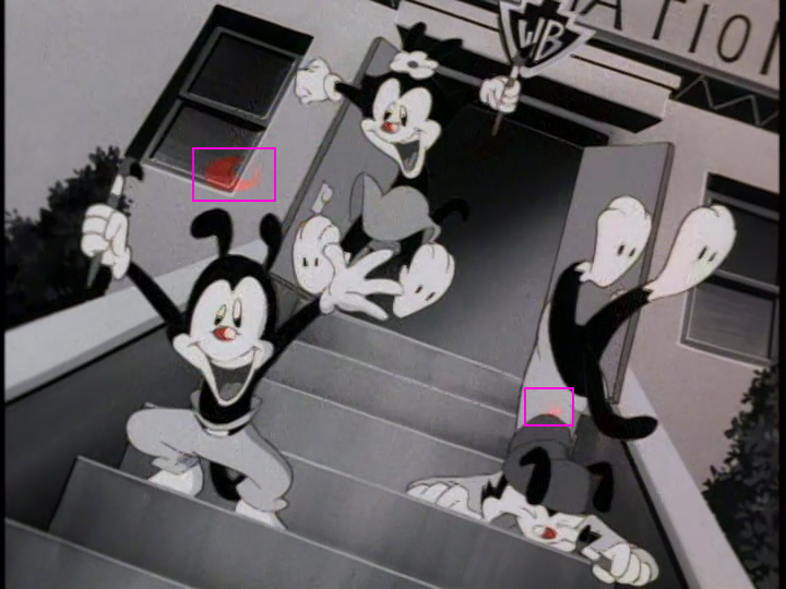

With Decomb only, the ghosts are more pronounced:
[Attachment 82062 - Click to enlarge]
With both Detelecine and Decomb, I cannot detect any ghosting but there are perhaps duplicate frames now:
[Attachment 82063 - Click to enlarge]
What I'd like to know is how best to resolve artifacts like this. I know my way around Handbrake but if learning Avisynth and using TIVTC is going to yield superior results, I'm willing to learn. I'd also appreciate if someone could clearly diagnose just what these artifacts are -- just so I understand whether to mentally note them as interlacing or telecine (or maybe just a shoddy encoding job by the manufacturer?).
