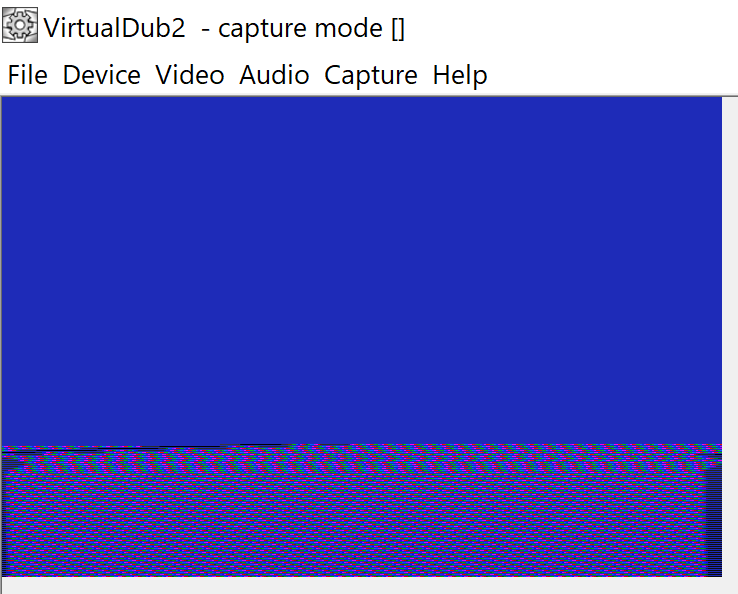

    I know the GV-USB2 is not highly regarded here but I still pulled the trigger on it, as I saw it as a good budget capture device without having to get into too many technical details (I was wrong.) and since I only need to digitize six Video8 and 11 VHS-C tapes, I said why not.
    I tested all my tapes inside two camcorders. They play fine. Then I proceeded to actually play them on VirtualDub2, OBS and VLC but no matter what configuration I set, I simply can't get any frames out of the camcorders. The audio plays fine but the fps counter goes from 30 to 0 fps as soon as I start playing a tape.
    The output in VDub2 looks like the following:
    [Attachment 82008 - Click to enlarge]
    It looks as if it only picks up a single frame and then dies out, going from the set fps to 0 instantly. Then, when I stop my tape, the fps counter goes immediately back to the set fps.
    I know that my tapes are NTSC, however my Video8 camcorder (rental) is a Sony DCR-TRV345E PAL, so I tried many different configurations both with NTSC and PAL. I have tried different codecs, also the Ut Video suite. I tried both composite and S-video with no luck. Since I'm on Windows 10, I have enabled access to camera for all desktop apps. I played with different graphics cards (my integrated Intel and dedicated Nivdia RTX 2060 Max-Q). I tried different driver versions for the dongle and even tried everything on another PC. All this also applies to the Panasonic NV-S88 camcorder I'm using for VHS-C digitization, so I'm suspecting it's the capture card... or have I not set it up properly? What else is there to set up for a low-end capture card like this?
    Am I overlooking something? Is the capture card the culprit? How can I check if I'm indeed getting signal from the cameras?
    I would really appreciate any help!

    Hold it. Correct me if I'm wrong but the S88 is PAL too. You're trying to play NTSC tapes in camcorders. Have you read the manuals; can they actually do that?

    I just checked the 345E manual; it's PAL only.
  4. Originally Posted by Alwyn View Post
    PS: There is only one person who hates on the GV-USB2.
    Thank you so much for your reply!
    Is there a difference between playing the tapes on the camcorder itself and actually trying to get output into a capture device? The tapes play really well on the camera. I just checked the manual and also confirmed that there is an NTSC playback mode where you can choose "On PAL TV" or NTSC 4.43. My Sony MP120 cassette says NTSC with an '8' next to it. Am I outta luck?

    Missed that NTSC playback function.
    Try this:
    In VDub (with the GV-USB2 plugged in), when in Capture mode, go Video>Capture Filter. Then, on the Video Decoder tab, from the droplist to NTSC_433. If no joy, try the other options for the various systems. Generally, PAL_B will be OK for PAL. You may have to adjust the capture frame size to 720x480.
    There are a couple of PAL60-NTSC443 experts here so if you still have trouble report back and they can help out.
    BTW, the resident expert says that VDub 1.9.11 is the best capture program.

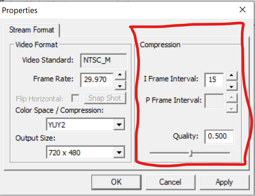

    Thank you for the insight! The NV-S88 does play my VHS-C and honestly, I'm not sure if my VHS tapes are also NTSC or just PAL (My parents shot all these tapes and OF COURSE they don't know!) However, the tapes look mostly fine when played in the camera and, to my surprise, it also has a line-TBC which is decent when you look at the tapes.
    As for the correct settings, I have gone through multiple tutorials everywhere and checked forums. I even followed Alwyn's magnificent guide on AmarecTV and basically used the same settings over on VDub as well, but still no luck. The only thing that kind of bugs me is that in most tutorials, the following is greyed out, but not in my case:
    [Attachment 82015 - Click to enlarge]
    Which kind of makes me wonder if these settings are correct, or would have any kind of effect in solving my issue.
    Better keep it at max quality.
    See this post:
    VirtualDub Capture Pin Compression Settings
    Originally Posted by VHSvideocapture View Post
    I capture at 720x576 the compression quality setting needs to be at end to full if it's not then you will get bad quality something which I have learnt now��
    But those settings should not be the cause you not have any picture yet.
    Did you try another known good source/cable to verify?
    Even you can use the live camera view directly.
    The PAL/NTSC playback makes everything more confusing of course.
    But at least you should receive something of a picture, BW or colour.
