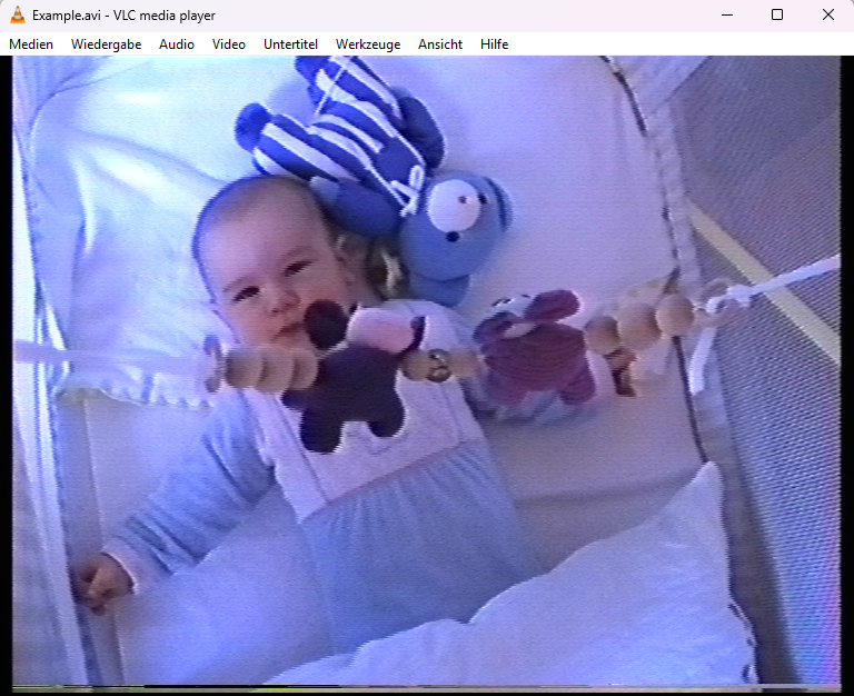

  4. @johnmeyer: thankfully, I am in no rush to digitze. Thanks to this forum I start seeing the difference between DV and S-Video (analog) capture, so while it would agree that a lot of people won't notice a huge difference unless directly addressed, I want to get the best possible result for myself using the hardware and methods that I have .
    @Alwyn just making sure I understand correctly:
    I basically have to crop AT LEAST 6 pixels from the bottom (resulting in 6 x 1.3333 = 7,99998 so almost 8, an even number) to get an even number to crop from the sides?
    If it's still Interlaced, yes. But if it has already been deinterlaced you can crop to the pixel.
    My workflow is: create script to deinterlace eg QTGMC, open script in VDub, crop as required (and apply other stuff as necessary), resize to desired, then "Save video". There's only "one step" because the act of opening the AVS in VDub isn't actually an encode, even though, as far as VDub is concerned, the video is deinterlaced.
    Re your script, if the video is already deinterlaced/progressive, I don't see the need to use QTGMC.
    What's not clear to me from your post is whether you deinterlace and crop using one avisynth script (as I did in post #57) or whether these steps are separated.
    Also, would I not be able to crop to the pixel using my above mentioned script, even if the base file was an original, interlaced, video, given that it would FIRST deinterlace (lines 1-5) and then only crop (lines 6-8)?

    But all of this in separate steps, yes? 1. Deinterlace using avisynth. 2. Crop using another script WITHOUT resizing though, and 3. saving video in VirtualDub to x264 using SAR 12:11. Again, same question as above, this is not possible by just using my script from post #57 (excluding the resizing)?
    May 2005
    Australia-PAL Land
    What I do is set up an AVISynth script to do the deinterlacing (via QTGMC) and then open the AVS (script) in VDub for cropping, resizing and export. The act of opening the script, I suppose you could say, is one "step" but nothing has actually happened, encoding-wise. AVISynth has "served" to deinterlaced file to VDub. As far as VDub is concerned, it is looking at a deinterlaced file. You can inspect it with VDub and you'll find it is Progressive.
    Then I crop it, resize it, do other stuff such as colour adjustments, maybe apply stabilisation with the Deshaker filter, or noise reduction with Neta Video (paid), edit it (chop out the bits I don't want) and then export it either as an AVI for use in my video editing programs or to H264/MP4.
    It is, of course, possible to do most of that in one go as you have in your script, except that you still have to export it.

    If I only crop to 704x576, I dont only have head switching noise but would have to keep more noise on the left and right side (distorted colors) that I simply dont want in the footage that I will combine with other clips for a family movie. Cropping how I like will result in different clips with different aspect ratios, which won't be great for combining either. Alwyns approach, resizing to 768x576 seemed logically, to get everything on a common basis. If you say that this is not the "right" way to do it, could you please recommend what I do instead?
    @Alwyn: I tested your approach, resizing to 768x576, however switched things up with cropping. I did one version where I directly cropped in a 4:3 (see "Example_Crop4-3.png) manner (taking of from top and bottom directly when taking off from the sides) as well as taking off 16 pixels from the sides, and then only started cropping in a 4:3 manner when taking off more from the width/height (see Example_Crop8_Then-in-line-with-4-3.png). I compared it to the original 720x576 avi (Example.avi.png). See attached. At least in my perception, the first approach looks "more correct" i.e. looks more like the original 720x576 footage (no stretching or so of the image, which seems to be the case when I first take off 16 pixels from sides and then start cropping to 4:3 and resizing). Did I do something wrong then?
