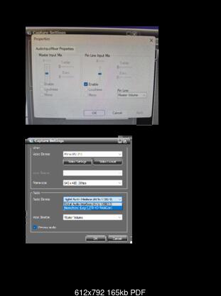

    Sep 2024
    Henderson, NV
    Please see the attachment. Just to be clear, you're saying to set the audio to "Microphone," instead of "Digital Audio Interface," correct?

  22. I assume you're plugging the audio cable(s) into your capture device, so no, "Digital Audio Interface (AV to USB2.0) is probably the input device you want. But there should be a configuration dialog where you specify the properties that you want to capture with, and/or the settings for the device. That is where you are likely to find the mic/line levels setting. Something like the Properties dialog in your image.
    Note that many years ago it was common to have separate mic and line inputs, mic inputs had 10 to 20 dB more sensitivity. But now it's common for audio inputs to be configurable for mic or line. When configured as mic inputs they add an additional 10 to 20 dB gain.
