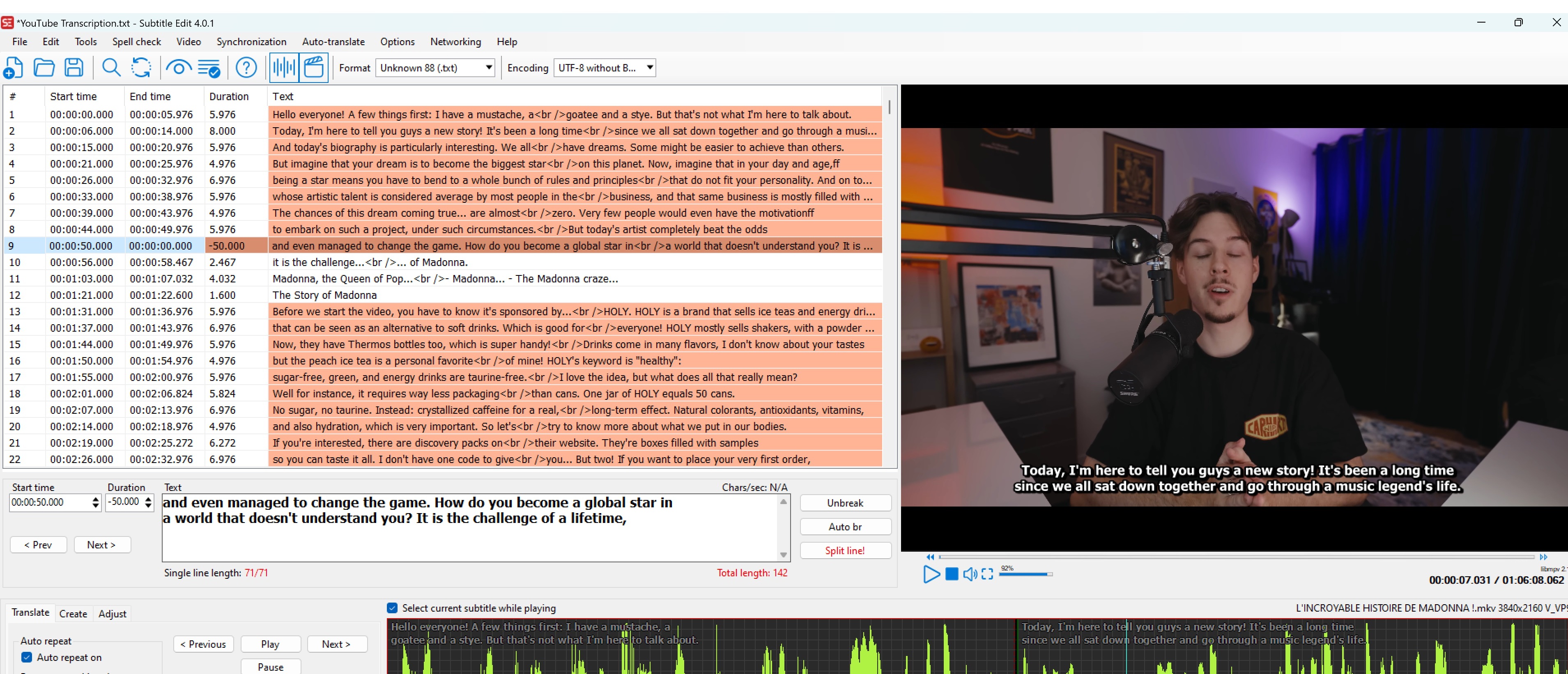

    I noticed that this video has already English subtitles. I downloaded the transcripts and opened it in SubtitleEdit. Opened also the video and created the audio waveforms (see attached image - the text is for line 2). Everything looks perfect.
    The only way to replicate what you have is to hit the split line so I get for the first line these sentences:
    Without splitting the lines
    Line 1
    Hello everyone! A few things first: I have a mustache, a
    goatee and a stye. But that's not what I'm here to talk about.
    After splitting the line:
    Your file
    1
    00:00:00,001 --> 00:00:01,684
    Hello everyone already
    several things I have a
    mustache a goatee
    and a stye that's it but
    Your translation is different from what is in the video already.
    The guy behind the microphone speaks fast and doesn't pause so the text line looks too long to follow while watching.
    Did you add the subtitles yourself or you are trying to do it yourself from scratch?
    I hope that this helps you a little
    Thanks.
Name:	SubtitleEdit Snapshot2.jpg
