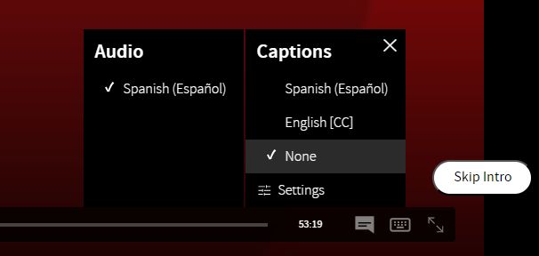

  20. use safari browser
    Dec 2021
    england
    Originally Posted by ListyDoM View Post
    use safari browser
    you can do normal browser.
    just filter find link lemonade

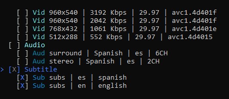

    https://lemonade.nbc.com/v1/vod/2304991196/9000456433?platform=web&browser=other&programmingType=Full%20Episode
    change web to androidtv
    https://lemonade.nbc.com/v1/vod/2304991196/9000456433?platform=androidTv&browser=other&programmingType=Full%20Episode
    now you can download en and es via n_m3u8re-dl
    https://vod-lf-oneapp2-prd.akamaized.net/prod/telemundo/vrK/tc5/9000456433/vge_vgp/ONE...aster_cmaf.mpd
