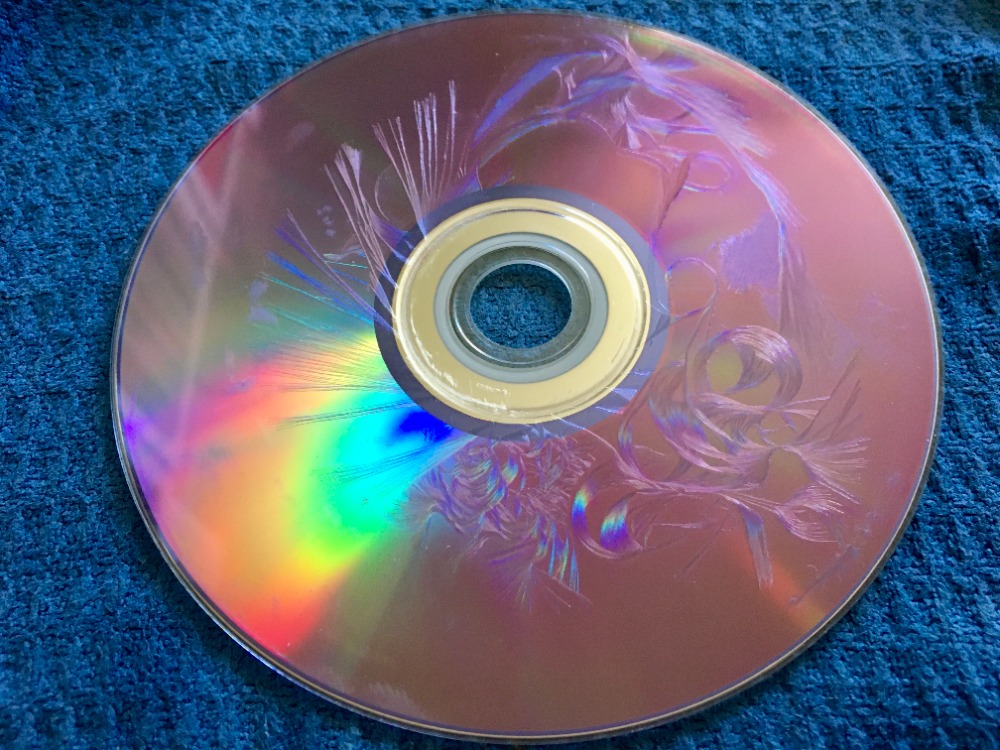

    All my DVD-Rs have been stored vertically in cases in a cool dry place for the last 20 years.
    Due to lack of storage space I've started moving my DVD-Rs from cases to (high quality) paper sleeves.

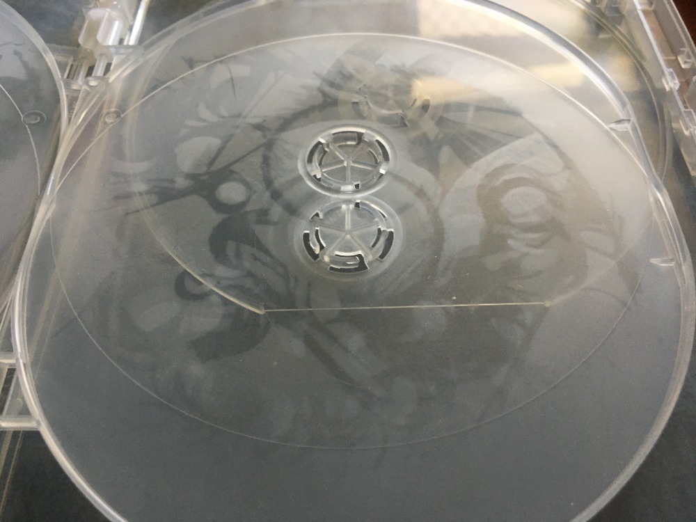

    Which is when I noticed that some of the DVD-Rs had some very odd damage. (See attached photographs).
    I have never seen anything like this before, and I am curious to know if anyone else has experienced it.
    It has not occurred TO DVD-Rs STORED in black plastic cases.
    It has only occurred to DVD-Rs stored in clear PLASTIC CASES, but not in all clear plastic cases.
    It has happened only with a certain type of plastic case. (I don't have the knowledge to id the type of plastic).
    As the pattern that appears on the DVD-R also appears on the surface of the DVD case, I'm assuming some sort
    of "reaction" occurred in the plastic case causing to spray plastic onto the DVD-R.
    At this point I'm holding off any "cleaning" until I know more.
    Any information you may have about this matter will be most gratefully received.
    [Attachment 81813 - Click to enlarge]
    [Attachment 81814 - Click to enlarge]

    I'm suspecting it's a reaction caused by either direct contact with or fumes from a substance used in production of the clear cases.
    What happens if you wipe the case with a damp paper towel? Does the pattern wipe away?

    Thank you for your reply. It is appreciated.
    Believe it or not, I have no paper towels.
    The surface of the case; directly below where the DVD sat is a little sticky. The plastic pattern is "raised".
    I wipe it with a damp microfibre cloth but the pattern remains.
    On the DVD the pattern is "raised", you can feel it.
    I used a micro fibre cloth on this with some "DVD cleaning fluid" and after a little scrubbing it disappeared.
    However, while the surface of the DVD is smooth, the pattern can still be seen in the surface of the DVD.
    And cannot be read.
    As it cannot be read, I've nothing to lose and will try something a little more abrasive, not destructive, to see how deep the reaction went.

    I checked a number of black plastic cases. They all had the triangle logo with a 5 inside. With PP underneath.
    I checked a number of clear plastic cases, those that had a marking had a triangle with a 5 inside. With PP underneath.
    Many of the clear plastic cases had no triangle mark, that I could find.
    I also checked the additional mounts, (pages? flaps?), in the DVD case that holds 6 DVDs, (what are they called?), but these had no markings.
    So I can't ID the plastic they are made of, and this is where the really bad damage was caused.
    On the positive side after going through all my disks; only about 20 have suffered this event, and fortunately I believe I have backups of the data.
    Still, it's concerning that after properly storing every thing this could happen. And I surprised no one else has brought it up.

    Interesting thread. It tracks with an unrelated experience that I had explained to me when I bought a new car. No longer being a cigarette smoker, I asked the car dealership why the interior of my car windows was getting a film on it, similar to what would happen if I had continued to smoke cigarettes in the car. I was told it was caused by the fumes from the plastics used for the interior of the car. Makes my lungs hurt just thinking about that.
    Too many cases warp discs. Over the longer term, what you see happens.

    I don't think it's caused mechanically (warping).
    If it was purely mechanical, there would be no sticky stuff.
    In my opinion, the fact that the affected cases do not even state what plastic they are made of, and because the pattern cannot be wiped off, encourages my inital suspicion they are made of wonky substances and/or low quality raw materials which cause a chemical reaction with the Polycarbonate of the DVDs over the course of many years.
    You mentioned the cases were stored in a cool and dry place, but what about exposure to light?
    All the cases were stored two deep in bookcases. No direct sunlight. Just the natural shaded light in the room. And all the cases had a slipcover.
    And the event only happened to the degree shown on the additional internal mounts. (Do those things have an official name?)
    Those double platters heavily warp media. What you see here is micro cracks to the inner bonding, and it has allows air seep to oxide the dye layer into the patterns you see. There's nothing unusual here, seen it before.
    What is the media ID / brand of these disc? That give a tell-tale to bonding (non)quality.
    I actually like the idea of micro cracks + offgassing ("fumes"), that would give the "push" we see that created the patterns. Air alone has no reason to move, but offgassing does.
    None of the DVDs are warped. As in deformed/bent, warp vinyl LP. They just have the pattern you see in the photographs.
    So the outgassing from the clear plastic platters causes micro creaks and allows air in. any idea why it creates such a pretty pattern?
    You've seen exactly this problem before? May I ask when and what you saw?
    I use Verbatim. And have done since the early 2000s.
    I have Verbatim discs from back then, that can still be read perfectly. No problems at all.
    I can only say that the Verbatim disc's I been using for the last 20 years are fine, expect for the handful that suffered this plastic outgassing event.
    Verbatim did release a bluray disc that was cheaper having some new method for making it, the burning side was gold. I tried them. They all failed within a few months. If not faster. I haven't seen them for sale since.
    OK, so its an outgassing event. And it creates these very unusual patterns.
    I'll see if I can recover any of the discs, how deep does the damage go, or is it just on the surface, and report back. It may be a week or two.
  11. Video Restorer lordsmurf's Avatar
    NOTE: I'm operating with the information gives, the photos. It appears to be dye-layer issues, not external polycarbonate/plastic damage. Or possibly both. I'd need exhaustive photos (since you don't know what you're looking at, or looking for), or to see a disc in-hand.
    DVDs high tiny tolerances, microns to mm, not something you can see with your eyes. Warping is still highly likely here. Even just flexing the disc off the hub (rather than depressing the hub) can cause irreparable damage to discs.
    No, read it again. The cases/hubs stress the discs, cause micro-cracks in the disc bonding, and it allows air to oxidize the dye layer. Normally this just presents as small "fan" patterns on the outer edges or inner edges. But these wild formations you see may be from offgassing (or "off-gassing", but not "outgassing"), as the gasses in a sealed(ish) container may be swirling around inside. Offgassing is why we have "new car smell", but also why freshly painted rooms stink (VOCs)

    - The oxidize error is common. The offgassing is an interesting twist.
    - I did optical media research, starting in the late 90s, heavily/mostly in the 00s, then stopping in the mid 10s (because the format is essentially now dead, nothing "new" to research or learn, mostly all known knowns now). I still get inquiries from college students (thesis/etc), a certain media company. Also a few Youtubers, because other Youtubers are idiots claiming DVD myths as facts.
    Alright, but understand that "Verbatim" is just a brand name, the MID still matters. Same for era/age of the disc. A Verbatim could be high-quality MKM, or craptastic Life Series early CMC (not AZO CMC).
    Yes, and I got onto a pair of companies for this fact. The entire "gold" snafu was due to customer ignorance, falsely thinking "gold" is better material for DVDs. Basic science would make you realize that, but most people don't know science, "science is hard". Customers demanded "gold", companies obliged, but harmed their own reputation in the process. Because, duh, gold has garbage reflectivity to the wavelength of a DVD dye sandwich, unlike silvery alloys. Education and marketing was needed, not providing junk to their dumbest customers.
    Outgassing is hypothesis here, but it's very plausible. I looked at some science references before I ever replied with the suggestion. Like I wrote above, that's an interesting twist on dye oxidizing.
    I'd need to see a disc in-hand. But from the images I see here, the dye is oxidized in patterns, so it's a total loss of data.
    But even if we assume I'm wrong about bonding/dye, then it's an external polycarb issue. At best, it would need a resurfacing (with an actual $500+ RTI machine, not a $50 "doctor" toy).
    Run ISO Puzzle on it.
    How many is exhaustive?
    How?
    Well, I'm currently transferring all my DVD-Rs to paper sleeves.
    OK.
    No, read it again.
    Yes I did that. Twice maybe three times.
    Makes you wonder why they put them in cases.
    As the patterns on the DVD are a mirror of what you can see on the platter, I'm thinking it's outgassing from the platters, rather than damage to the DVDs.
    In twenty years I've never seen it. And some of the DVDs that have been damaged I used only a few years ago. Which seems to indicate the plastic platters, that outgassed did it in the last few years.
    I am aware.
    I am aware of the Media Identification Code (MID), and have always insisted on MKM.
    I never assumed that the discs were made from "gold".
    Yes I was aware. I purchased a small number for testing. They seemed to fine. I purcahsed a half cake. Then after a while they started to fail.
    Yes, I know. Its why I tested a number of discs to see how long they'd last.
    When I used the term "gold" I meant that the burnable surface was coloured gold. If I remember correctly the disc's were some new type that Verbatim claimed were easier of faster to make and just as good. Of course the Verbatim "Lifetime Warranty" isn't worth anything. Fortunately while the disc's died, I didn't lose any data.
    I hope you're not suggesting that I was a dumb customer. A new product came out. I tried it. It was bad. I never used them again.
    Whatever the cause it's very weird. I would have expected more people reporting something like this.
    We'll see.
    But even if we assume I'm wrong about bonding/dye, then it's an external polycarb issue. At best, it would need a resurfacing (with an actual $500+ RTI machine, not a $50 "doctor" toy). Run ISO Puzzle on it.
    Fortunately I have much of the material backed up. So I'm not looking at massive losses.
    Could you link me to an RTI machine? I did look, but I'm not sure what you're referring too.
    Thanks for the feedback.
    Paper is made of trees. You're essentially rubbing your discs with tree bark. For the same reason, wiping a disc with a paper towels or napkin is damaging. Sleeves are best. Not often wallets, too many of those also warp discs.
    It's not just any case. For example, name-branded Amaray was often fine. Fake Amaray, or no-name junk, is what screwed up discs. But even Amary QC could suck. If you ever feel a disc flex whatsoever, the case or tray is bad. The disc should spin freely, though too much spin was also bad.
    Not necessarily. If the outgassing caused a chemical reaction to the dye, not just oxidizing, then it could have changed the polycard in those spots to affect the tray.
    Yeah, but how many discs have you seen? I've easily handled 100,000+ discs over the year, mostly in the 00s and earliest 10s. I've also had many discs submitted to me for R&D.
    Remember, fake MKM/MCC was very popular in the late 00s. Even the Verbatim packaging was being faked. And while most were sold on 3rd-party sites like eBay, some stores got suckered. For example, person ordered fakes online, bought legit from stores, "returned" fakes to store. We saw it back in the day.
    In the case of Verbatim, it was gold upper with silver under, because MCC knew gold wasn't reflective. Others like Mitsui/MAM (OEM'd by "Kodak" brand) were pure gold, and those company bankrupted the re-failed for a reason. Their discs were mostly garbage. Mitsui made great CD-R dyes in the 90s, but that was it.
    It is! But we still see new weird stuff in the optical world, edge cases, normally related to wrong/bad disc storage, and chemical reactions that happened from it. Sometimes mold. (Uh-oh, I said the m-word, I may have just summoned gamemaniaco!)

    Sorry for the delay in getting back to this thread. Like John Lennon said: "Life is what happens to you while you're making other plans".
    I looked at all the "CD/DVD Repair" videos I could find online. YT mainly. all were about scratch repair.
    Most people seemed to be using 3000grit sandpaper followed by a polishing COMPOUND.
    I noticed the markings, (see photos above), were sticky, so I started by applying dish washing up liquid. Not too much. I spread it around and was surprised when it washed away the surface material.
    Not all of it, of course. It appeared to have "soaked in". So I attached one of the DVDs using a polishing wheel, (as stiff backing), and slightly larger washer, to hold the DVD on the polishing wheel, and then attached it all to my power drill. Power on.
    I proceeded to preform sanding of the top of the DVD with 3000grit sandpaper, putting the sandpaper under the tap every 20 seconds or so, and sanded for 3 minutes.
    Now sometimes at the end of the 3 minutes the DVD surface was nice and smooth. Sometimes it had circular scratches. I kept sanding applying gentle pressure with the sandpaper until I got a clean smooth finish. (No marks).
    Following the sanding I used TurtleWax Polishing compound. Covered the disk, then started the drill, and polished for about 3 minutes.
    Some DVDs were fine the first time and played without issue. Others I had to repeat the process, sometimes 2 or 3 times.
    I managed to get most working again so far. I still have a few to do.
    I copied all the restored DVD to the hard drive and will burn additional copies just in case.
    NOTE: getting to this point required some experimentation. finding a suitable mount for the DVD to put it on the power drill was the main one.
    the first mount I tried cracked the DVD near the centre hole. no support under the DVD centre hole. the polishing wheel, was compacted wool (?) and had support all the way across.
    As to the cause, as the surface material washed off, I assume it was some sort of plastic "out gas" from the DVD cover the DVD was mounted in/on.
    Many thanks to everyone who contributed. It is very much appreciated. And if anyone else has this problem, hopefully this will help.
    I am currently in the process of moving all my DVDs to paper sleeves. This experience has put me off the CLEAR plastic cases. And it does save a HUGE amount of space. Of which I do not have much.
