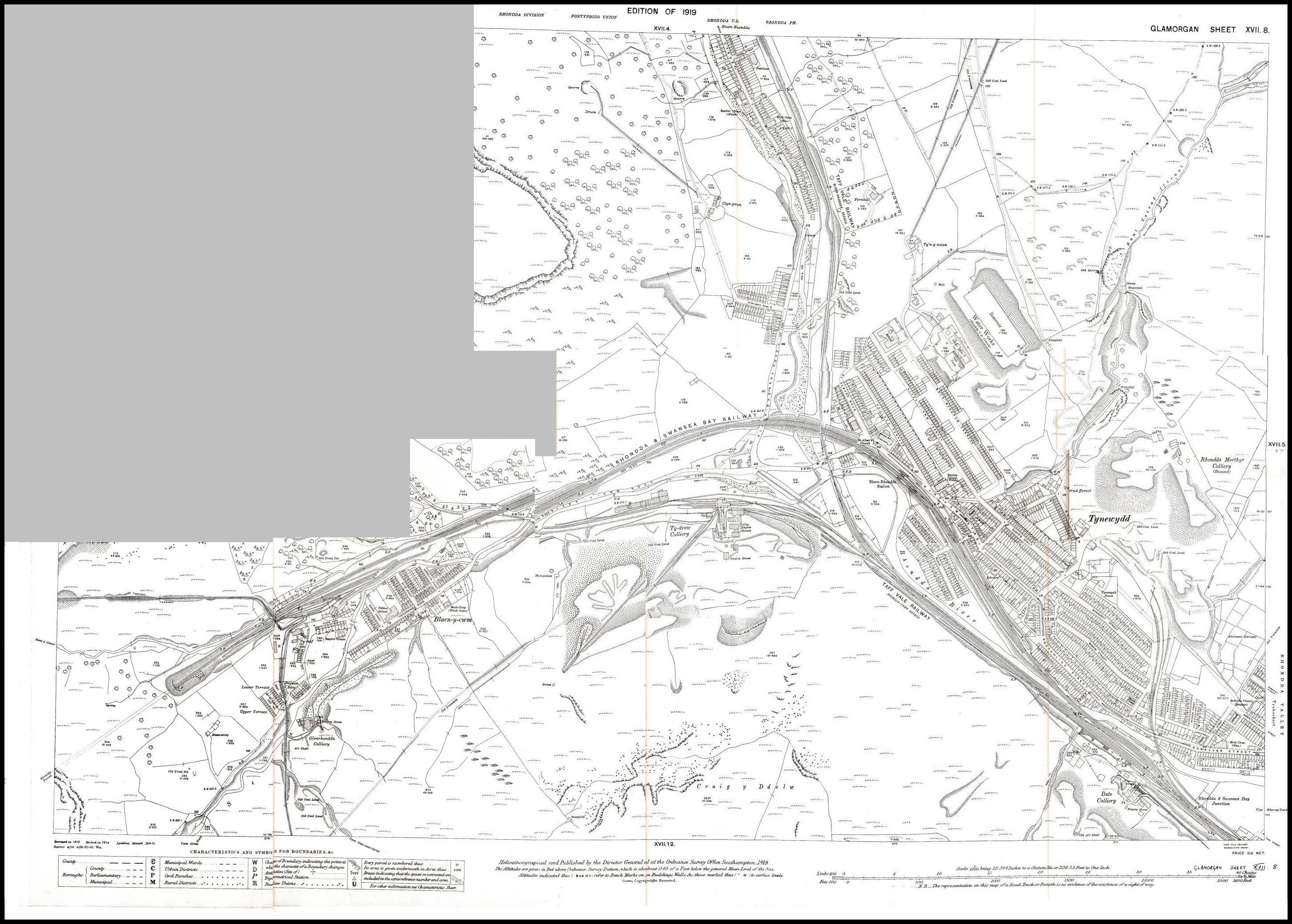

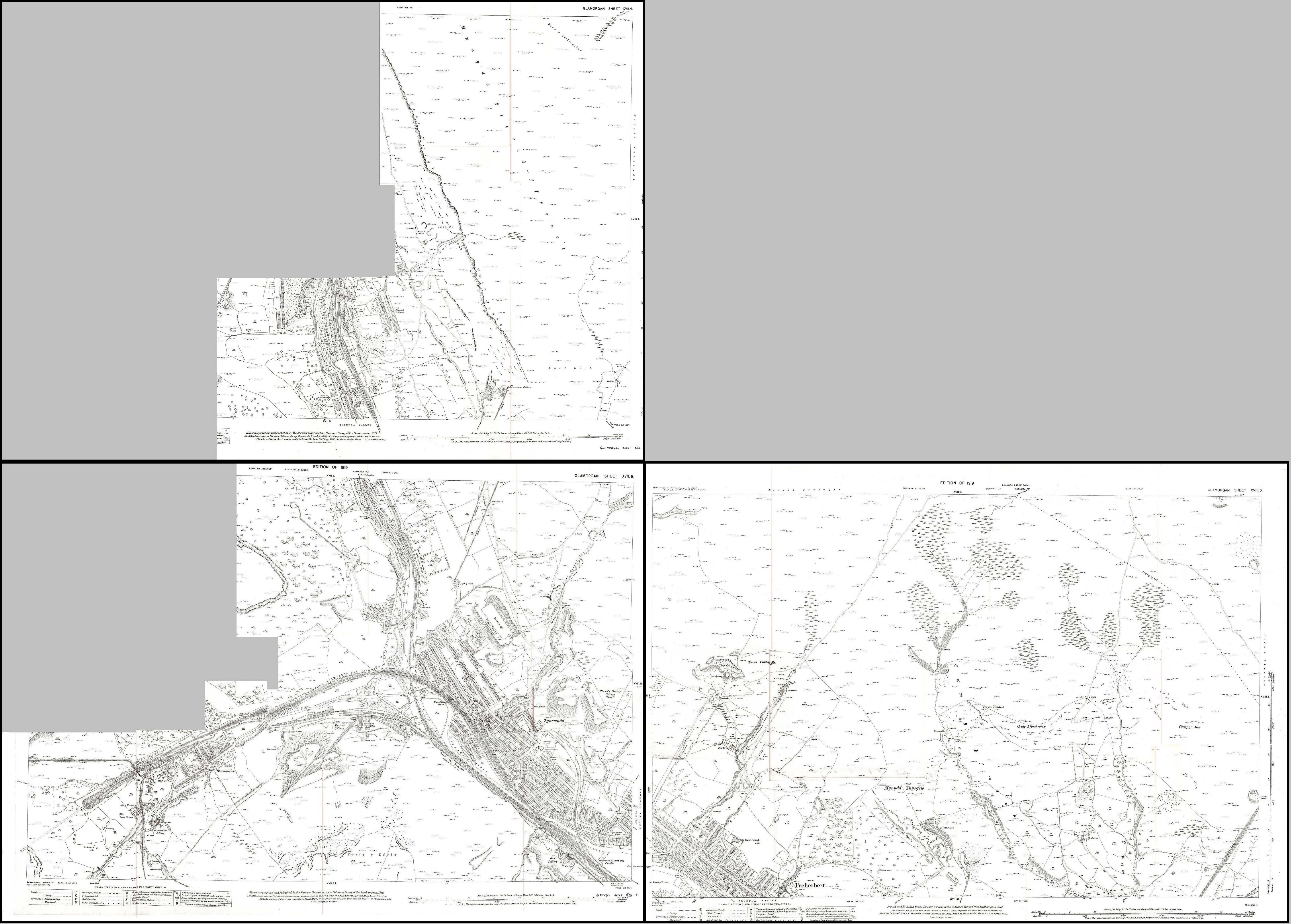

    My want is somewhat different since I have a 'base' but that 'base' will grow as I try to merge, for want of a better word, individual images. For example, my first image has a width of 1920 pixels and a height of 900. Yet I estimate that the total size will be 2600x2600. Of course I can create a canvas of that size but PS will reduce that to fit the screen which then means the images I want to appear in the canvas will be too large. And they have to be large enough so that I can see the detail to join them at the right place.
    To give you a better idea of what I am trying to achieve I attach a sample of what I did all those years ago. One image is a composite of several full size images and the second is one full size where you can make out the 'joins'.

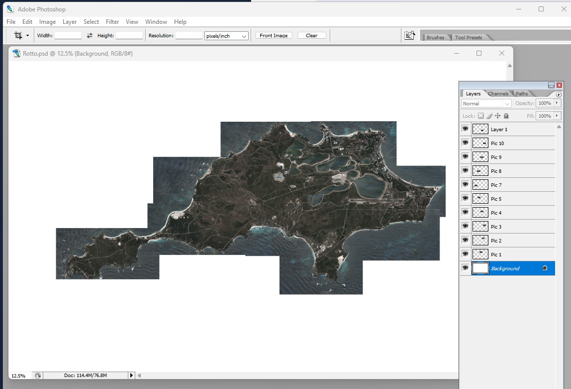

    Been there done that... in CS2 (Google Earth snippets)
    [Attachment 81806 - Click to enlarge]
  11. Member Cornucopia's Avatar
    @Alwyn, what is that, Atlantis?
    (Good job)

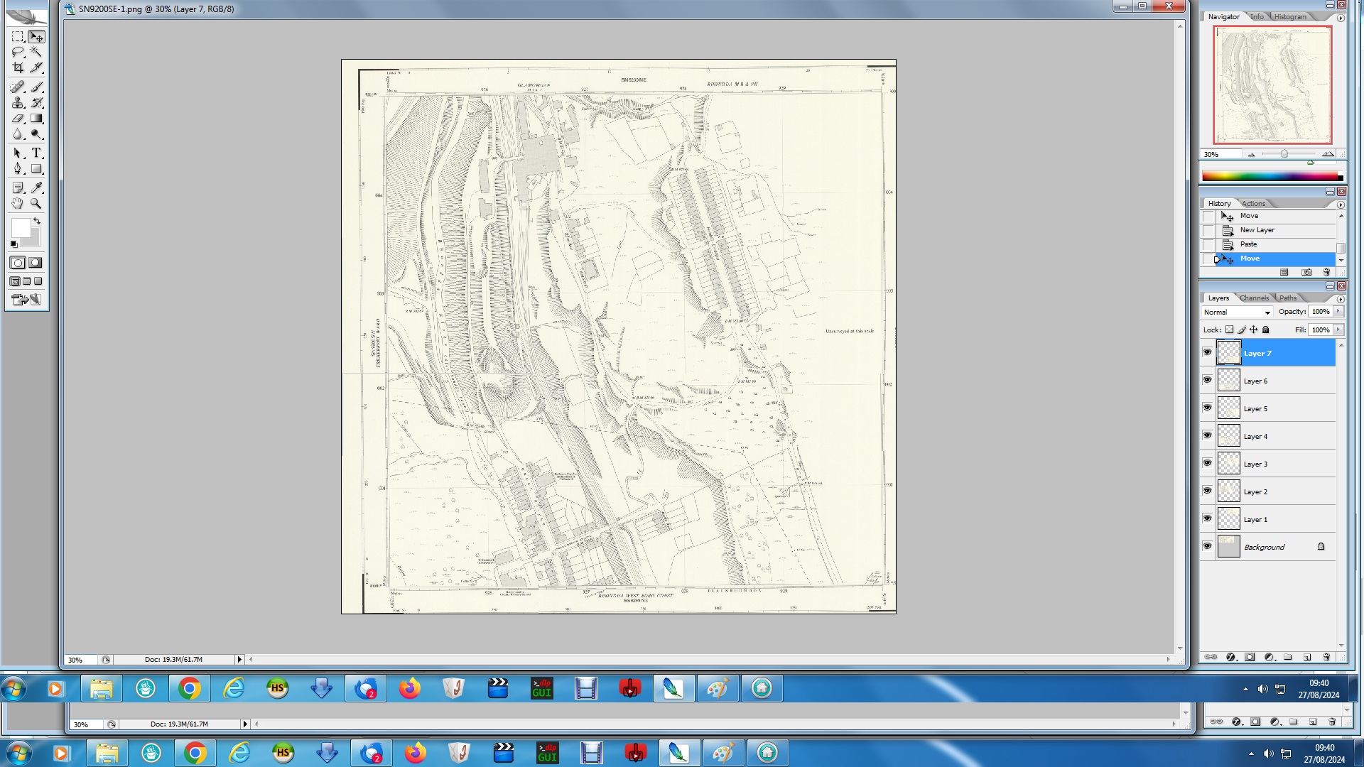

    I know I am a PITA but if I can be fully guided to 'import' image 2 in to the canvas then I should be able to use the same process for the remaining.
    So far, I opened image 1, set the canvas size and anchored image 1 to top left - I know appreciate that the canvas is windowed so I should not need to worry about its size. Then I altered the background color of the background layer from the checkerboard to my previously changed grey. Then I added a new layer. Now I am 'stuck'. I have highlighted layer 1 but I could easily be looking at the background layer since nothing changes when I toggle from one to the other. Sure I am having a senior moment but I simply can not see how the copy/paste as mentioned brings image 2 in to the canvas. The attached image shows how far I have got.
    Rottnest Island, Western Australia. I did that for use in Memory Map (offline GPS mapper) for following all the bike paths (no cars there).
    @DB83, What I do is open the next image, do a Select All>Copy, then close it.
    Then I create a new layer and paste. The image I copied and then closed (more accurately, the clipboard) will be pasted into the new layer.
  15. Member DB83's Avatar
    Jul 2007
    @Alwyn
    I owe you a tinnie (or more). Worked like a dream.
    And, once again, sincere thanks for all who contributed.
