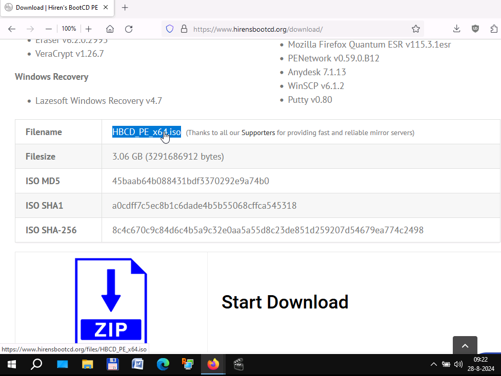

    Thanks The_Doman for the links to (many Windows WinPe Rescue USB's) will review these tomorrow too. The Hirens boot WinPE is a little bit odd? its got a Dublin business address and ads posted in the middle of the download page? I tried earlier, before I read your posts to download it, didnt download from the download button, just too much distractions on the download page, I will come back to this option later,
    I assume you are not using a decent Adblocker when surfing the net?
    Indeed then many sites will show very obtrusive ads to let you accidentally click on instead of the files you really want.
    Often the biggest flashing download buttons are the things to avoid.
    Use the adblocker Ublock Origin and preferable not Chrome but something like Firefox
    Not only to block ads/popups but also as some protection against malware/malicious sites.
    Here is the link showing you need to pick for download:
    https://www.hirensbootcd.org/files/HBCD_PE_x64.iso
    [Attachment 81817 - Click to enlarge]
