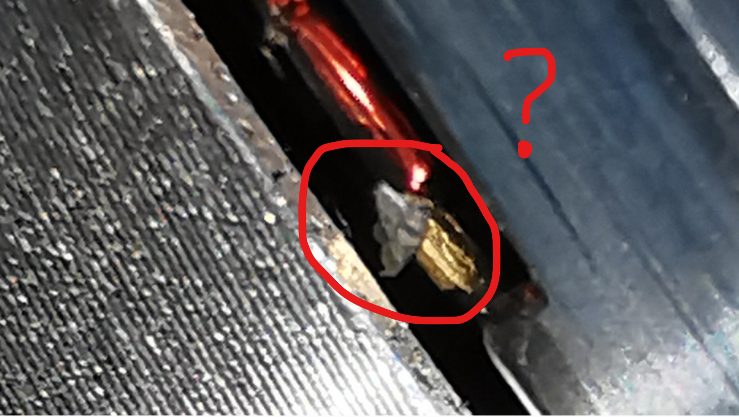

  1. I cleaned my VCRs heads because the video was very noisy and black and white. I used printer paper and vodka, since I don't have any IPA right now.
    Furthermore, I may have accidentally slipped and moved my finger up or down. I did get some sort of color image, but not much later, I got no signal whatsoever.
    The video heads don't look too bad to me, but I'm not an expert.
    Thanks for any help, and getting my VCR working, hopefully.
    JVC HR-D910EG
    Photos from the heads: https://www.dropbox.com/scl/fo/c9o4bo7qirorhwmk49zp0/ALmVr0Yn1CjCAQGxMAOJptE?rlkey=sle...=2fyy0q1w&dl=0

    The heads are shredded,not worth replacing.

    you probably nicked one head.
    that's why "trick" plb is ok and normal playback look exactly as if only one head is working.
    and heads are more sensitive to up/down than side movements, ie they're built to slide over tape laterally, not in vertical direction....

    The 1st and 3rd pictures are single head setup which I believe for HiFi audio, the 2nd and 4th are dual azimut twin heads for SP/LP, Only the first picture I'm suspicious about which shows like a piece of paper is stuck at the side of the head assembly but it only affects HiFi audio, I hope you got dirty video heads. But taking clear pictures or test with different tapes is the best way to find out for sure.

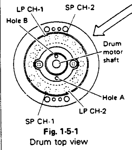

    From the service manual:
    [Attachment 81791 - Click to enlarge]

    but this should be removed anyway.
    shpadoinkle, remove debris, gently clean again, test.
    no luck=head damage, get another vcr.

    take some sort of magnifying glass and remove small white particle. with some plastic, or wooden toothpic(s).
    and don't tremble...heh....
    if you were to inspect that video in avisynth, with "separatefields()" you would probably see one field is purely noise.
    which means one head is not working.
    in that case you don't have many options.
    your only chance is that piece of debris is either on video head, or it's on audio head but it's lifting the tape slightly so the following video head can't read the video track properly.
    so after you remove debris, clean it again, let it dry a bit longer than if you were using iso alcohol (as you're using vodka), try once more.
    but chances are it's a toast, esp. because it chews tapes on top of everything.

    again, you should remove debris from first picture.
