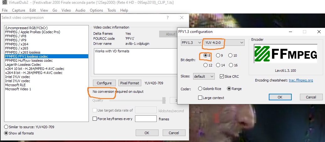

    Either upload one of the failing .ts files so we can investigate from here,
    or open the file in vdub2, set video/compression to ffv1 and file/save video/ save as avi
    then use that in DVDStyler
