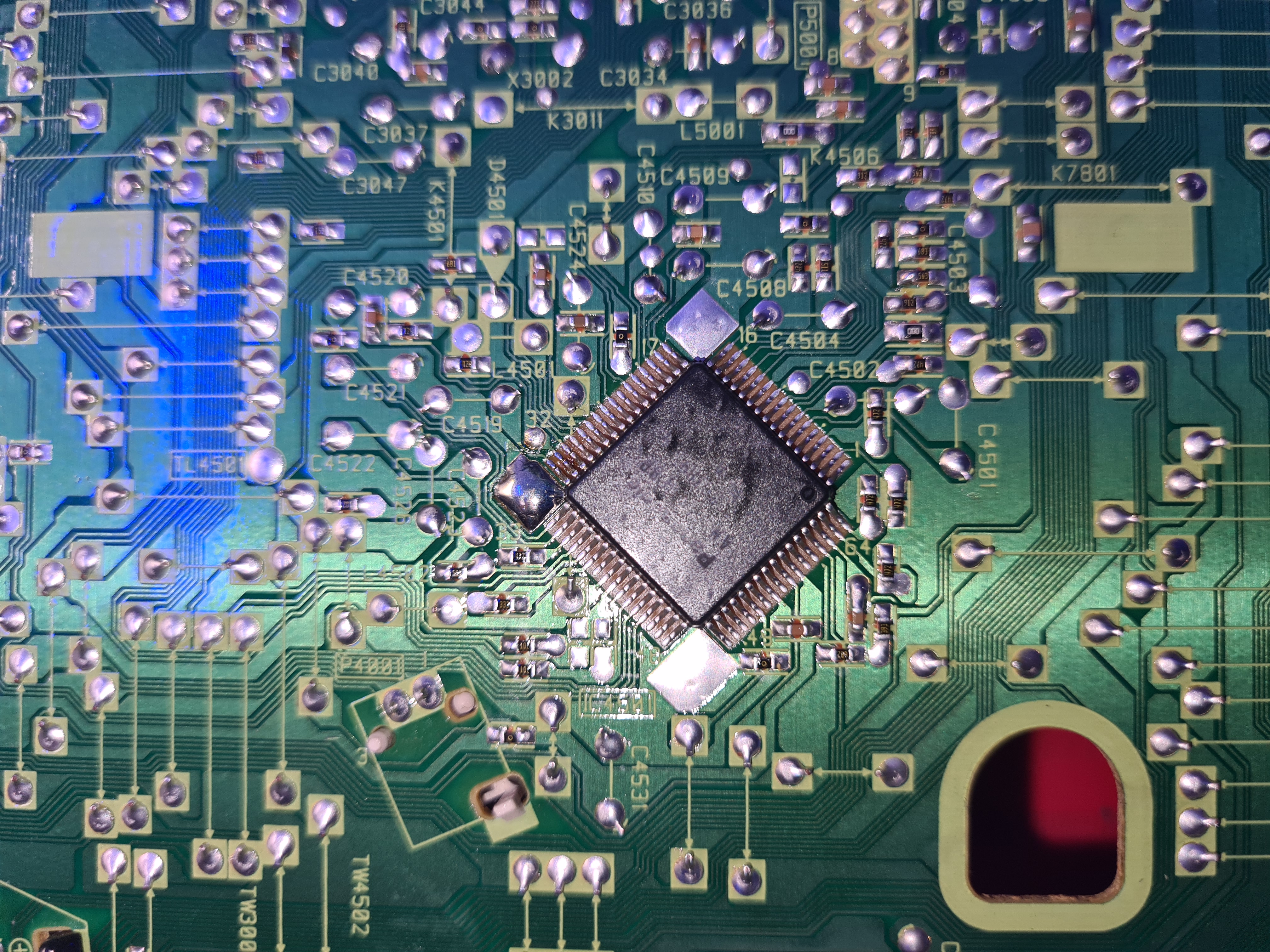

    Everything is crammed in the main PCB, it's hard to tell but I would be looking around the AC head connector area as well as around the IC4501 audio processing chip, look for bad capacitors, dry solder joints, corrosion ... etc.
  7. the condition of this unit is pristine, no moisture, no corrosion, no oxidation, checked the joints of the board, i remake (just to try) all those that seems worst (but nice joints compared to other units i have)
    checked all electrolytic capacitors near the IC... replaced 2.. but they was not bad...
    no changes....
    there is also a thing that yesterday i saw... the AV1 audio is highter compared to AV2... (But compared to other VCR both have lower volume)
    and on the AV2 there is some sort of echo. (???)
    the worst audio seems coming from the 2 RCA connectors near the 220V plug
    P.S. is possible to take audio directly from the head and use an external preamplifier?
