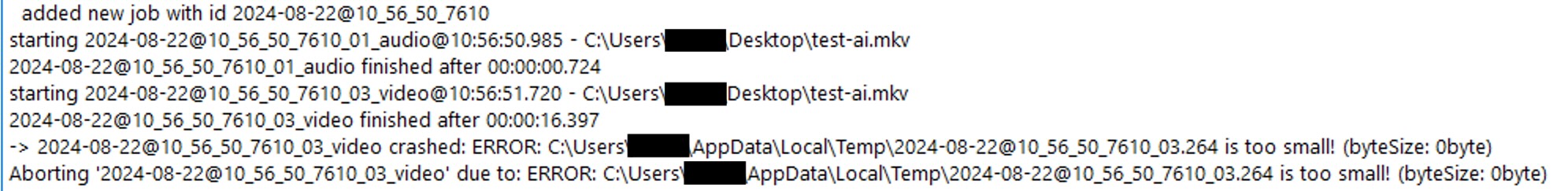

  6. Thank you both for the additional thoughts and suggestions, I might need to go the more traditional route. I tried running the BasicVSR++ filter and got the following error message in the logs.
    Hybrid seems to detect my GPU and shows those additional filters being available when I start the application. Wondering if perhaps I don't have a setting correct? I noticed I can't preview the video when I have BasicVSR++ enabled either.

  7. That error says nothing, which shouldn't be surprising since it's from a log what starts with:
    This log is only intended for user information. It should not be part of a bug/problem report!!
    (read: https://www.selur.de/support)
    Before trying to encode, best try the Vapoursynth Preview, if that fails encoding won't work either.
    Also, since you only have 6GB VRAM (or less), while using "Filtering->Vapoursynth->Other->BasicVSR++" you will need to use tiling to even have a change to get it working.
    (maybe: https://github.com/HolyWu/vs-basicvsrpp/issues/12 helps to understand tiling)
    Cu Selur
