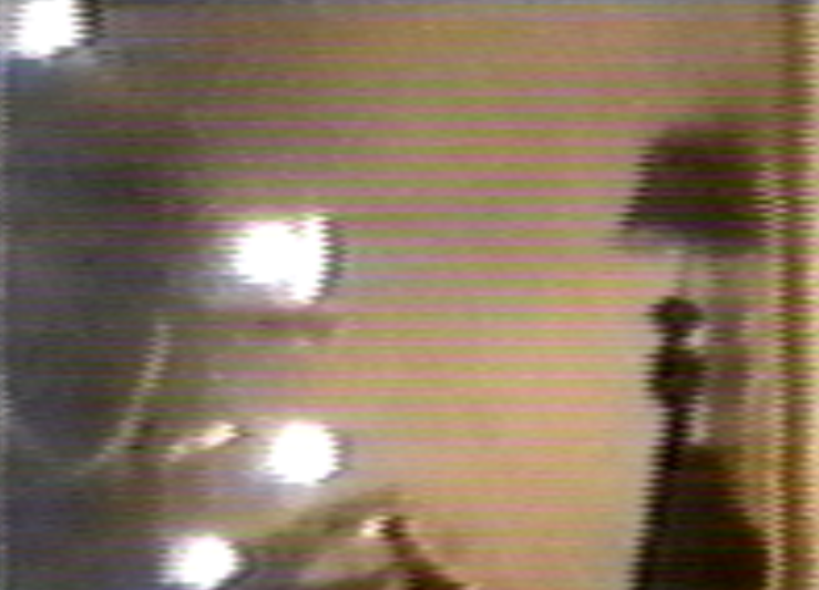

    I'm trying to capture a few old PAL VHS tapes with a Panasonic NV-FS200, but I've encountered some issues. First I used a Diamond VC500 which worked fine, but on one tape there was some severe flickering in a few parts. Since it was not happening when watching on TV I decided to get a I-O Data GV USB2 hoping it could handle this tape. And it did, the flickering is not entirely gone, but way better and watchable. Unfortunately with this capture device I now have horizontal green and redish lines in every VHS tape I tried, very old and newer ones. It's better after converting and deinterlacing, but still visible.
    I did some googling and read about hanover bars and how to remove or mitigate it (not yet enough to understand how to do it), but since this is happening on every tape and with the same intensity I am wondering if this could be a hardware issue. Switching TBC on or off doesn't change anything and neither does switching the S-Video cable or using a Scart to S-Video Output adapter instead of the normal S-Video out on my VCR. Again, when watching on TV or using the VC500 this issue is not visible at all.
    (raw)
    [Attachment 81638 - Click to enlarge]
    (converted)
    [Attachment 81640 - Click to enlarge]
    (VC500)
    [Attachment 81642 - Click to enlarge]
    Not sure how to go from here. Appreciate any help.
    Thanks!

    Easy fix, you need a external stabiliser/TBC of some description. At the cheaper end of the scale, the Panasonic "Diga" DVD recorders will stabilise that video so there will be no jumps and flashes. I've put some examples on my website here. I suspect it would probably clear up those colour errors too.

    Thanks a lot for your reply!
    I looked a bit for those models from your website, but only found a E55 for about 20$ in my area. At least according to your video it seems to be performing noticeably worse than the others, but I don't really want to have those old things shipped from other countries. So not sure if that would do. I also found a Panasonic DMR EH52 for about 60$ if that's any better. It seems to have a TBC, but not sure how good it is.
    Also I thought about the easiest and cheapest way to go would be to just record my Problem-VHS in 3 parts. First and third part which have no flicker problems with my VC500 and the middle part with the GV-USB2 and somehow stitch those files together as lossless as possible.
    Lastly, just out of curiosity. What could be the technical reason for those chroma lines only to appear on the GV-USB2 on every single tape, but not at all on the VC500 or my TV?

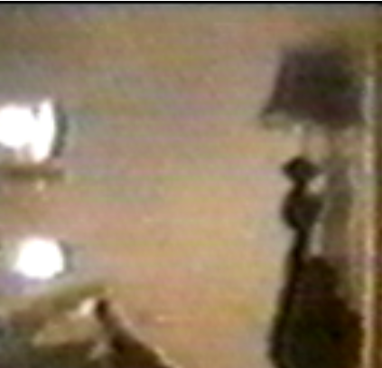

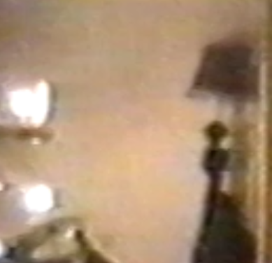

    I managed to get started with AviSynth thanks to your website and indeed with Jagabo's script (thanks!) seems to get rid of those lines. I also tried your QTGMC example and while it gets rid of those lines it introduces some red and green flickering on the top. Alternates with every frame:
    [Attachment 81678 - Click to enlarge]
    [Attachment 81679 - Click to enlarge]
    This whole thing is quite the rabbit hole. I also realized that the GV-USB2 footage seems to be a bit wobbly. The straight doorframe next to the lamp in this picture is more not as straight as in the VC500 footage. So another thing to consider
