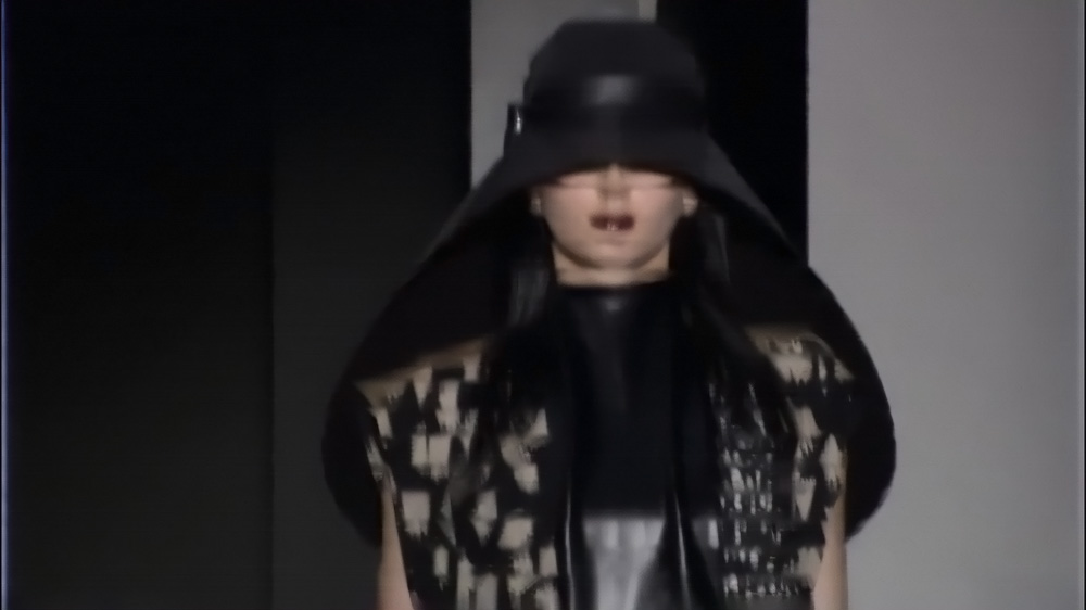

  1. Hello, I have a 10 minute full show in HD quality, which is in great state. But then, not sure how did production company let this slip in, but there is 2 sec scene where they incorrectly deinterlaced video without properly debanding the fields.
    It is a stretch, but since rest of the video is in great quality, would there be a way to fix this 2 second scene, please? At least partially? I was thinking maybe to first downsize and then deband/deflicker might help?
    Thank you.

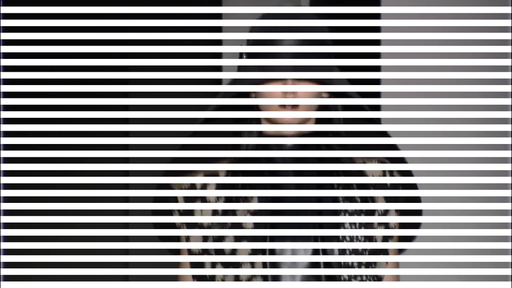

  2. Sorry, this is not a solution to the problem!
    Just something I thought I try since I was wondering what it would do if I applied a motion masked BasicVSR++ two times in a row on such content. (script: https://pastebin.com/qZYX0W3Y)
    On some frames, this does really seem to help, but for some it makes is worse and doesn't do much for others.
    Just thought I share the result, so others know that it does not really work.
    Cu Selur
    Ps.: in my book this has nothing to do with banding, but not deinterlacing and then cropping and resizing while not taking into account that the source was interlaced,...

  5. also did a quick test of compresing heights and converting the band of twelve rows into one and run it through QTGMC. It properly gave me what original debanded video looked like (deband1.mp4), but of course as I compressed 12 rows into 1, i lost too much video information and the video is very blurry now.
    I realized that the scene actually has only 61 frames, so maybe over the weekend, i could fix individual frames in photoshop using the magic tool. I try to avoid doing that but having only 61 frames, this could take about an hour or even less.

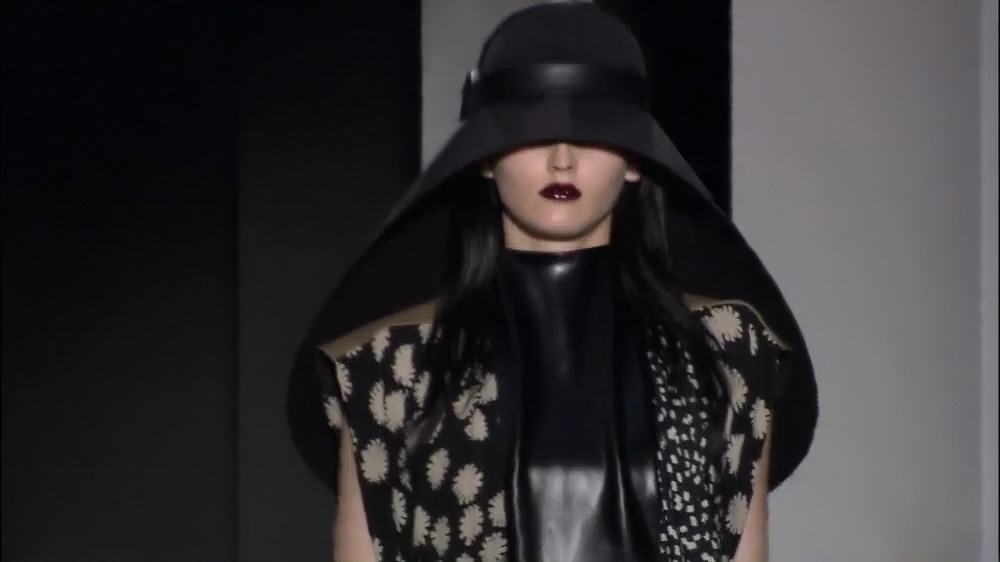

    you actually helped me tremendously and guided me the right way. Over the weekend, I added white areas over the debanded frames:
    [Attachment 81588 - Click to enlarge]
    then I did batch script and used content aware fill in Photoshop which fixed the rigged edges in most scenes.
    [Attachment 81589 - Click to enlarge]
    Then I overlapped the content aware fill over original image and kept areas that worked well from each frame. If neighboring frame had better details, i copied them over and blended them in (stretched, liquified, rotated). For remaining stuff, i used paint brush to fix stuff where needed
    [Attachment 81590 - Click to enlarge]
    i did it all for 61 frames and I think i got most of the debanding gone (attached video). After interpolating, It looks very well. I can clean up some details in couple frames that could be better. But overall, I am very happy that this was fixable and bad interpolation is gone! Thank you for your help! I would have never gotten here without you! Plus, I learnt a new script!
