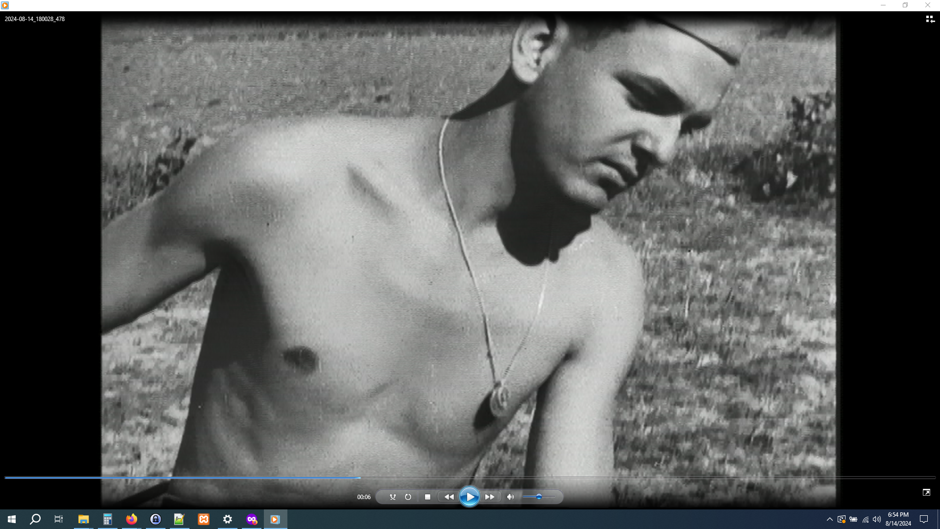

    I'm capturing analog videotapes to my computer via a firewire connection and using the software Amcap to capture in Uncompressed AVI. The capture happens successfully but when the video is played back, you can clearly see jagged edges on playback (see attached example). Here are specs
    VCR - Sony UVW-1800 Betacam SP player. Video output - S-Video, Audio Output - RCA
    Firewire bridge - Sony Digital8 Handycam. The S-Video cable is plugged in the S-Video input on the camcorder, the audio cable that came with the camcorder is plugged in and using female-to-female RCA adapters I connected the RCA cables from the VCR to the RCA cables into the camcorder. A firewire cable is plugged from the camcorder to a firewire PCMCIA card on my laptop. The setting on the camcorder A/V>DV is turned on so the analog video flows from the camcorder to the computer.
    Capture software - AMCap 9.23 (capture setting attached)

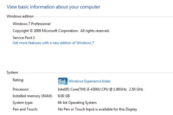

    Computer Information - see attached
    I'm at my wit's end. This is for a client who walked away a year ago and didn't start reviewing the files until a few weeks and now she's not happy because of the jaggedness of the videos so here are my questions
    1. Is there another way I can capture uncompressed AVI that will not produce the jaggedness?
    2. Is there a software where I can re-encode the existing files to remove the jaggedness?
    I originally told my client the jaggedness is basically caused by aliasing, the fact it's uncompressed (see Mediainfo specs - 166 Mbits/s) and any playback (no matter how fast the computer) will play jittery and you will see the jaggedness because of the interlacing. Am I correct?
    If I can't resolve this, I will have to refund the money which was quite a bit and will hurt my financial situation at the moment. I'm so frustrated.

  2. I suggest you to provide a short sample of the captured video, use avidemux/losslesscut or similar tools to avoid trascoding

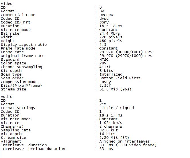

    Get a mediainfo report of the captured file, text view, and post the info here
    Normally DV content, via the camera/Firewire, should be captured with WinDV. It's really a data transfer, the output from the
    camera should be captured as-is.

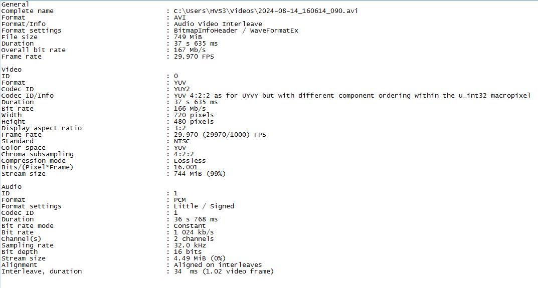

    I'm uploading video now. It's taking time. It's only 37 seconds but 767 MB in size.
    Davexnet, I did attach the mediainfo details. See original post. I saved it as a text file and that's why you don't see a picture.
    Aug 2024
    Tampa, FL
    I see the problem. AVI uploads are limited to 477.3 mb. Let me do a re-capture of a smaller file. Standby
    Meanwhile here's a JPG of the mediainfo data.

    Also the video is interlaced, deinterlacing it clears the jaggies
    Seems that it's sourced from film so IVTC looks OK

    The WinDV software gave me the same results that my normal capture software Window Movie Maker and it's fine for 99.99% of my customers but this particular customer wants the uncompressed AVI with no jaggedness. Anyway, attached is the mediainfo data from the WinDV test.
    Clearly you can see 24.4 Mb/s and Compression Mode: Lossy. If she sees both these stats, it will not be acceptable.
    Also, why does it capture audio at 32 kHz instead of 48 Khz?

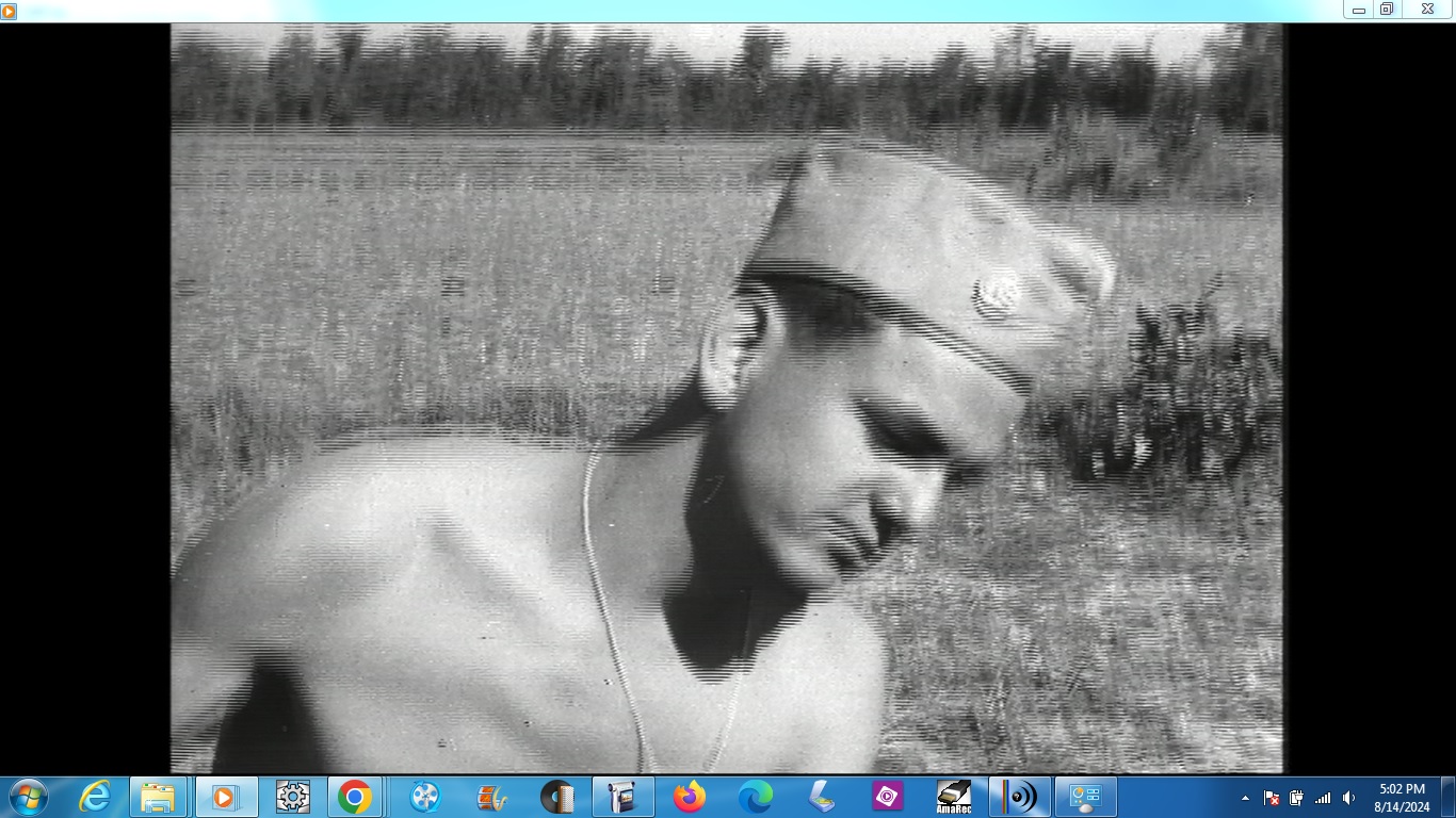

    The capture device in this setup is the camcorder and it's streaming or transferring DV over firewire. For archival purposes it can't be any better than the DV stream. Uncompressed is just larger video file and potentially introducing issues.
    I checked your video I don't see what you mean. If you are referring to the horizontal lines in the screenshot that is interlacing and can't be removed without degrading the video. It's how analog video meant for TV works. The playback software or device will manage it. Screenshot from Windows media player.

    I don't know about the audio. Is that the source format? The two samples of DV found on my PC were also 32k.
    And DV is lossy, all you're doing is converting the lossy DV to uncompressed - same quality but about 5 times bigger.
    Same as a low bitrate mp3 file, opened in an audio editor and save as Wav/PCM - n times bigger but exact same quality as the
    crappy sounding low bitrate mp3
  15. uncompressed avi is overkill and oversize (factor X2 easily) , the codec huffyuv ( y'crcb 4.2.2) is good enough. If she work on MAC she may want a cross platform lossless codec like UTvideo. VHS, laserdisc, umatic, beta (and more) = interlaced (jagged lines), perfectly normal. Interlacing is a sort of analog temporal compression, best solution they found at the time given the bandwidth restrictions of tv broadcasts.
    The only problem here is the container AVI that do not flag the Field parity properly: on vhs, laserdisc, umatic etc.. it's always top field first (straight out the deck). AVI by default is bottom field first => troubles for some players.
    Did the DV test capture file play properly without "jaggedness"?
    I assume you mean with jaggedness the interlaced combing effect when the video played without de-interlacing.
    Most AVI codecs not support interlacing flagging, so the playback programs not know they must de-interlace when playing back the video.
    But the DV codec supports interlacing flagging.
    Probably because you have (mis)configured your camera audio setup to use 32kHz audio mode?
    Works the same with my D8 camera when capturing using analog-pass through.
    Wikipedia: DV (video format)
    Audio can be stored in either of two forms: 16-bit Linear PCM stereo at 48 kHz sampling rate (768 kbit/s per channel, 1.5 Mbit/s stereo), or four nonlinear 12-bit PCM channels at 32 kHz sampling rate (384 kbit/s per channel, 1.5 Mbit/s for four channels). In addition, the DV specification also supports 16-bit audio at 44.1 kHz (706 kbit/s per channel, 1.4 Mbit/s stereo), the same sampling rate used for CD audio.[11] In practice, the 48 kHz stereo mode is used almost exclusively.
    Also the sample looks like it is missing frames, but i not know the source.
