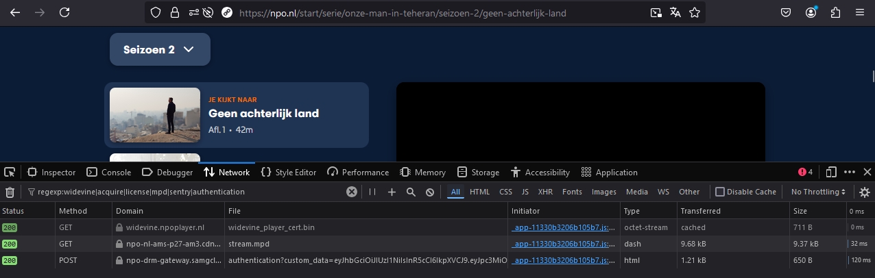

    Looking at this series on NPO.nl, I can perfectly identify the appropriate MPD and license requests for season 2. There is an obvious stream.mpd, and an authentication request for the license:

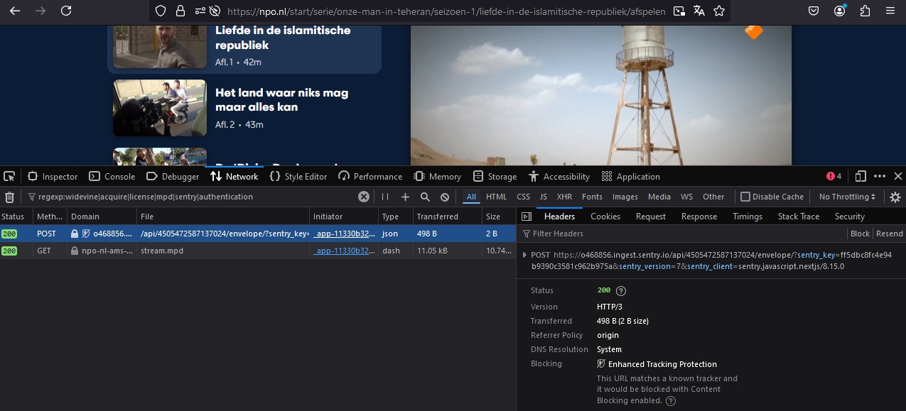

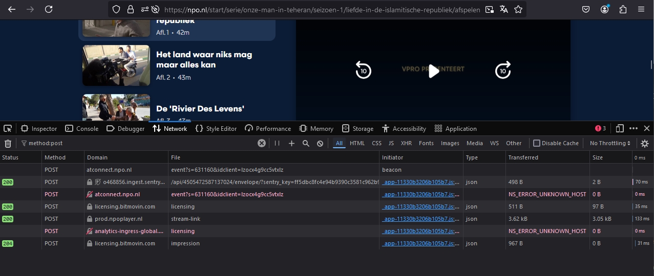

    For season 1, however, the server appears to use a different method. I cannot identify a license. There is one request with a "sentry_key" that looks like it might be relevant, and looking at all POST requests there's a few links that mention "licensing", but I've tried all of their cURLs in allhell3, without any luck.

    Season 1 doesn't use DRM. Thus, no keys to obtain and no license request to get.
