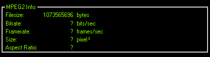

    DVDPatcher... did the job.. without any of the other nonsense... i think the pic may be a little fuzzier than it should be.. (damn it) but the picture is now the right size...and not squished 4:3
    however...one of the vobs (no2) doesn't load in the patcher.. as it doesn't have half the info at the top....
    all the others had full info..
    this file still plays perfectly as a 4:3 and in the dvd.. so just need a way to copy the header info into it from file no3 or no1... if that makes sense..
    Can you please help/anyone else?
