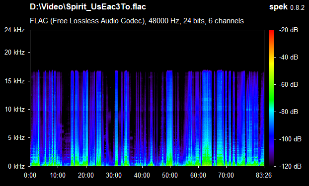

    Hi, I'm new to the forum and I have some questions:
    The movie Spirit (original, not the sequel) was never released on Blu-ray here in Denmark, so in order to bring the best possible version of it to my kids, I'm trying to sync the dubbed DVD (PAL 25fps) audio to the american Blu-ray (NTSC 23.976fps).
    After much trial and error in both Audacity and with different FFmpeg scripts, I tried both MeGUI and UsEac3to, and while they both seem to produce the same, correct pitch (when listened to) and the exact same length on the files, their spectrograms looks vastly different (I'm using Spek to view them), and I'm not sure which file is the most correct to use going forward.
    My plan is this: make an MKV from the DVD with MakeMKV, then use gMKVExtractGUI to extract the AC3 from the MKV file, slow it down from 25fps to 23.976fps whilst converting it to a lossless format (I'm currently stuck here), import it into Audacity and line it up with the audio from the Blu-ray, since it starts a bit later than the DVD does (even when the DVD's video is converted from 25fps to 23.976fps), and when done editing, export it as AC3 for compability reasons (my old 5.1 receiver is connected to the TV through Toslink Optical).

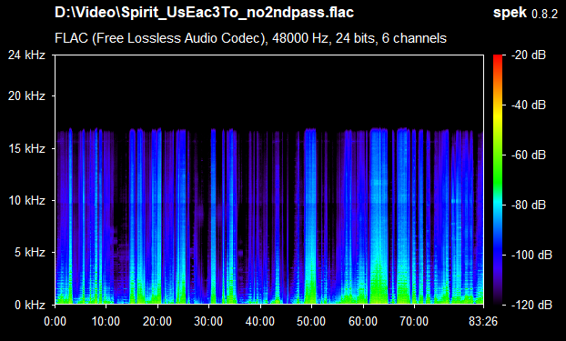

    The reason for the last file, the one ending in "no2ndpass", is UsEac3to said it was clipping and that a second pass was needed, and when that second pass was run through, the finished product looked vastly different on the spectrogram in comparison to the MeGUI one. I therefore added -no2ndpass in the hopes that it would look more like the original file, but it didn't. I have uploaded a gif of the different spectrograms here:

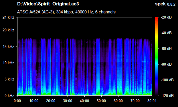

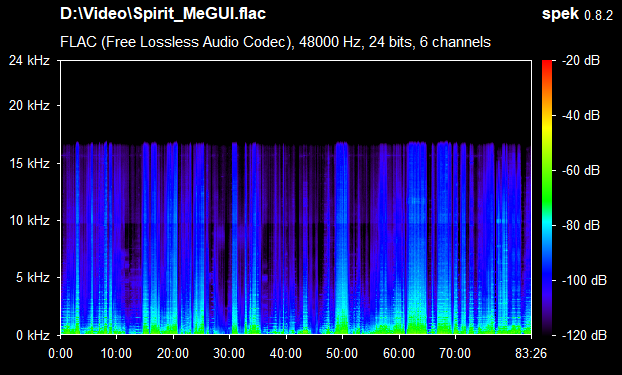

    [Attachment 81308 - Click to enlarge]
    If the gif is moving too fast, here are the images of the spectrograms, one by one:

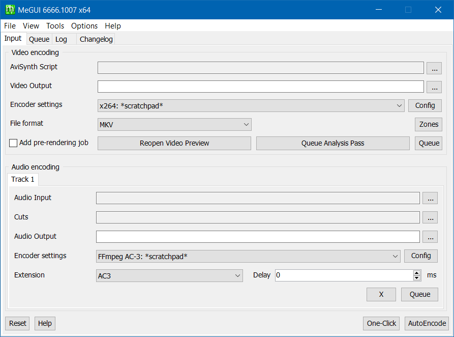

    Here is the log for MeGUI (6666.1007):

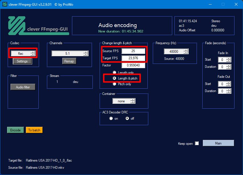

    You could use the easy way to get your lossless (23.976 fps length) flac audio.
    Use clever FFmpeg-GUI, load the mkv (from your DVD, ripped with MakeMKV), click main, click encode audiostream, set the ac3 stream, click go to the encoder.
    Then set all like in the picture below.
    Click encode. Done.
    [Attachment 81330 - Click to enlarge]

  3. There's probably several reasons why the spectrograms could look a bit different, although if they sound the same I wouldn't worry too much. Resampling isn't an exact science and no two resamplers will produce identical results. As far as I know MeGUI and eac3to both use SSRC for resampling audio though, and it looks like they both appear to be using SSRC's fast mode. Some differences....
    MeGUI would be decoding the audio as 32 bit floating point. eac3to appears to decode it as 64 bit floating point.
    There's a few SSRC options neither of them give you access to such as applying dither, and I don't know if MeGUI and eac3to use the same settings.
    You could do the resampling two different ways in Avisynth. MeGUI did it this way:
    Audio.SSRC(Round(48000.0*1001.0/960.0), fast=true).AssumeSampleRate(48000)
    but this should produce the desired output, although with possibly a slightly different result.
    Audio.AssumeSampleRate(round(48000.0*1001.0/960.0)).SSRC(48000, fast=true)
    I don't know how eac3to does it.
    For the record, MeGUI's audio encoder configuration has an option for normalizing the audio. After the resampling is done, it would run a second pass using Avisynth's Normalize() function. Also for the record, MeGUI's HD Streams Extractor uses eac3to to do the work. You need to click on settings in the top left corner and tick all the boxes as for some inexplicable reason they're mostly unchecked by default. The +Options column then lets you type eac3to arguments manually.

    Thank you for this, while it is much easier to use that GUI than trying to find a compatible FFmpeg script to run, it seems to have given me the exact same output as the script did, and I did not find that to be accurate enough for my use.

    When I look at the Blu-ray track at exactly 0:42:35:680500, this is where I have to go to on the other tracks to find that exact same spot:
    Audacity 0:42:35:682710
    clever FFmpeg 0:42:35:678270
    MeGUI 0:42:35:680165
    UsEac3to 0:42:35:680165
    And when I look at the Blu-ray track at exactly 1:23:13:053435, this is where I have to go to on the other tracks to find that exact same spot:
    Audacity 1:23:13:057605
    clever FFmpeg 1:23:13:048935
    MeGUI 1:23:13:052625
    UsEac3to 1:23:13:052625
    While Audacity and FFmpeg fluctuate between 2,2ms and 4,5ms difference from the Blu-ray, MeGUI and UsEac3to only has a difference of 0,3ms to 0,8ms in comparison to the Blu-ray. It's not going to be noticeable when viewing the video with only one audio playing at a time, but I'll always know, and that's enough for me to only focus on MeGUI and UsEac3to.

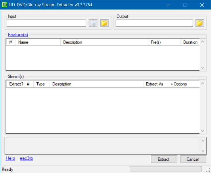

    Where did you get your MeGUI's HD Streams Extractor? I originally used MeGUI (6666.1007) taken from here: https://www.videohelp.com/software/MeGUI and it looks like this:
    [Attachment 81351 - Click to enlarge]
    I googled MeGUI HD-DVD/Blu-ray Streams Extractor and found this: https://www.videohelp.com/software/HD-DVD-Blu-Ray-Stream-Extractor
    And while the oldest version availible on that link looks a lot closer to the one you have, it does not have the "Settings" button:
    [Attachment 81352 - Click to enlarge]

  5. MeGUI's HD Streams Extractor can be found under the Tools menu. As far as I know it was based on the original stand-alone version you linked to, but the stand-alone version hasn't been actively developed for a long time.
    The difference between the two ways of resampling in Avisynth I mentioned is simply the order it's done in.
    From MeGUI's log file, the SSRC resampler was used to resample the audio at a sample rate of 50050Hz. After the resampling, the duration and pitch should be identical, but instead of there being 48000 samples per second there's 50050. Then AssumeSampleRate was used to slow the rate of playback down to 48000Hz again.
    SSRC(Round(48000.0*1001.0/960.0), fast=true) # resampled at 50050Hz
    And if you do the math:
    25 / 23.976
    or to be as accurate as possible
    25 / (24000 / 1001) = 1.04270833333
    and
    50050 / 48000 = 1.04270833333
    It's possible to do it the other way around by first slowing it down and then resampling it, but sorry... the second example I offered earlier was incorrect and should have been:
    AssumeSampleRate(round(48000.0*960.0/1001.0)).SSRC(48000, fast=true)
    Although now I'm doing the math I've realized it'd be less accurate as the audio would be slowed down to 46033.966034 samples per second, which would need to be rounded to 46034 samples per second before it's resampled again at 48000Hz, and
    48000 / 46034 = 1.04202848211
    so for this particular conversion the order in which MeGUI did it was the better choice.
    For a conversion between integer frame rates such as from 25fps to 24fps it shouldn't matter which order it's done in, in respect to the accuracy of the duration, as there'd be no rounding involved either way.
    48000 * 1000 / 960 = 50000
    48000 * 960 / 1000 = 46080
    The result might be slightly different though in respect to how it's resampled.
    So sorry... for a 25fps to 23.967fps conversion it appears there's really only one order it should be done in and everything else I've mentioned so far is irrelevant.
    I honestly wouldn't be worried about it too much, but I'm happy to help with the basics of Avisynth when I can, although no doubt others will be willing to help.
