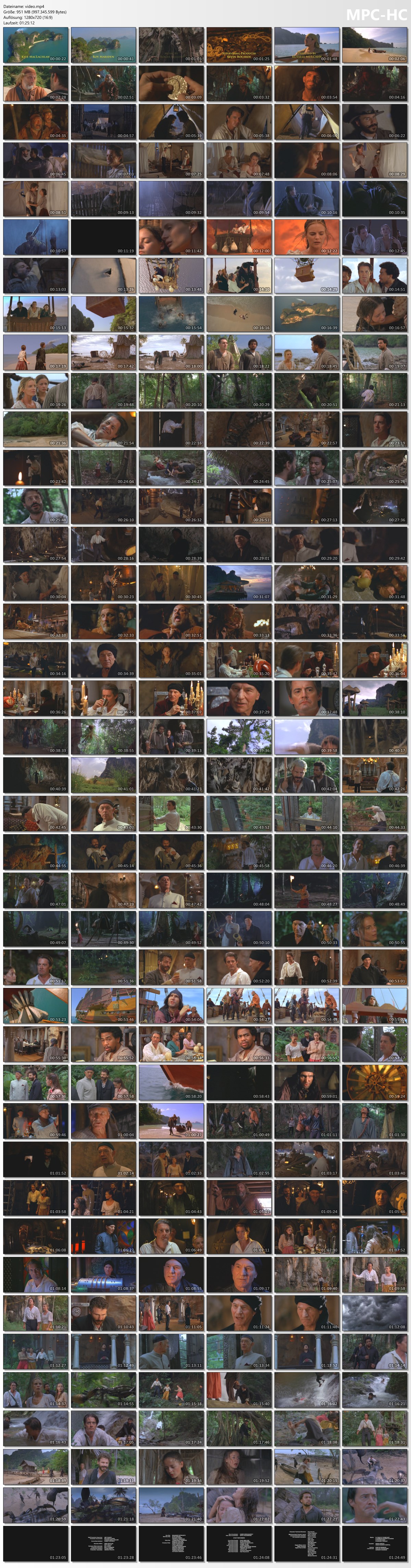

[Attachment 81280 - Click to enlarge] -
@Germainia was that using the key and mpd ? i get lots of errors with N_m3u8DL-RE complaining about the audio and sync issues then when completed i can see the first minute or so of the adverts and nothing else
Can confirm. Something's wrong. I ran using your info for 1080p option
