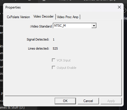

    My mistake, I'm using OBS but I tried VirtualDub and just now AmaRecTV with the same results. I don't think it's the capture software that's the problem.
    Looking at the "Properties" window for the VC500 it tells me it has a signal.
    Attached the image.

    An update: I messed around with the VC500 on my laptop with Windows 10 and it's outputting video! That is when I use EzGrabber. When I try to use that source in OBS it doesn't work. Any ideas?
    Aug 2024
    England, UK
    Another update: Following a guide on how-to I've got OBS capturing video. I think the audio problems are from the RCA cable I got, it's cheap and not wired up properly. That said, I think this thread can be considered closed.
