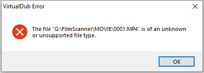

    I have several 8mm films I have digitized that have quite a bit of jitter. I'm totally new to video editing and know absolutely nothing about codecs, plugins or filters. I've read that virtualdub is good for removing the jitter. I have the program installed but have not had any luck copying any .vpf files into the plugins folder. All my video files are mp4 and it will not open any of them. Any suggestions on how I need to proceed?

    Try VirtualDub2. That will be able to open your MP4s. The VDFs do work; however they've got to go into the correct plugins folder (32bit or 64bit) and you have to run the same 32bit or 64bit instance of VDub. What's the name of the VDF you're trying to load? We can tell you what bitness it is.
    If you intend exporting out of VDub2 for the final version of your files, it's best to use the latest x264 codec, which is available in this post.
    I would also suggest you attach a short sample of a jittery file so the experts can cast their eyes over it. We have 8mm specialists and AVISynth whizzes who will most probably come up with a better solution that VDub.
