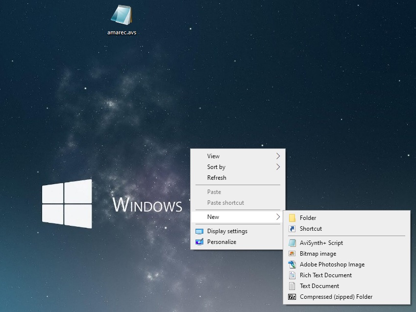

    Mar 2008
    Here are some plugins to get you started with Avisynth, copy them into C:\Program Files (x86)\AviSynth+\plugins64 once it's installed.
    This will enable you to use the 64 bit version of vdub2 with the script we discussed, including qtgmc
