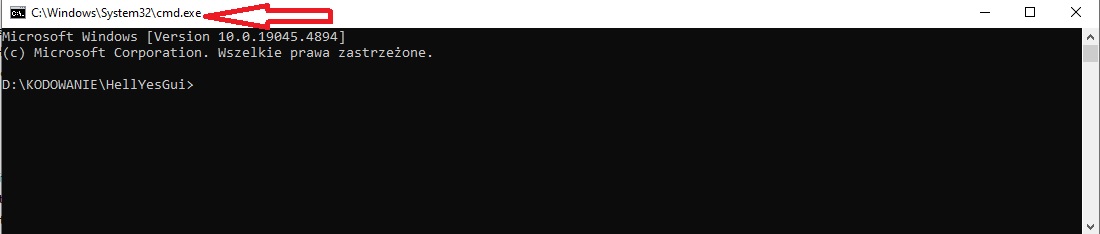

    Getting an error on windows, after pressing - download video:
    \Desktop\M3U\HellYesGui>allhell3gui.py
      File "C:\Users\...\Desktop\M3U\HellYesGui\allhell3gui.py", line 34, in run
        subprocess.run(self.command, check=True)
      File "C:\Users\...\AppData\Local\Programs\Python\Python312\Lib\subprocess.py", line 548, in run
        with Popen(*popenargs, **kwargs) as process:
      File "C:\Users\...\AppData\Local\Programs\Python\Python312\Lib\subprocess.py", line 1026, in __init__
        self._execute_child(args, executable, preexec_fn, close_fds,
      File "C:\Users\...\AppData\Local\Programs\Python\Python312\Lib\subprocess.py", line 1538, in _execute_child
        hp, ht, pid, tid = _winapi.CreateProcess(executable, args,
    FileNotFoundError: [WinError 2] The system cannot find the file specified
  2. I'd say, the command "N_m3u8DL-RE" wasn't found. You followed the guide that Angela prepared for you (and all other users)?
    It specifically says:
    Install the following:
    * See the code at https://github.com/nilaoda/N_m3u8DL-RE, download the latest release. Unzip and save to a folder named 'binaries'. It can be anywhere on your system. So long as 'binaries' is in your Path.
    Pay attention to the last sentence: "So long as [before mentioned] 'binaries' is in your Path."

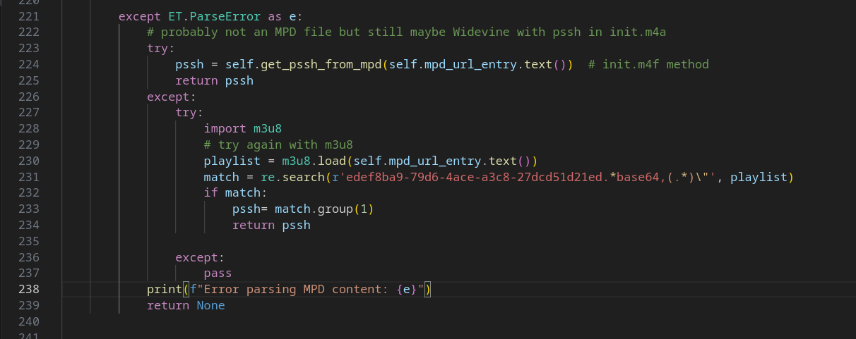

    @senkron24 here is my take on what you are trying to do
    [Attachment 82427 - Click to enlarge]
    add code lines 227 - 237 inclusive in allhell3gui.py
    try:
        import m3u8
        # try again with m3u8
        playlist = m3u8.load(self.mpd_url_entry.text())
        match = re.search(r'edef8ba9-79d6-4ace-a3c8-27dcd51d21ed.*base64,(.*)\"', playlist)
        if match:
            pssh= match.group(1)
            return pssh
    except:
       pass
    Let me know how it goes: there are no widevine m3u8 in my orbit to test on.
    If ever that code makes it to a release I will not be publicising any facility with m3u8. I do wish to be associated in any way with 'm3u8 support' for the masses.

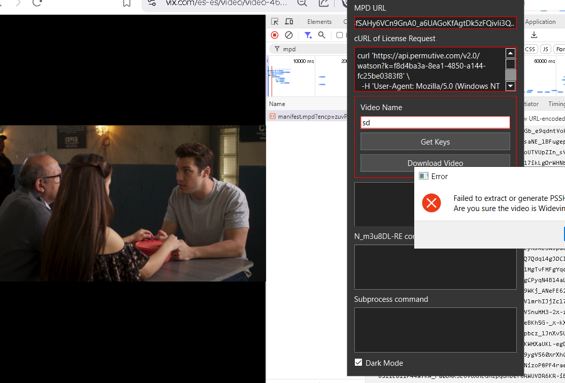

    I have tried to use it in vix without success,
    Mexican VPN may be necessary
    url
    https://vix.com/es-es/video/video-4601833
    mpd
    https://dcs-vod.mp.lura.live/vod/p/session/manifest.mpd?i=i176979974-ne272ca89-569a-4521-91f6-66f5a3295a11&guid=56867C7F-596A-AB2C-AF5A-042C6CC343FA

    [Attachment 83413 - Click to enlarge]
    could you give me a hand?
    Aug 2023
    Turkey
    url
    mpd
    cURL
    curl 'https://api.permutive.com/v2.0/watson?k=f8d4ba3a-8ea1-4850-a144-fc25be0383f8' \
      -H 'User-Agent: Mozilla/5.0 (Windows NT 10.0; Win64; x64) AppleWebKit/537.36 (KHTML, like Gecko) Chrome/131.0.0.0 Safari/537.36' \
      -H 'content-type: text/plain' \
      -H 'Referer;' \
      --data-raw '{"url":"https://vix.com/es-es/ondemandplus","classify":true}'

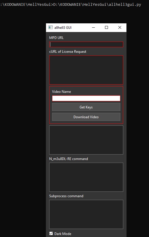

    [Attachment 83690 - Click to enlarge]
    then execute allhell3gui.py and you should see your gui:
    [Attachment 83691 - Click to enlarge]
  30. Originally Posted by grzech67 View Post
    Create a new folder "HellYesGui" and move all files related to HellYesGui there and then run the cmd command in this folder, as in the picture:
    And the entire HellYesGui folder is supposed to be in the python folder???
