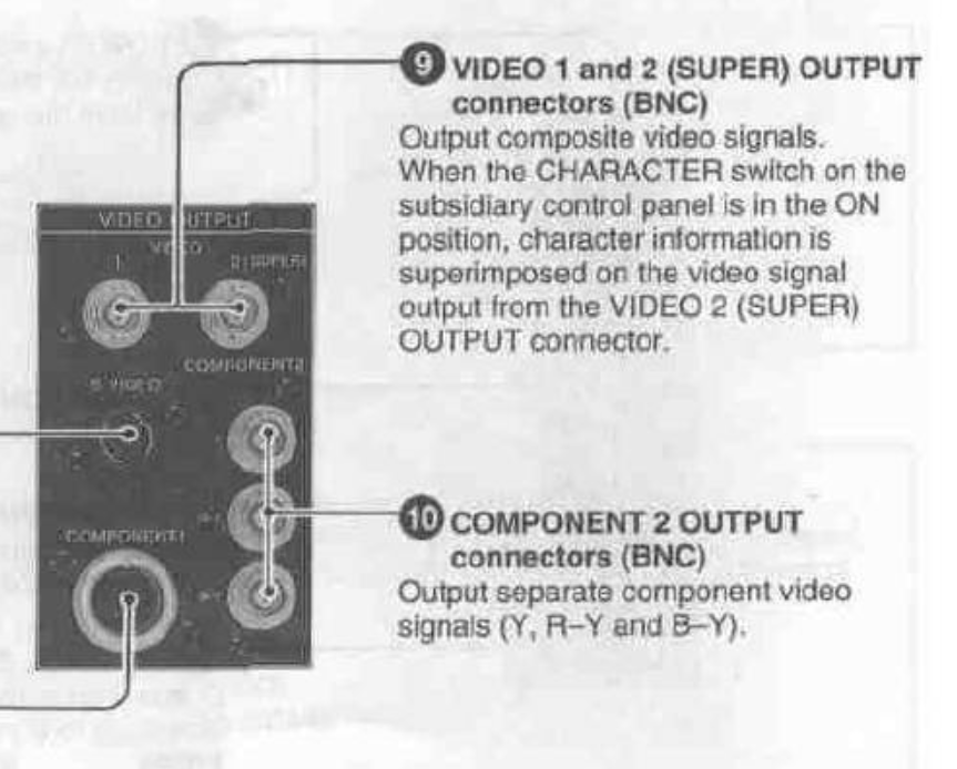

    Connect as shown in the picture below, make sure the switch is in the right position as explained in 9 paragraph:

    I followed the manual for that set up. I know it’s the menu because I can sort of see the white menu text. I’ll add a video.
