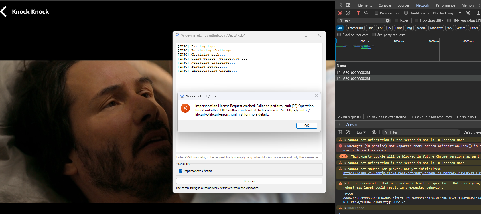

  2. when i try widevine fetch on homeofhorror german streaming , on licence request it goes to a token file. when i try "fetch" it come later an error.
    in mpd file widewine is the protection.
  3. what kind of error is it?

  4. i add a picture , when i write the token url it download a file.
    on other joyn or rtl no problems works like a charm.

  5. Does unchecking "Impersonate chrome" help? Did you copy the correct request?

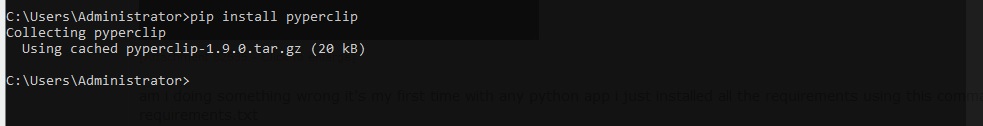

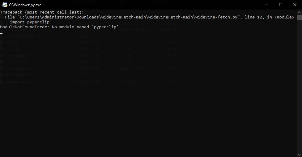

    am i doing something wrong it's my first time with any python app i just installed all the requirements using this command pip install -r requirements.txt
    Python 3.12.7
  20. from requirements.txt is present ...
    however run 'pip install pyperclip' (at the moment missing module)
  21. Originally Posted by lomero View Post

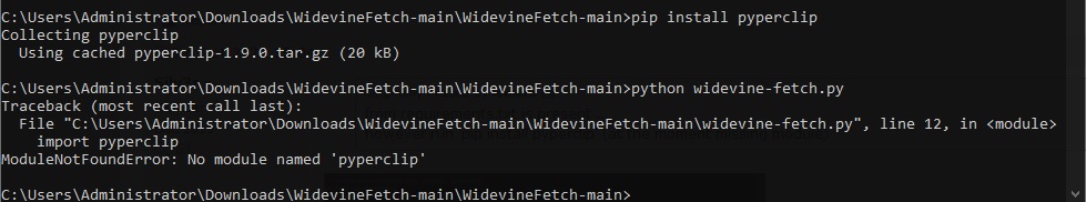

    [Attachment 82636 - Click to enlarge]
    [Attachment 82638 - Click to enlarge]
    already did that still the same error am i doing something wrong?
  22. I will look at @damon's issue soon
    @Silv3r
    Try
    python -m pip install -r requirements.txt
    Bypass HMACs, One-time-tokens and Lic.Wrapping: https://github.com/DevLARLEY/WidevineProxy2
