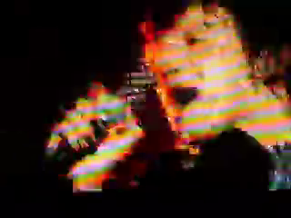

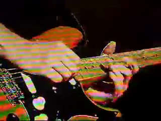

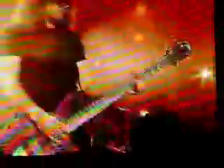

  1. I have this old video taken from YouTube with a series of huge artifacts + low resolution, I do not expect miracles because the state of the video is bad, however, is it possible to clean rainbow artifacts?, blocking, etc., etc. as far as possible?
    [Attachment 81039 - Click to enlarge]
    [Attachment 81040 - Click to enlarge]
    [Attachment 81041 - Click to enlarge]

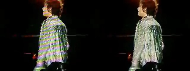

  3. I concentrated mostly on reducing the chroma stripes:
    [Attachment 81067 - Click to enlarge]
    First 1100 frames, before/after:

  5. Originally Posted by jagabo View Post
    Overall it's a fantastic rainbow removal result, what did you use jagabo?
  6. I used AviSynth:
    # build a mask of areas where there are
    # alternating horizontal lines
    function CombMask(clip v, int "threshold")
        threshold = default(threshold, 5)
        Subtract(v, v.blur(0.0, 1.0).Sharpen(0.0, 0.6))
        GeneralConvolution(0, "
            0  8  8  8  0
           -0 -8 -8 -8 -0
            0  8  8  8  0
           -0 -8 -8 -8 -0
            0  8  8  8  0", chroma=false, alpha=false)
        mt_lut("x 126 - abs")
        mt_binarize(threshold) # threshold
        mt_inpand()
        mt_expand()
        mt_expand(chroma="-128")
    LWLibavVideoSource("test video.mp4", cache=false, prefer_hw=2)
    src = last  # remember the source
    cmasku = Spline36Resize(width, 80).Tweak(sat=3).UtoY().CombMask(8).mt_expand().Blur(1.0).BilinearResize(width,height) # mask of stripes in U channel
    cmaskv = Spline36Resize(width, 80).Tweak(sat=3).VtoY().CombMask(8).mt_expand().Blur(1.0).BilinearResize(width,height) # mask of stripes in V channel
    cmask = Overlay(cmasku, cmaskv, mode="add").GreyScale() # add the two masks together
    bc = MergeChroma(last, Spline36Resize(width, 24).Spline36Resize(width,height))  # a vertically blurred version of the chroma (reduced color stripes)
    Overlay(src, bc, mask=cmask) # overlay the blurred color only where the color stripes were
    SMDegrain(tr=2, thsad=1000, PreFilter=6) # temporal noise reduction
    aWarpSharp2(depth=5) # a little warp sharpening
    Sharpen(0.3) # a little overall sharpening

  8. if it's just the rainbows,...
    try MiniDeen with high thresholds and radius for chroma,..
    somehing like:
    MiniDeen(clip=clip, radius=[1,7,7], threshold=[10,100,100])
    in Vapoursynth should translate to:
    MiniDeen(radiusY=1, radiusUV=7, thrY=1, thrUV=100, y=3, u=3, v=3)
    in Avisynth.
    Adjusting the thresholds and may be boosting the saturation after MiniDeen should work fine.
    (image was taken without saturation boost)
    According to https://staxrip.readthedocs.io/generated/tools.html, StaxRip should support MiniDeen.
