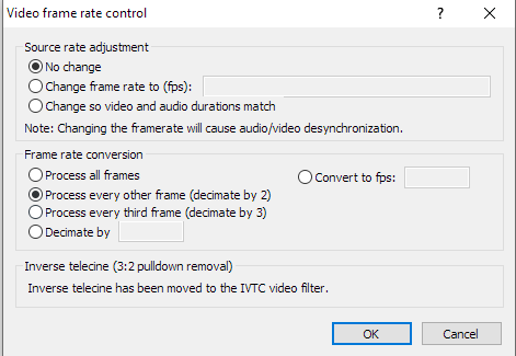

    One final question:
    VirtualDub has a function of changing the frame rate of a file, allowing to save a new file without encoding it I assume (no bitrate loss). Please see bellow:
    [Attachment 81101 - Click to enlarge]
    By using this method, would I not achieve the goal of eliminating "irrelevant frames" or the Even Frames in my 50fps capture and keep the original capture bitrate and properties? (Lagarith, Color: YUV 4:2:2) Wouldn't this be the closest possible to keeping the original capture for archival purposes without recapturing?
    Or is it possible to use Hybrid, discard the Even Frames but do not encode the file?
  16. Originally Posted by jbl_prof View Post
    Yes, since you're using an all keyframe lossless codec that should work in Video -> Direct Stream Copy mode. I'm not sure if it saves the even numbered frames or the odd numbered frames. But either way should work. Just the field order will be different.
    Note that you are using a lossless codec so even if you decompress and recompress you will not incur any losses (aside from the fact that you're intentionally discarding every other frame). As long as there are no color format conversions in the process (eg, YUV 4:2:2 to YUV 4:2:0 or RGB).
