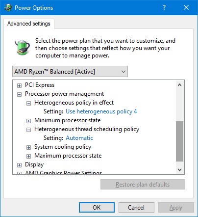

This is more of what I've read about heterogeneous cores, but I'm still confused. What I understood is that I should change something in Processor Power Management in advanced options of the power plan but there are only 3 options and none of them refer to the management of hybrid cores, I guess the other options appear in Windows 11.
The tool to unhide relevant options: https://forums.guru3d.com/threads/windows-power-plan-settings-explorer-utility.416058/ -
This is interesting, now I need to know exactly which options I need to unhide (it have slightly different names) and then know how to configure.
Well, since heterogeneous cores options are not available in Windows 10, I decided to disable E-Cores in the BIOS. Now x264 works while I do other things but I noticed that the CPU usage shoots up to 100% unlike when the E-Cores were active. The good thing is that I previously made other changes in the BIOS such as setting -0.15 Offset and lower TDP values in PL1 and PL2 with the purpose of having somewhat lower temperatures. However, reaching 100% usage shouldn't happe, even when I used x264 with the Core i7-6700 the CPU usage didn't go above 70%.
That's strange, the screenshots I provided are from Win10 20H2 actually, you just have to unhide relevant options. Have you try it as suggested?
https://forum.videohelp.com/threads/415450-x264-slows-down-work-while-I-do-other-things#post2744956 -
In fact, it's 22H2. Sorry but I didn't look at all the options and I thought it wasn't there but I already unhidden them and reverted the changes in the BIOS to try. Following what I read, I set “Heterogeneous policy in effect” to “0” and “Heterogeneous thread scheduling policy” to “Prefer performant processors”. It seems that x264 is still active now and the CPU usage % are as it were before I disabled E-Cores in the BIOS. I also tried with “Performant processors” and the processing power went up a bit more but without reaching 100% usage like when I disabled the E-Cores in the BIOS. Is there anything else I can configure? Considering that I still want to reduce the temperatures that currently reach 80°C.
