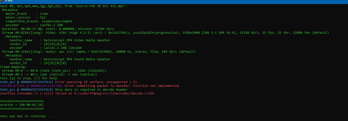

    Thanks for the syntax. I've struggled with it for some time but cannot get it to work if input is not 8 bit 420.
    Using input of 8 bit 420 = using Intel decoding is a fraction slower.
    I'd expect that will reverse with input of 10 bit 422, if I could get it to work.
    Input file of 10 bit 422 causes errors.
    [Attachment 81011 - Click to enlarge]
    This is what I am using ...

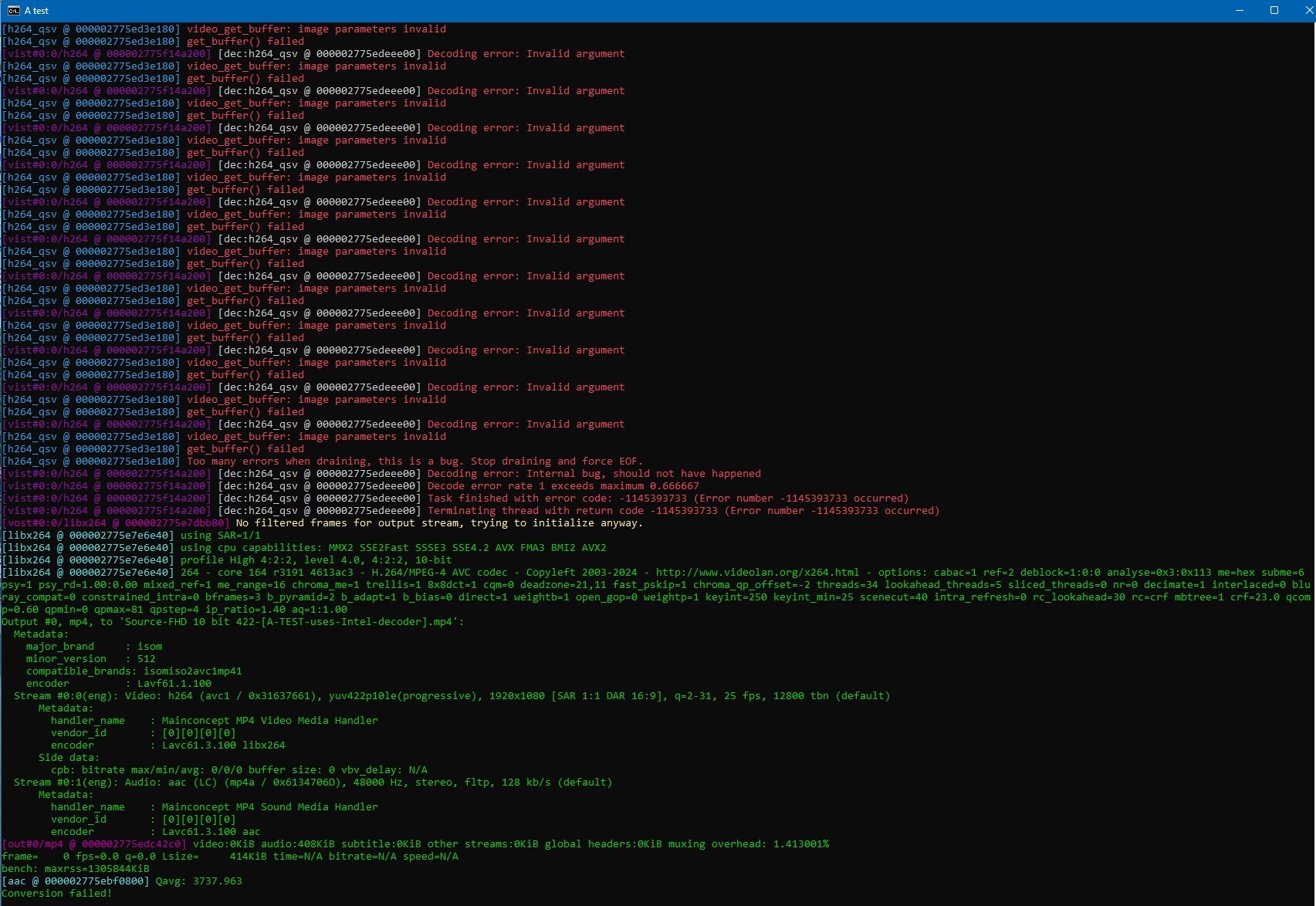

    [Attachment 81019 - Click to enlarge]
    Shortly just arrived, no luck just a more concise error message. I used ffmpeg.exe from November 2023.
    Used ... ffmpeg -y -hide_banner -c:v h264_qsv -i "%~n1%~x1" -c:v libx264 -preset fast -crf 23 "%~n1-[A TEST, uses Intel decoder].mp4"
    Following were h264 files.
    When input is 8 bit 420 above works.
    When input is 8 bit 422 or is
    10 bit 420 or is
    10 bit 422 then above doesn't work.
    Tried one 10 bit 422 hevc file, still errors.

    It was a slight bit slower without above. Maybe that's because the GPU is in a 4x slot and I use a 16 core cpu. So I won't be using that, also it doesn't handle 10 bit 422 input. Leaving the above syntax off allows 10 bit 422 input, for ffmpeg. Surprising since latest intel should handle 10 bit 422. I guess there is something else that I should add in to above?
    I did another test in VP and found that with an h264 input file enabling Intel decoding gave no benefit. However when the input file was hevc there was a nearly 2x render speed improvement. I got a 4x speed improvement previously with a different file.
    So back to square one. I know that enabling the Intel decoder is worth doing if the input files are typically hevc and 10 bit 422.
    As to th OP's query, I don't know how to enable typically one GPU for decoding and another one for encoding using ffmpeg.
