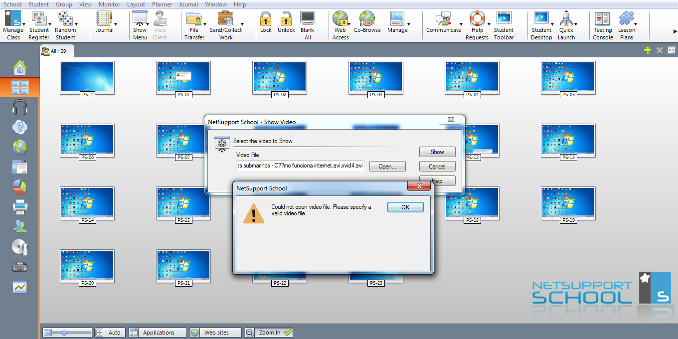

    Thanks for the help. I just took a screenshot of the 2nd video and here is what it says:
    [Attachment 81141 - Click to enlarge]
  12. Try to rename the problem file to something simpler, like latin/digits only
  13. DECEASED
    Jun 2009
    Heaven
    You meant "ASCII characters only". Lousy software like that reminds me of the ancient .DOC viewer from Microsoft itself, the suckware didn't like filenames and folder names with spaces.
    "Programmers are human-shaped machines that transform alcohol into bugs."
  14. Originally Posted by buzz1891 View Post
    Yes it works! Sound good, video is good.

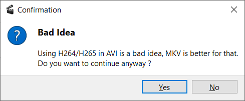

  26. Hello @buzz1891
    Some videos that I open on Avidemux and export using Camtasia 1080p config are not possible to render because of this window dialog:
    [Attachment 82179 - Click to enlarge]
    After clicking No it shows:
    [Attachment 82180 - Click to enlarge]
    I used 1360x768 (3,7MBpm) script you provided.
    For the same video, the other 2 scripts you provided Avidemux success on rendering it. Do you know why that script is failing? How can we fix it? Because I want to export using that script (or with fixes) because it produces lower sized videos.
    Thank you
