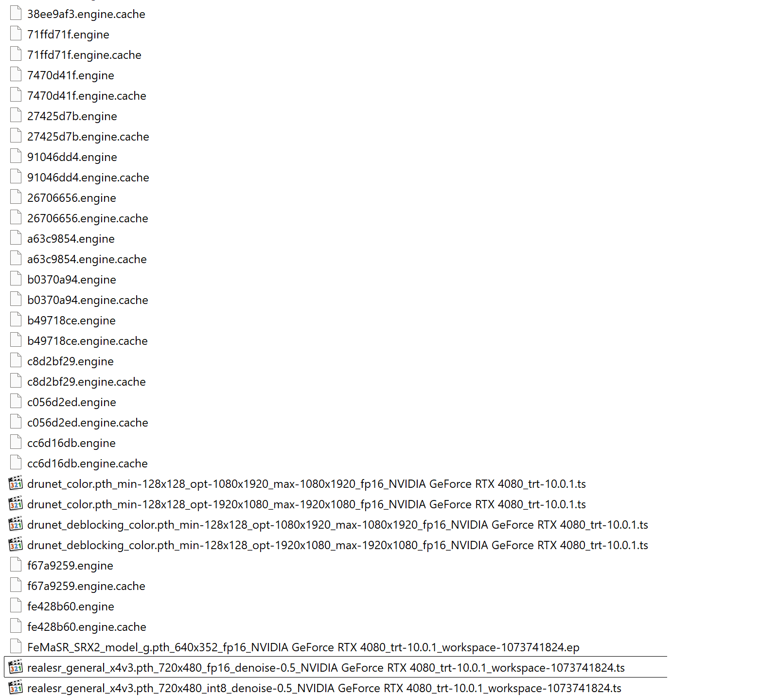

  8. Depending on the setting of the filter and the resolution you feed it with, a new engine file will need to be created when using TRT, depending on your hardware that can take quite a while,...
    Best clear your temp folder and create fresh engine files.
    Jul 2024
    Tacoma, WA
    Dumb question, but how does one "create fresh engine files" and what do the files look like that I should be clearing?
  10. The engine files automatically get created for each filter that uses TRT. (inside the tmp folder)
    Depending on the filter they have one of the following extensions:
    • .ts
    • .engine
    • .engine.cache
    • .ep
    I would recommend:
    a. cleaning the temp folder
    b. not aborting engine&co creations
    Cu Selur
