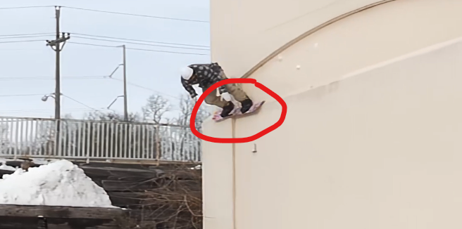

    I am encoding with staxrip/qtgmc progressive settings for progressive input videos, mkv to mp4, and I keep getting this halo/ring around objects (see the snowboarder on the rail top of the image in the example below). Is there a dehalo/dering filter I should use to minimize or eliminate this? staxrip encode log with avisynth script is attached as well.
    [Attachment 80887 - Click to enlarge]
  2. DeHalo_alpha, FineDehalo probably work if you adjust the settings.
    If your source does not have these, better simply don't overdo the sharpening.
    If you hope for folks to suggest some more specific settings, share a sample of your source.

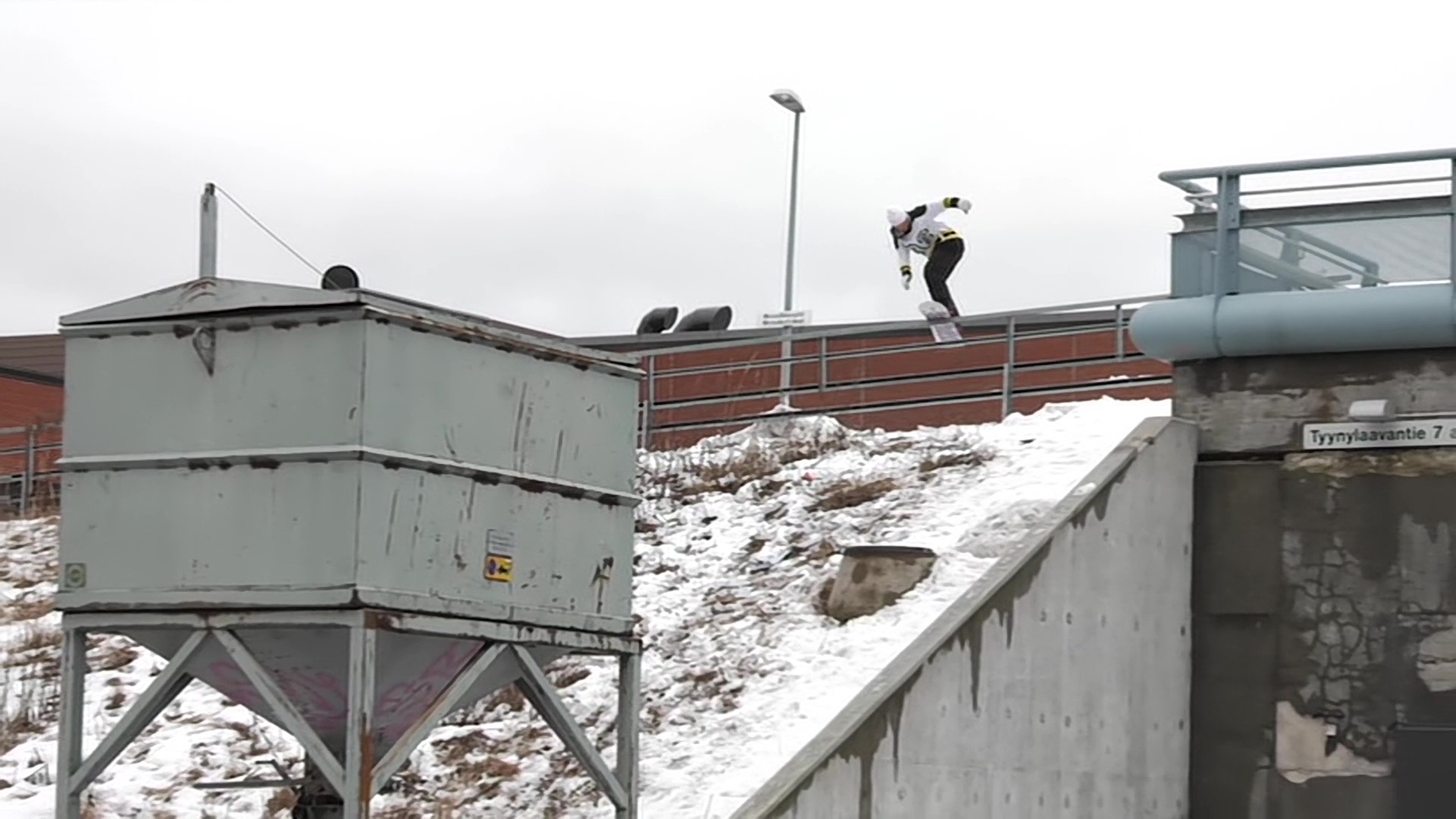

    Source attached.
  4. Is that the source of the source processed by 'regular' qtgmc settings?
    That file was over sharpened, you might have some success by blurring and resharpening.
    => assuming this is not the source, start from the source and do not over-sharpen it blindly

    Ran a bunch of tests with your suggestions and I think I am getting the output I want. The only thing I want to clean up is is blurring effect that is present in films with high motion like this. I ran the same segment through Topaz and cleaned it up using the topaz motion deblur setting (you can see in the pics) but unfortunately it would take me 30+ hours to encode a 35min full video so that's not an option. Looking for recommendations on how to clean up this blurring effect in Hybrid/Staxrip.
Name:	StaxRip blurring.png
Name:	Topaz motion deblur.png

    Shoot sorry, here's the input.
  10. Okay, that source is wrongly flagged as interlaced.
    I would use CAS + DPIR Deblock + DeHalo_alpha as a base: https://imgsli.com/MjgxNjU1

    # resizing using NNEDI3CL
    # current: 720x480 target: 1920x1280 -> pow: 4
    clip = edi_rpow2.nnedi3cl_rpow2(clip=clip, rfactor=4, nsize=3, nns=4) # 2880x1920
    # adjusting resizing
    clip = core.fmtc.resample(clip=clip, w=1920, h=1280, kernel="spline64", interlaced=False, interlacedd=False)# before YUV444P16 after YUV444P16
    => use the "Vapoursynth Script Preview" and adjust the "Filter Order".
    I would also recommend using the Vapoursynth preview before encoding.
    Cu Selur
    Ps.: you might want ot use 'code'-tags to make your posts more readable when posting code.
