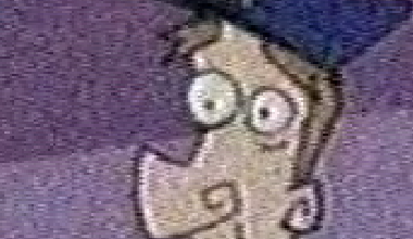

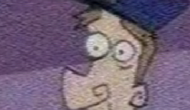

  1. I don't know how useful this is to put here, but i modified the code (very messily, i know ) from https://forum.doom9.org/showthread.php?t=140623 (Thank you, Avisynth_challenged), for VHS haloing/oversharpening reduction, as my VCR doesn't have the ability to adjust sharpness and boosts it like crazy, so this may come handy for someone else as well.
    This code is probably not well optimized, but should work pretty well to reduce the oversharpened appearence of a video without making it look like an oilpainting. Would be good if the dehaloing could be set stronger, but I don't know how to do it, although this already removes it pretty well I believe. In addition, the script also includes BWDIF deinterlacing; can remove dropouts a bit (can be left as is, I think, it shouldn't do damage); and does a little noise reduction that shouldn't destory detail, but needs to be changed or configured depending on the video and your preference. If possible, use NeatVideo and remove the ".HQDN3D().FFT3DFilter(sigma=5)".
    If the halos aren't reduced for you, try adjusting the VSLGhost's "shift", and the "mask.Crop(2, 0, -0, -0).AddBorders(0, 0, 2, 0)"
    Some samples:
    [Attachment 80874 - Click to enlarge]
    [Attachment 80875 - Click to enlarge]
    The code: (outdated, see below)

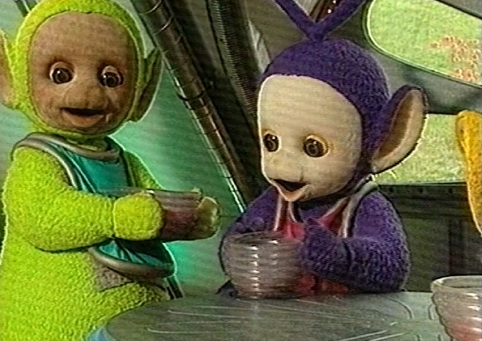

  3. A quick attempt from your original image with downscale, dehalo_alpha, upscale:
    [Attachment 80941 - Click to enlarge]
    Oversharpened, still some artifacts where the strong haloes were. Would have worked better with the original SD video.
